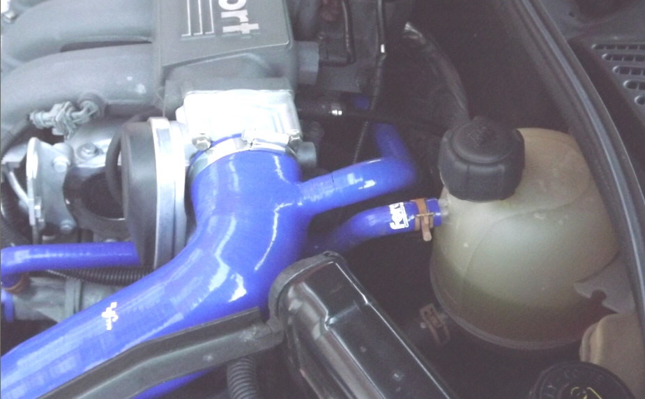

Noticed today that the breather hose coming off the air intake elbow is just flapping around and for the life of me cant find where on the engine to attach it back to..can anyone guide me?

It's right down behind the engine mate . Just pull the pipe down where you see the blue breather hose in this pic and where the hose ends you should be able to feel a small metal tube . Just push it back on . Thanks to whoever's pic it was a nicked ;)

Awesome thanks for that mate. I'll try again tomorrow and see how I get on :)
