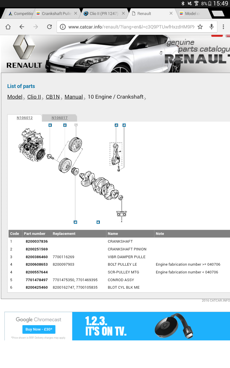

which is the difference between this two bolts?
8200557644 for the 172
8200608653 for the 182
Thas anyone know?
Thanks and regards :)
8200557644 £8.63 and 8200608653 £10.62
I´m not reffering to the price of those one. I would like to know which is the difference. If one is longer to the other one, or the spacer/ring is bigger, thread difference.....
They're both listed for 1*2's from what I've found (see pic below) it all depends on engine number
I would imagine it'll be ok but I don't know for sure, logic would say the crank is the same across the various years but it's something I've never looked into, all I can suggest is have a look and see if your engine number is still visible, it's to the right of the dipstick on a small flat plate
