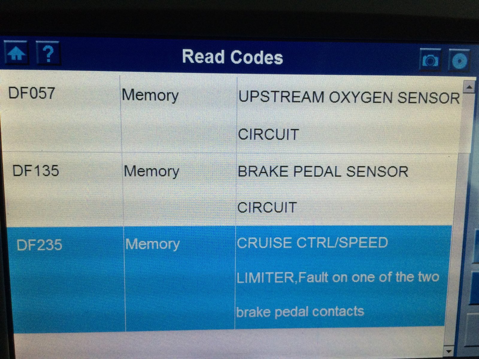

Cruise control not working, light comes on dash but doesn't stay on. It works if hold button in :/ but I found these codes
Is this likely to be the pedal switch or something to do with the actual button.
Thanks

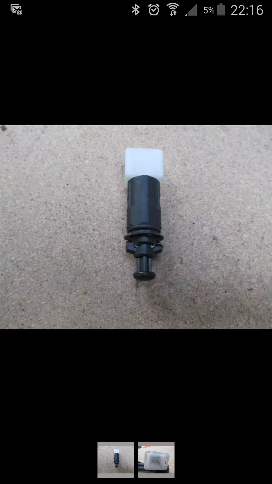

Look behind the pedal towards the top where it pivots and you should see a plastic box with a wiring connector, normally they twist 90° and come out if their housing, swap over with new one and done
It looks just like this

The part at the bottom has a spring inside it and pushes in when you press the pedal. It also has a ratchet mechanism to set the correct distance, as a temporary measure to prove it's the switch pull the bottom but out on the ratchet and then put the switch back in, see if it clears the fault
  182
So pull it out all the way n reconnect if fault goes switch? The button by side of the steering wheel doesn't stay in either haha :(
