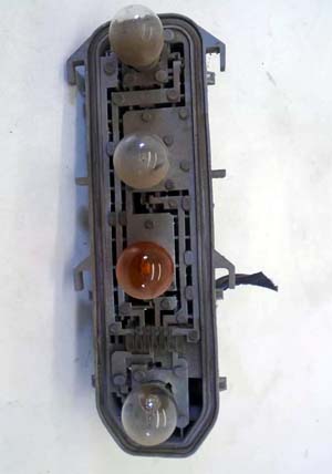

Yes guys, I cleaned connectors etc, but the bulb holder assembly itself doesn't appear to come apart and I think the problem is inside the assembly
Doesn't look like it comes apart - lots of plastic rivets? See pic (stock picture - not mine)

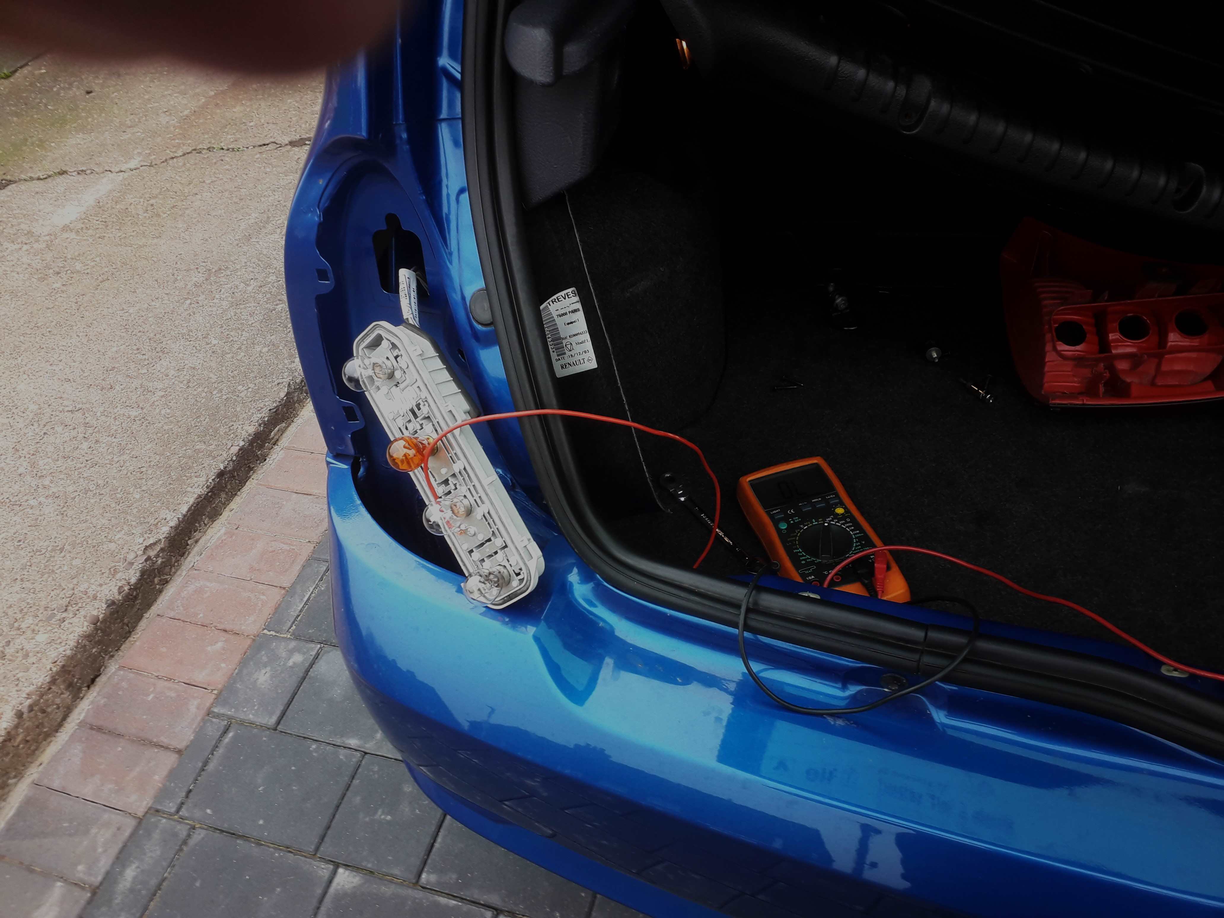

Did another test....
Connected the earth plate of one of the holders directly to the earth point in the boot like so.
The result is that the problem goes away completely, I know I could effect a cure this way, but would rather trace the problem to source.
So I still want to find where the black earth wires from the boot earths go - any ideas??
Incidentally, measured resistance from the earth plate of the bulb holder to earth point changes only 1 ohm with/without additional earth wire , but multi-meters don't pass enough current to test for bad earths.
