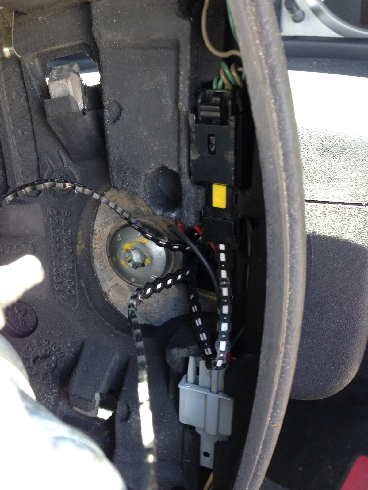

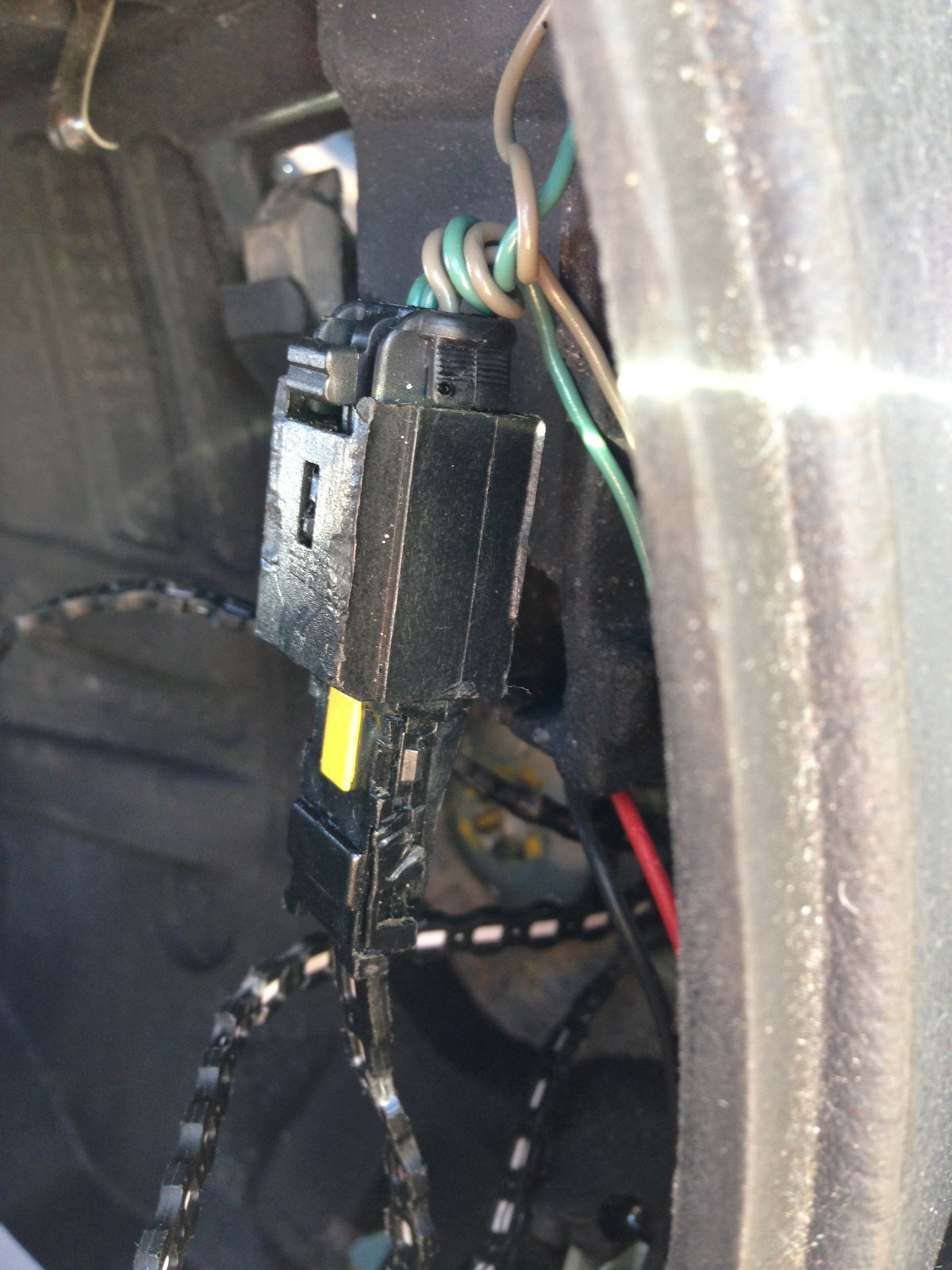

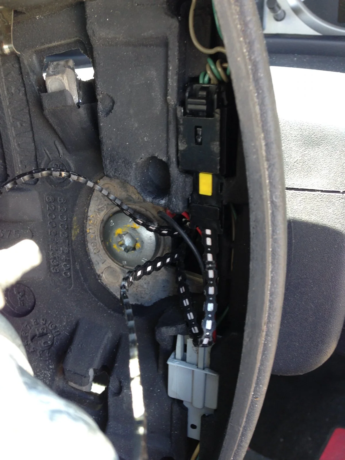

First thing I would suggest is whip the airbag out of steering wheel and see if the black plug to the left is plugged in and the wiring to it looks ok.

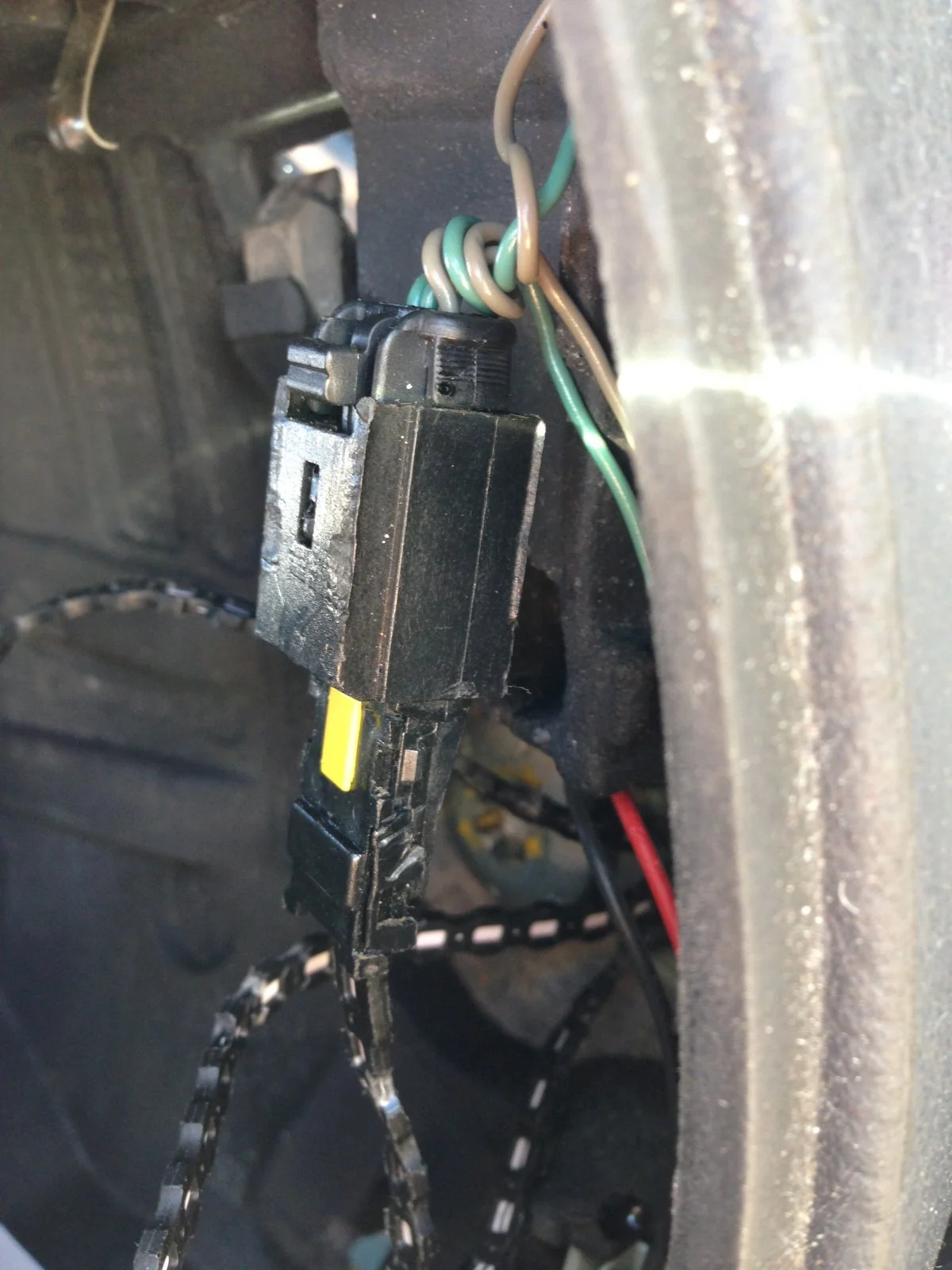

In typically ridiculously delayed fashion I've finally got round to removing the air bag. Black connector is plugged in, anything untoward that I'm not noticing?

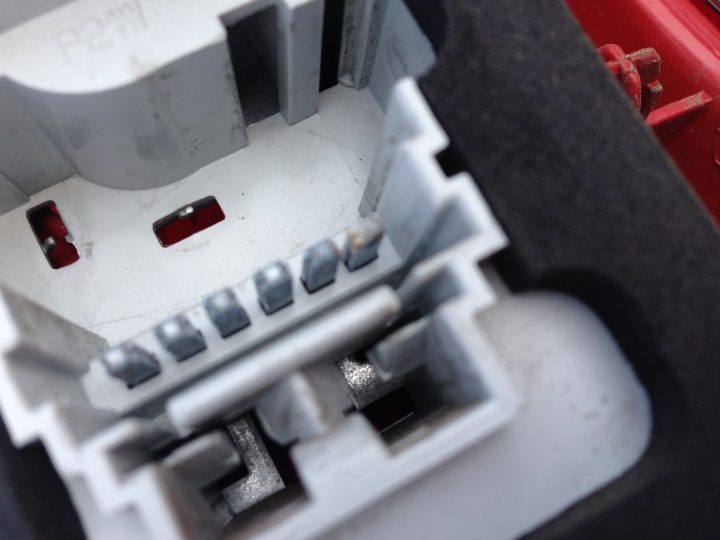

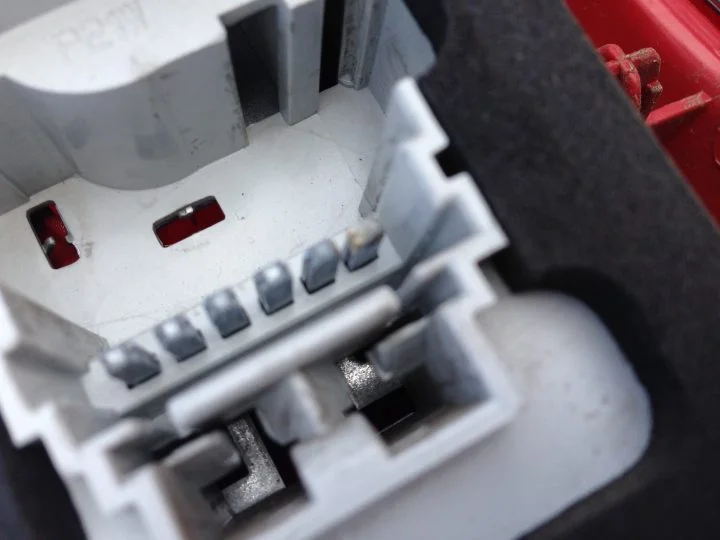

Something else I've only just noticed recently is the rear fog lamp light on the dash lighting up when pressing the brakes. I've read about removing the rear lights and cleaning the connections, could this also interfere with the cruise control?

I've cleaned up the one dodgy looking rear light connection (far right in picture) as best as I could and sprayed them with bilt hamber ferrosol but no joy.

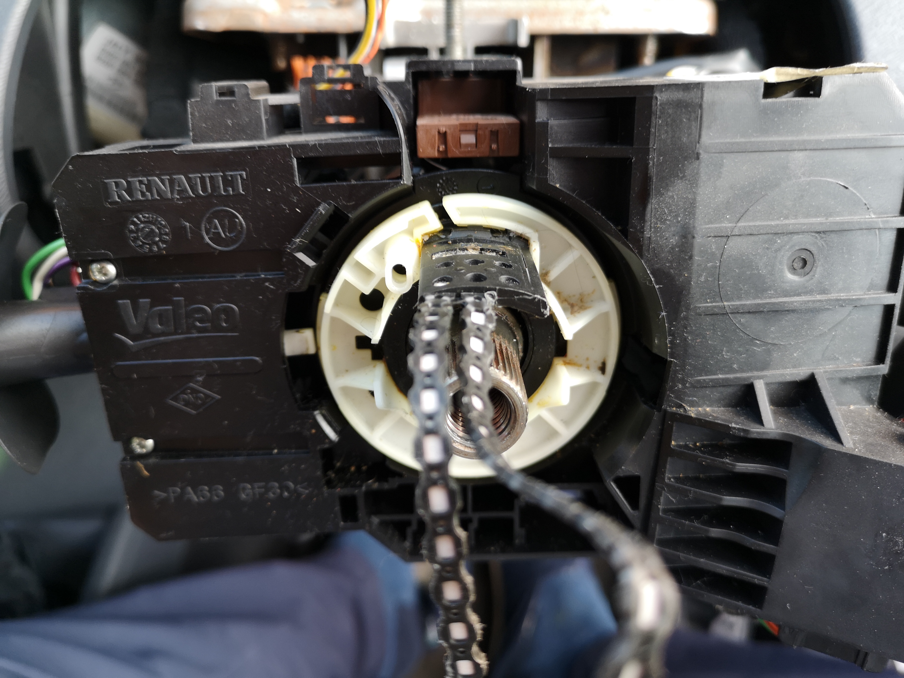

What's this white ring called in the steering wheel? Squib? The wires are encased in the plastic harness thing so no way to see if damaged, but it is a bit loose. How does it come off?
The cruise will turn on via the dash mounted switch and display on the dash but won't respond to steering wheel buttons at all
