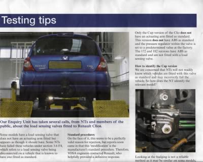

Its because the cups don't have ABS so they don't have this rear bias unloading valve or whatever, they do an mot test for a abs equipped car and fail it because its not there.
  Seat Leon Cupra 290

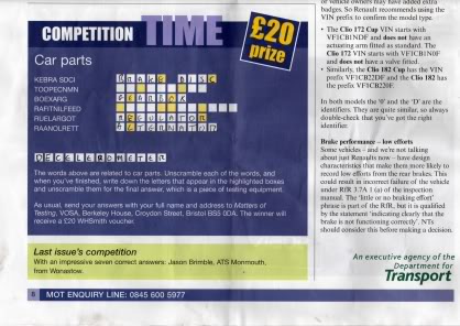

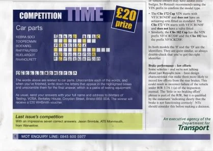

my mot tester knew about this, all the people who carry out the tests should of got a newsletter of sorts which includes an article saying about the brake bias on the rear, i might be able to scan a copy up for you..
  Seat Leon Cupra 290
got the article if anyone is interested, not sure of the qulaity and excuse the crossword!
cant make them any bigger than that, say if you want a bigger one and ill email them to anyone interested
