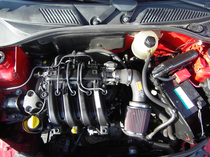

K&N or custom made plate adapter for a 712 is the easiest route.

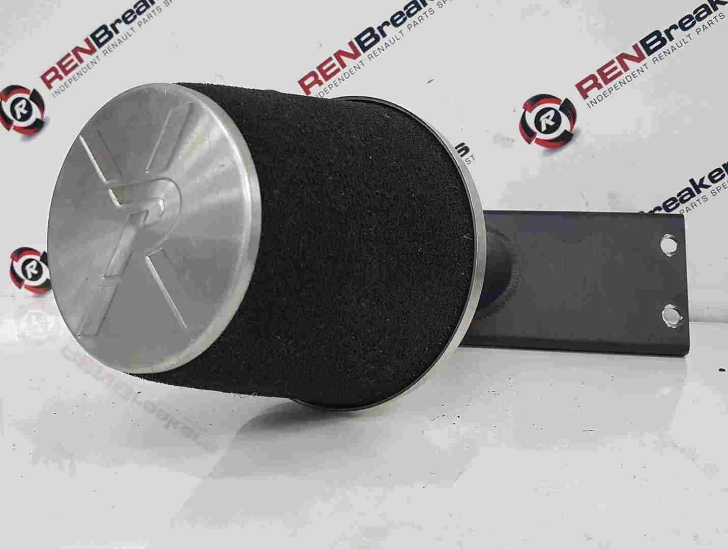

Hi, Thank you for the reply. I've looked at these aswell but im looking at options to mount directly onto the throttle body inlet like the image attached, cheers
