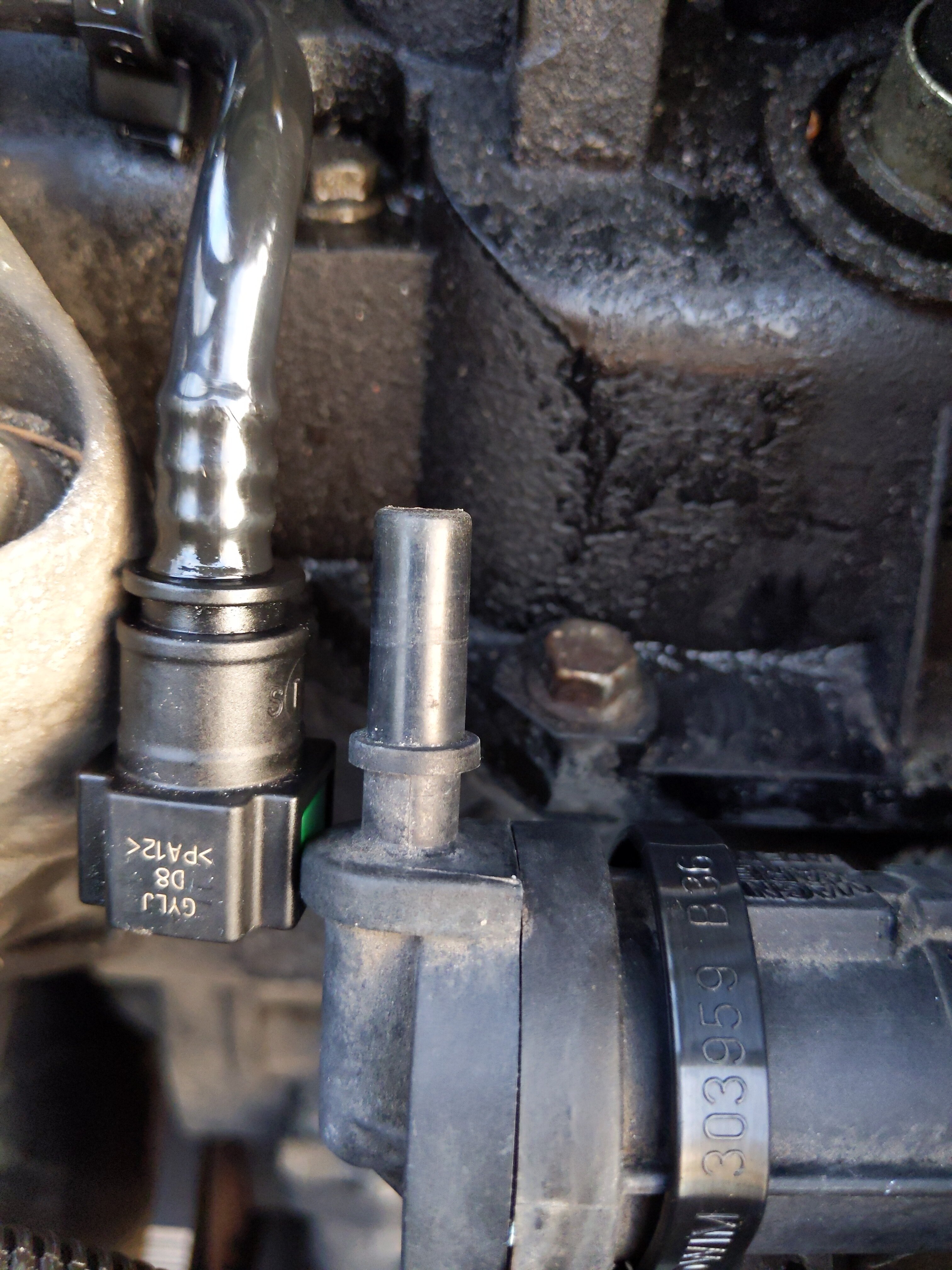

Any help appreciated, pic attached for context.
is the fitting on the rail worn?

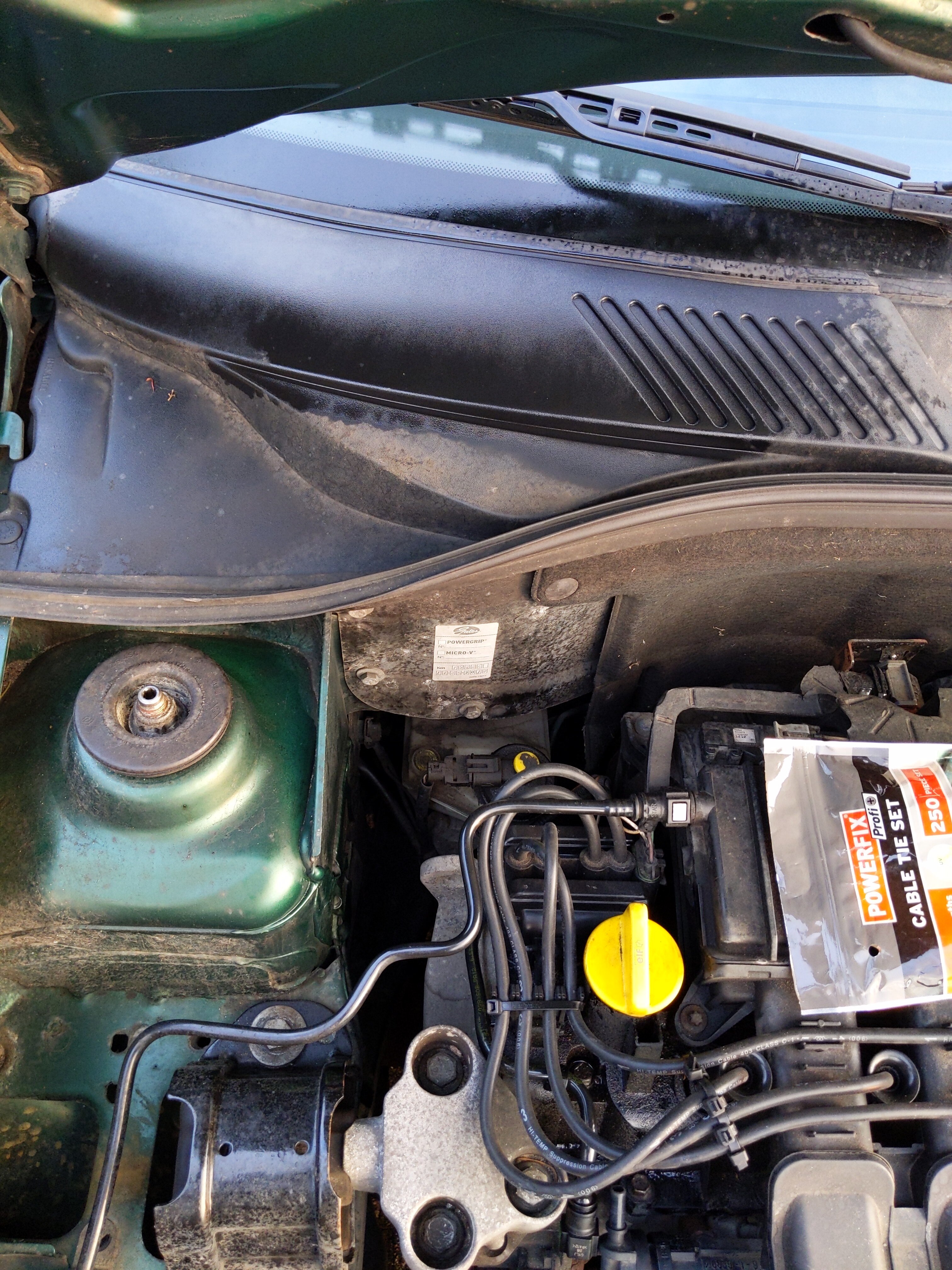

I pulled off the pipe to check and it just fired fuel all over the car and me..... Pressure build up somewhere, it fired out from the fuel rail....
Bad pic but fired up the bonnet/windscreen
Fitting looks fine though haha

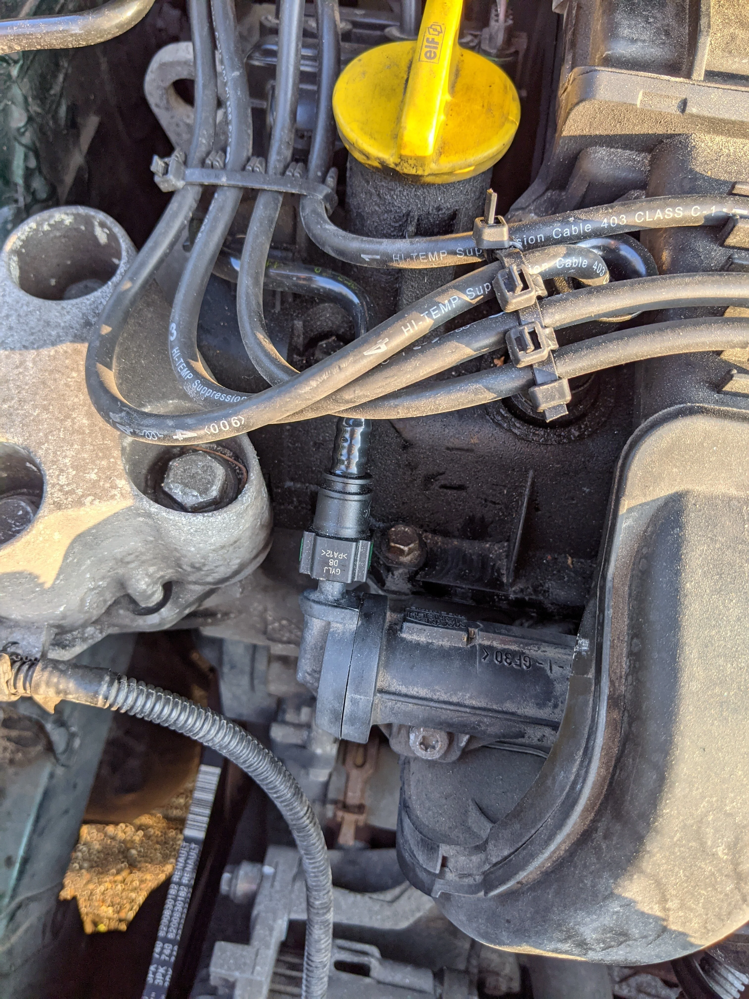

Looking at my first image the pipe wasn't pushed on all the way. This doesn't explain it coming loose a month ago but could be why the new pipe popped off, placed some zip ties there just in case and see how things go.
