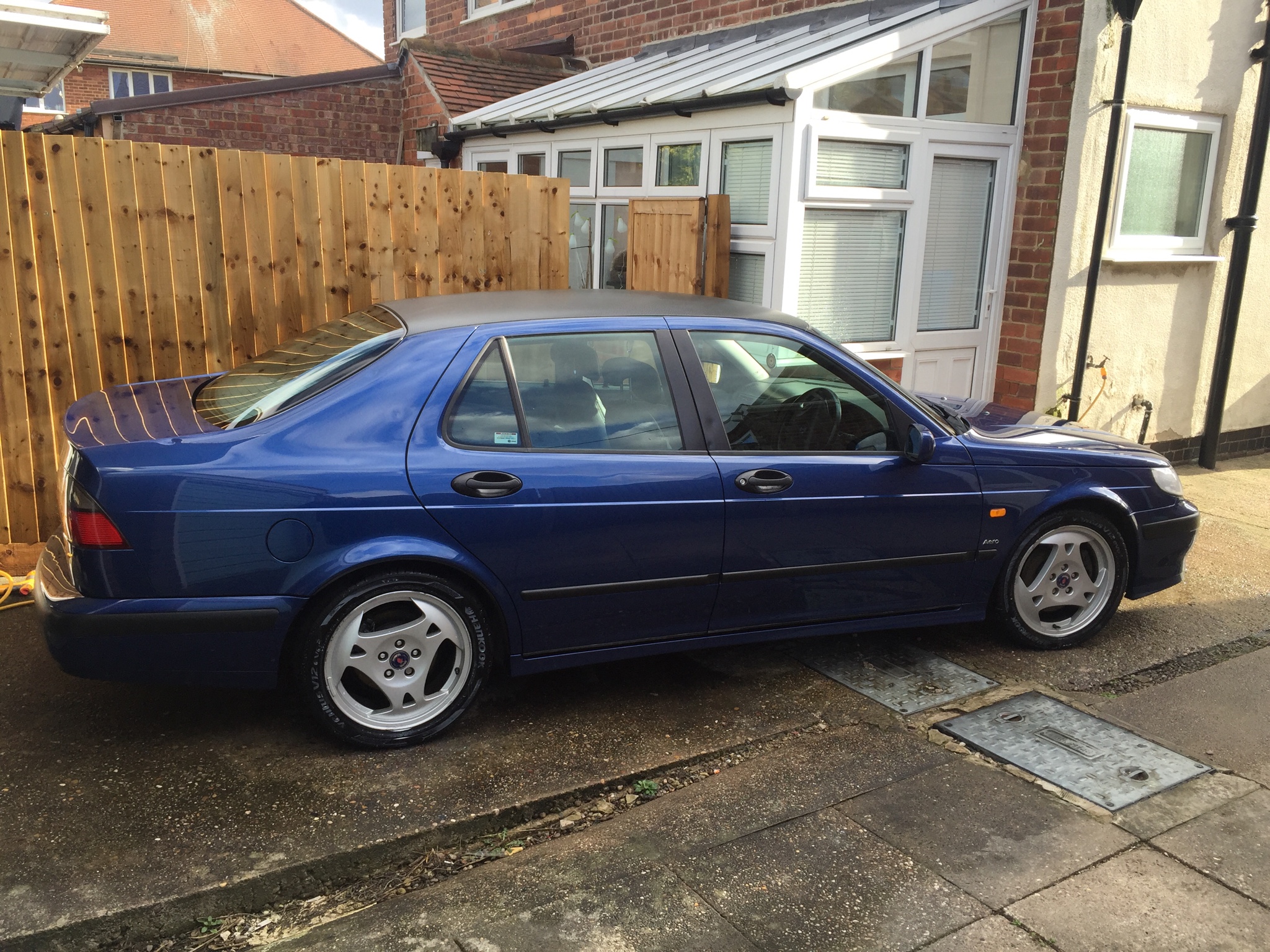

Anyhow, last year I had been messing about with a stage 3 Saab 9-5 aero. It was a random eBay purchase. Which I ended up spending a fortune on, then only to sell for peanuts as per usual.
It was pretty quick in a straight line and a great cruiser. But was not exactly pin sharp in the handling department. (Also carbon wrap roof was not done by me!!!)

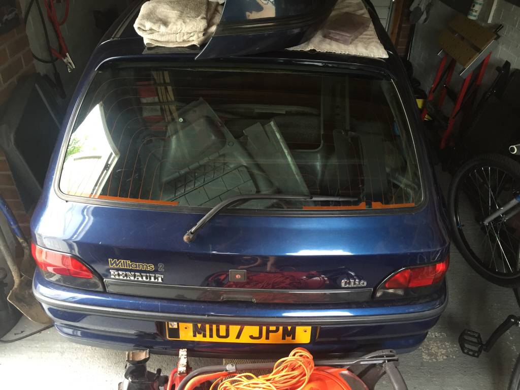

At the time I also had this in the garage, but it was completely rotten, I also spent a fortune on replacing most mechanical bits, the complete interior etc etc
But it had taken me two and a bit years and there was still loads to do. So I bailed out and sold it. Probably for a loss.

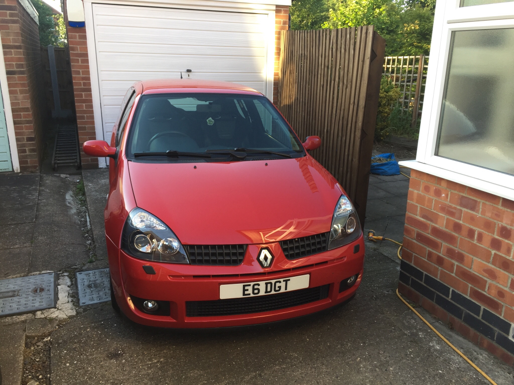

Here she is back at home, there was a nasty dent in the bonnet that would beee sorting and the box was a bit reluctant to go into third. I am probably the worst car buyer EVER! I just don't check them over, I get all excited and hand over the dosh.
Never mind I was happy. It had a recent ish cambelt at Diamond motors, the dampers refurbed and a complete suspension refresh in 2015. Also was on eibach springs and koni rear dampers. Plus quite a few other mods.

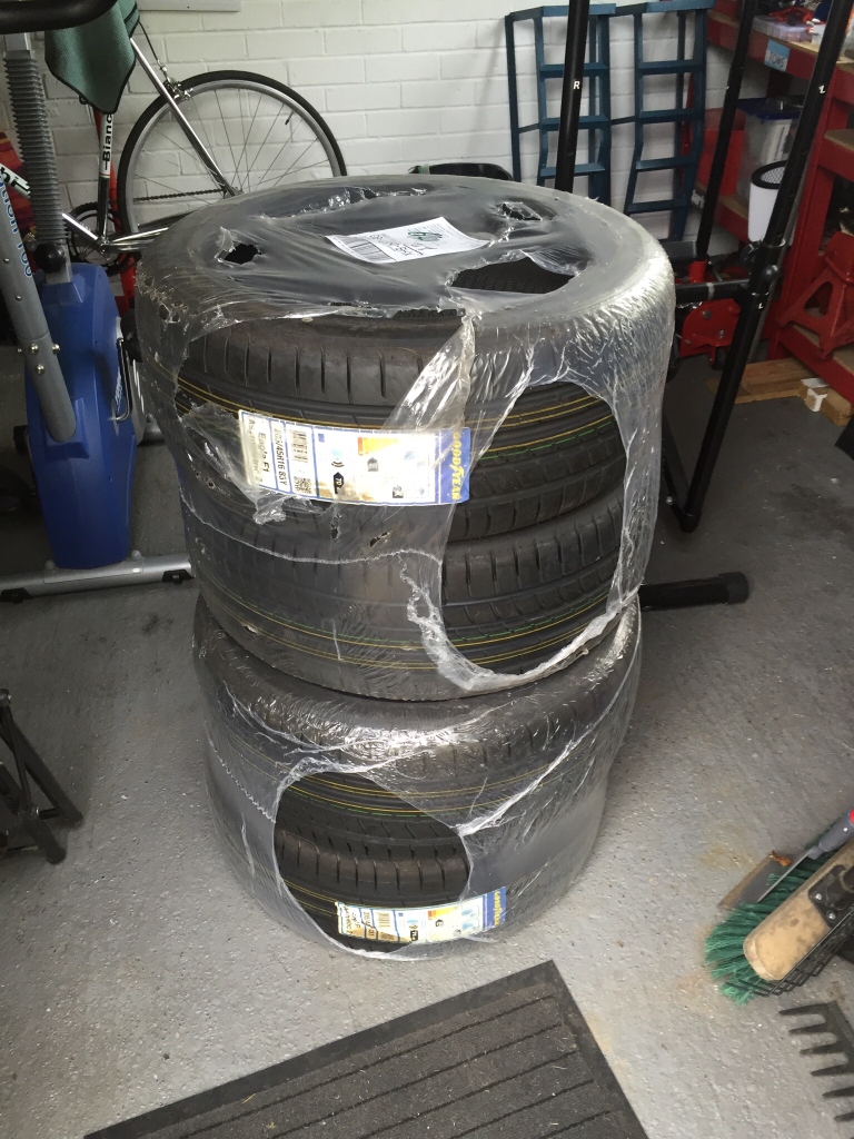

X4 eagle f1's, it had a set in already, but they was a few years old and getting low on tread. So replaced like for like as it handled great on them.

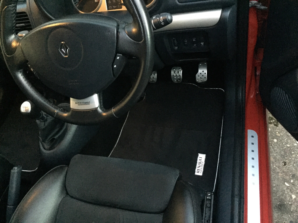

Some new mats got ordered.

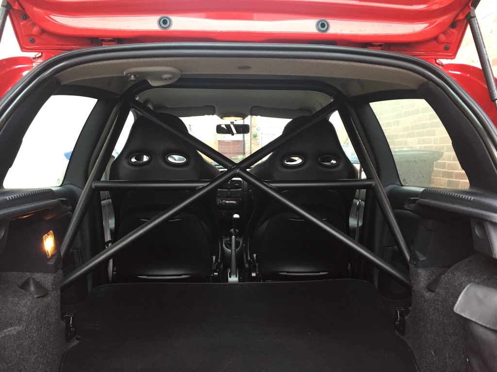

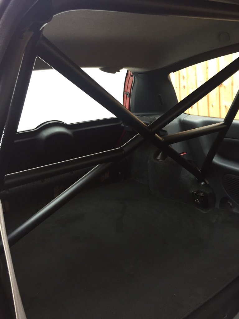

Fancied a cage, but was unsure.
Seeing as it was never going to be a concours low mileage example and basically I wanted to drive the nuts of it I went for it.
Ordered one from mark fish and got him to install it, they did a ace job and was a great bunch of lads.
Got a rear mat and left all the trim in so it's not a stripped out racer.

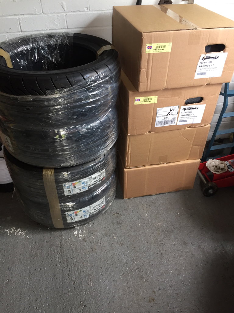

Next up I decided I needed some track wheels/tyres.
More monies spent and I had some pro race 1.2 from rimstock in the correct pcd, et and bore.
Plus some Ad08r's from Jordan beets.

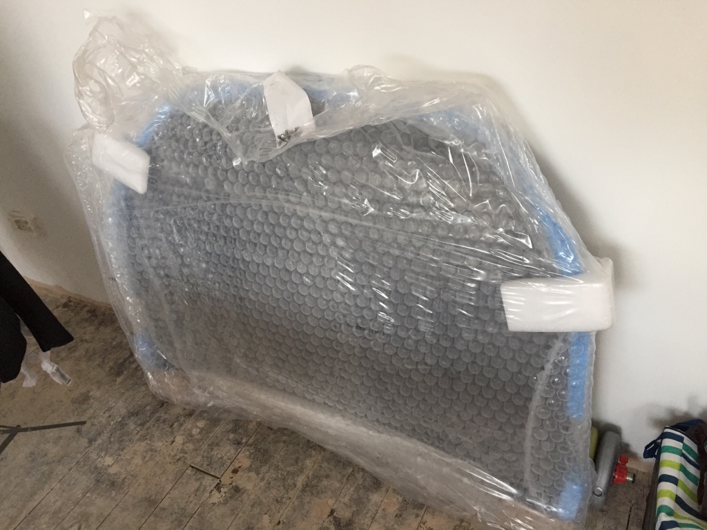

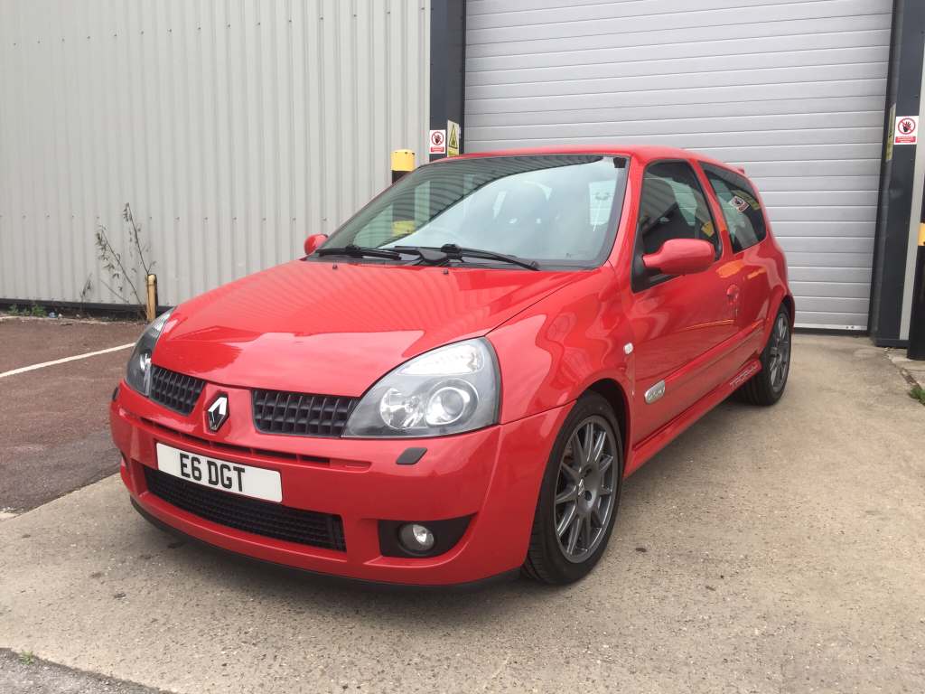

Then it time to sort the dent on the bonnet that was doing my head in.

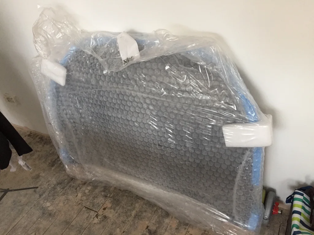

Yeah me new bonnet from Renault and loads of cash money later it had the front end done and looked fresh to death

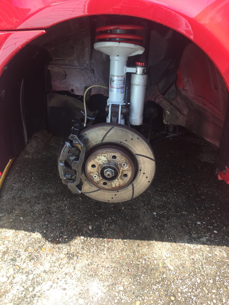

Then just last week I replaced all the fluids, stripped all the brakes down and greased up everything. Turned a brake hose around that had been twisted before when fitting, bled with 5.1 and made up a bracket for a power steering pipe that was loose.

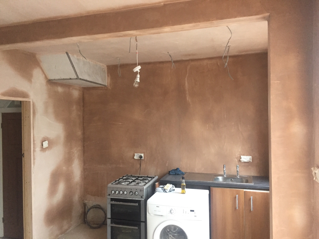

So basically this car is why our kitchen still looks like this 9 months after it was plastered.

Since I have had the cage fitted I have noticed its become quite tail happy, its quite easy to control with some throttle, but I keep thinking it might catch me out one time.
I am pretty sure this is because the rear has been stiffened up, I'm also running a rear anti roll bar, would removing this help? or softening the rear koni's? Or if I have stiffen the front up with a pms strut brace kit and front cage, would it equal it out?? Or am I talking rubbish.
SharkyUK
No - that makes sense mate. It's not uncommon for a stiffened chassis to become a little more playful at the rear. I do believe some folk lose the rear ARB when a cage has been added whereas some soften it off a bit. I guess it also depends on your preferred style of driving as well :)
