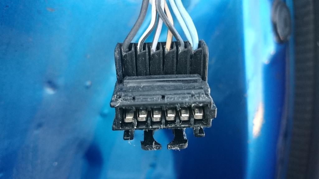

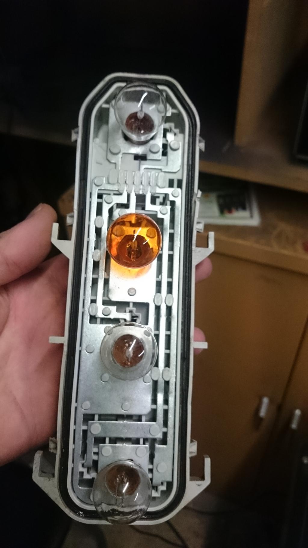

Cluster and plug look fine
I had the same problem, tried all the tricks, solved the issue by putting LED lights in, they draw almost nothing so you don't get any shorting out... slightly duller than normal bulbs but I can live with that

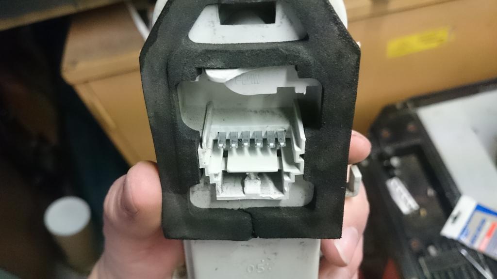

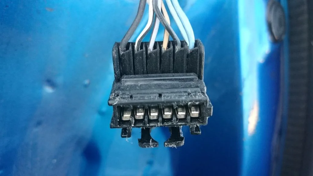

On the top, where the top row of silver pins would be... you can lift that little black plastic bit up. It's like a flap.
Prise it up and push the top pins downwards so that they have a better connection on the light unit itself.
