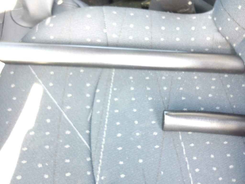

i forgot to take a picture before but i don't know if it is the same on other spec cars but my dash strips had a horrible pattern/texture on them which i sanded off with a 400 grit paper along with the embossed airbag sign which was a b***h to get off! I then sanded again with a 600 grit sand paper to smooth it off a little more!

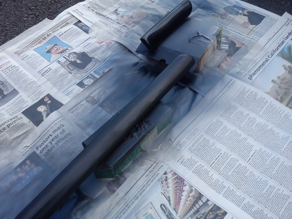

next the primer, i was doing the coats outside whilst i was helping my mate t-cut his car that he had just bought for £200 (complete banger but he loves it bless him!)

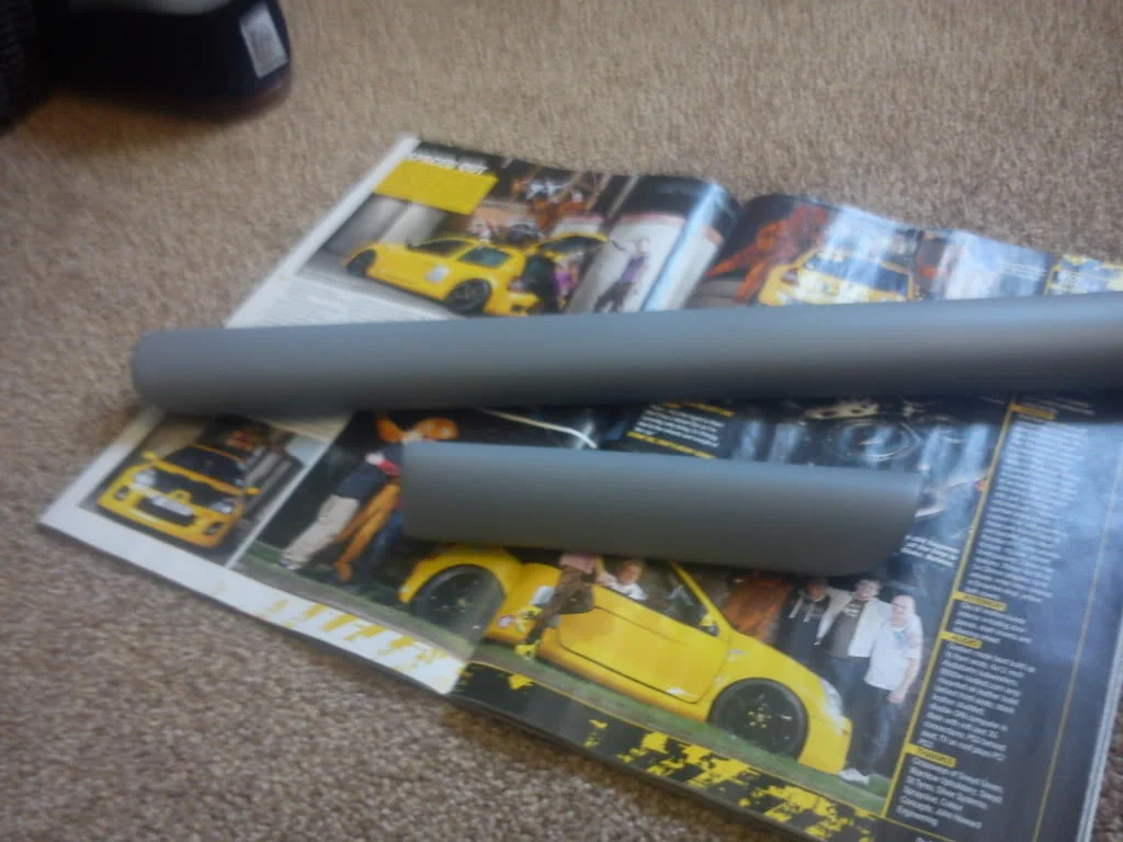

so after primer it looked like this...
then about four hours later (because i was impatient and didn't want to wait 24 hours) i sanded down the primer with a 600 grit paper wet and gave them about 5 coats of paint.

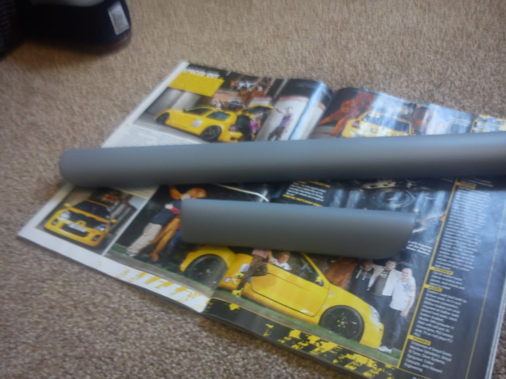

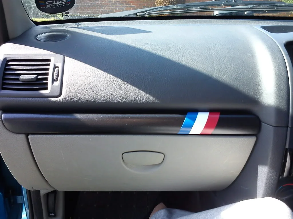

they then sat in the conservatory over night and in the morning looked like this! the finish i thought came out amazing! no run marks what so ever! the original plan was to them but after offering them up to the dash board i decided i liked them the way they were.

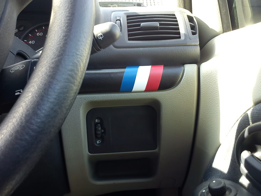

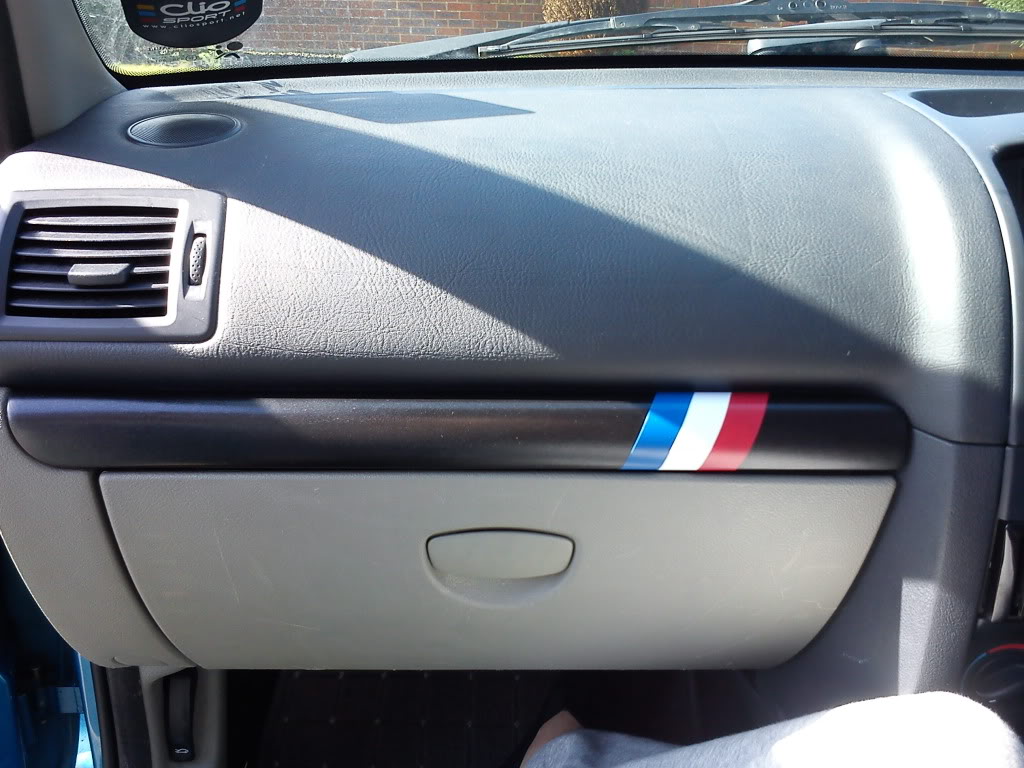

so it was then time to add the final touch and fit them so now my dash looks likes this...
