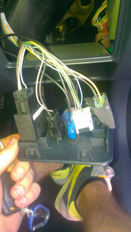

I've seen one of the guides for the crusie control retrofit to a 172/DCi, but it's missing a few pictures so I was struggling to find what I needed.
This is the wiring currently behind my panel (ignore the extra switch, the previous owner put in some on/off relay but I have no idea what it does)
Am I right in thinking all I need now is a 182 steering wheel with the buttons, a clutch switch and a panel with the cruise control settings to plug straight into the loom? or are there a few more parts I'm missing?
​Cheers.
Think you'll be missing the steering wheel squib, as your current one won't have the connectors for cruise control.
Think you have everything else.
