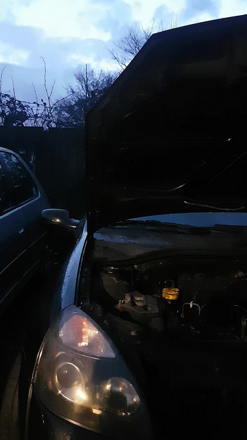

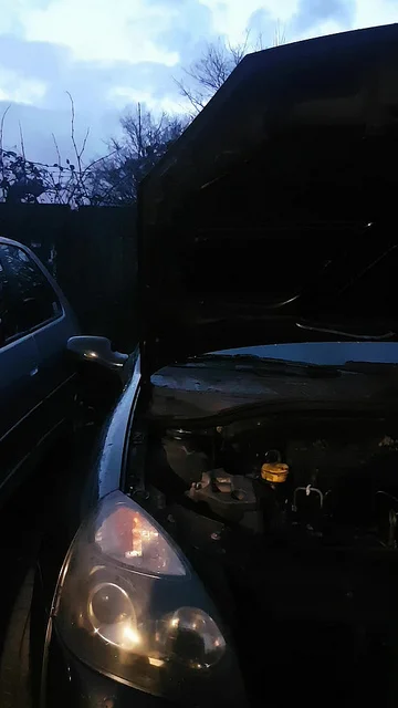

Went down last night as i had a spare half hour im definatly leaning towards injector. I can just slightly hear the knock when idling then i raise the revs to over 2500rpm and i get loud knocking a hell of a lot of smoke then take my foot off the accelerator and it settles again.
Iv managed to also get a vid altho maybe not that clear
20190208_173418 by Daniel Clifton, on Flickr
