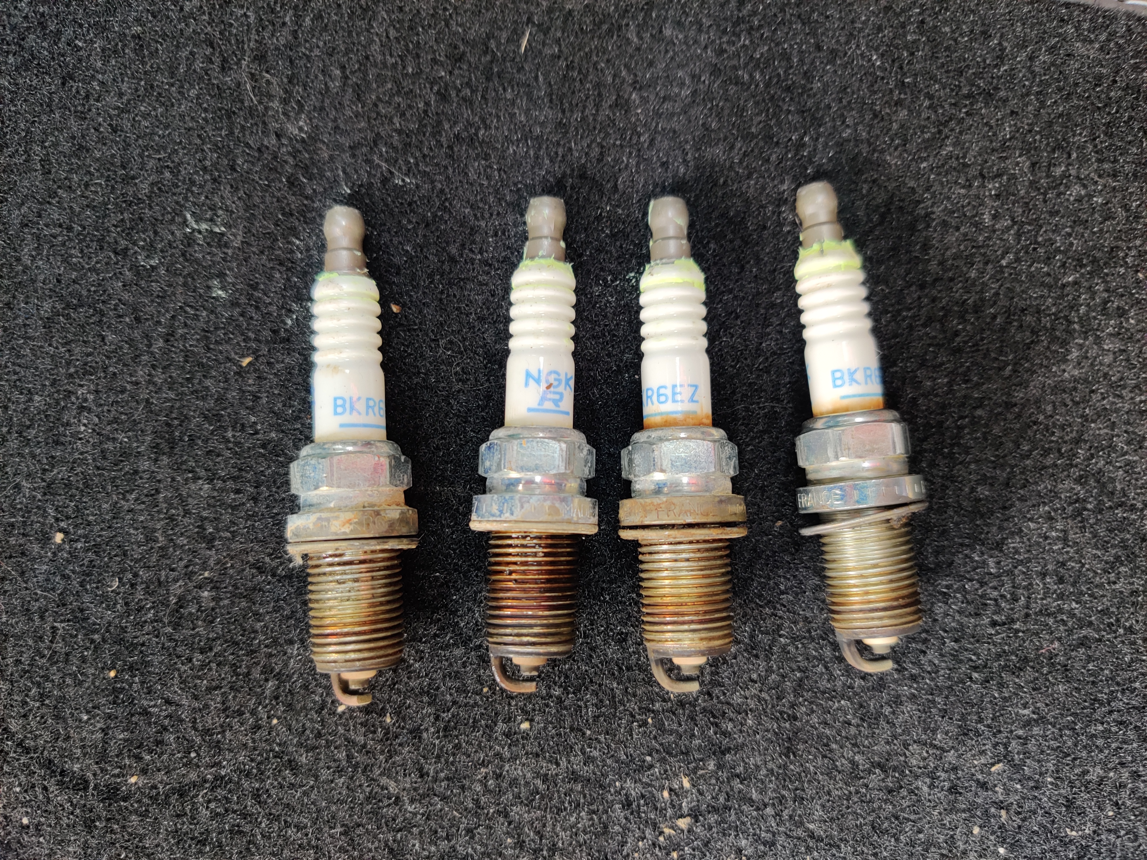

Also, I have ridden for a while and let the car sit for an hour like last time. Then unscrewed the spark plugs for ruling out a flooded engine (leaking injectors or somesort). they look like this:
Seems to be fine. No wetness on the electrodes and ok color. Any suggestions?

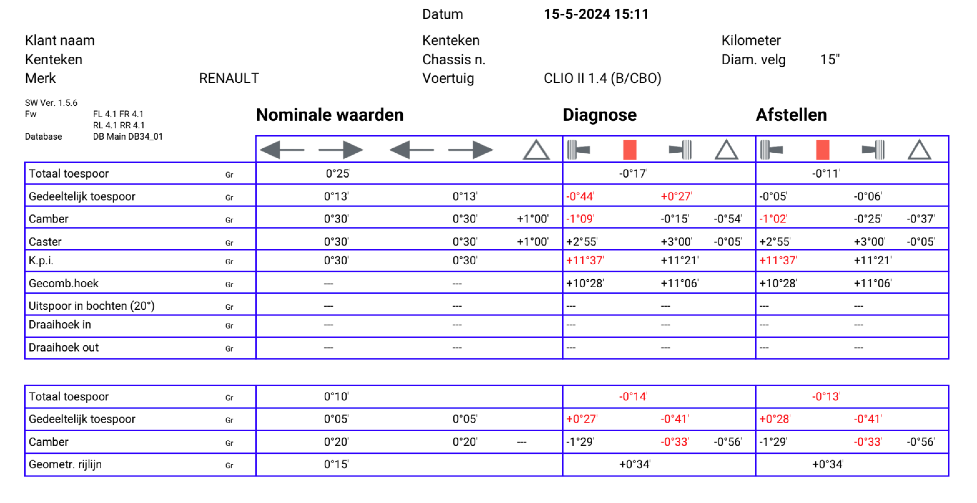

Car went to the renault specialist. He didn't experience the issue, but preventively replaced the crank sensor. I did a test drive afterwards, and it didnt help. He said that the old sensor was installed incorrectly, So still a worthy investment i suppose.
I went on the search for new injectors as advised by the mechanic. It is the only part that could be causing the issue. Originals are Siemens Deka variants with OE number 8200132254 (blue stripe). I can't get them anywhere in the entire country, so i bought 4pcs magnetti marelli 805001446001 IWP042. These are used in these engines, so i assume they will work.
Also went for an alignment. Toe alignment was way out. Also the camber is uneven and out of tolerance on one of the front wheels and the rear beam. I wonder how that's possible.
