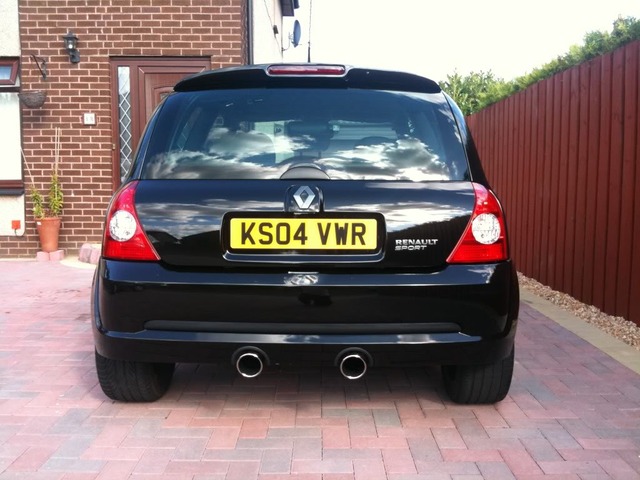

yep. clio badge is pinned unfortunatly. renault and sport are not tho.
here is mine filled, painted and stickered :)

Yep that looks lovely. Do you mind me asking what they charged you to do it?
I take it the whole bootlid needs taking off and the bottom section spraying??
What about the Renault symbols front and rear??? Just clipped in??? Hopefully I haven't got to take the bumper off to get the badge off :lol:
  b/g 182, meg tourer
i think it cost me £90. there was a small dent and the 2 holes to be filled from the badge and a full tailgate respray.
front diamond pull's off, be very carefull tho, the pins can snap quite easily.
rear diamond is slightly harder to remove. open boot, remove plastic pannel, there are 3 nuts nolding the boot release surround on iirc. remove this, then you will see that the badge is pinned and glued on. pick the glue away carefully from the pins, then the diamond pops out. i am painting my rear diamond when the weather gets warmer.
