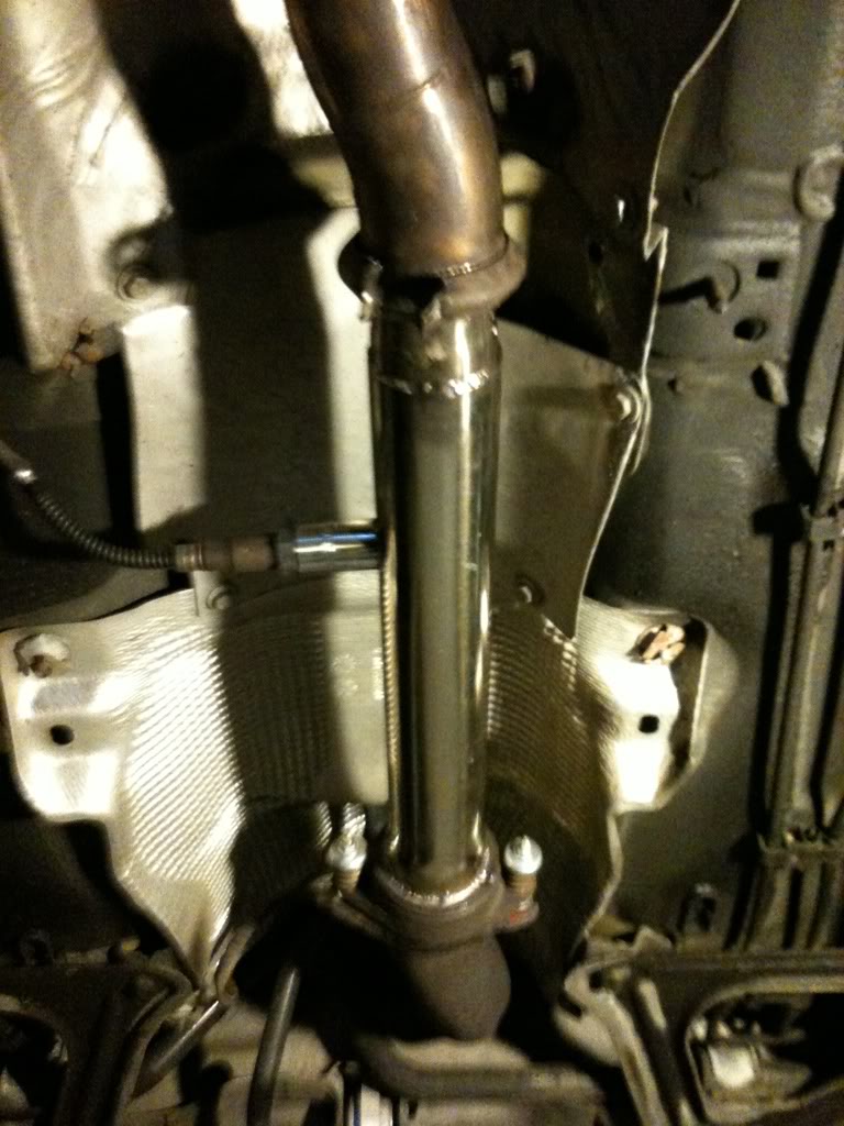

What needs to be done to get one fitted? Do they cut the CAT out, and flange the pipes so the decat can be taken in/out for MOT's? I also have a Scorpian RS192 exhaust, so will I need a Scorpian Decat? Thanks
  182
For a 182 they should all be the same, they dont cut anything, cat is removed as its bolted at one end and clamped at the other,then de-cat bolted and clamped in place, thats why its so easy for a 182
