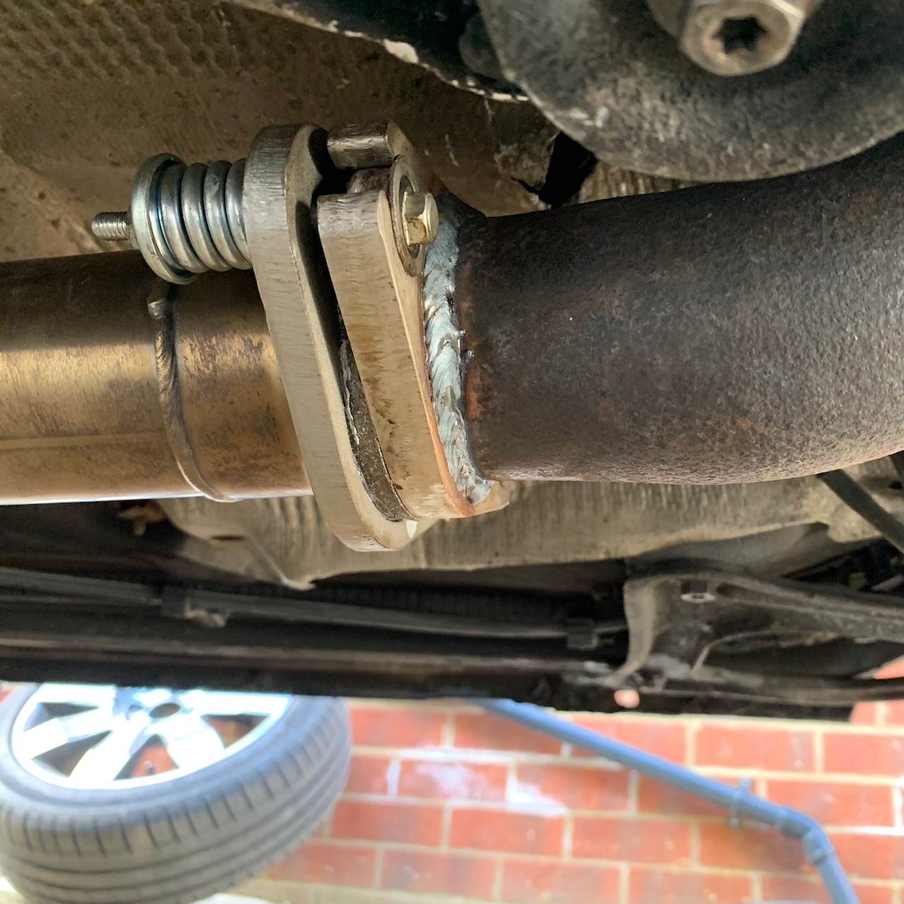

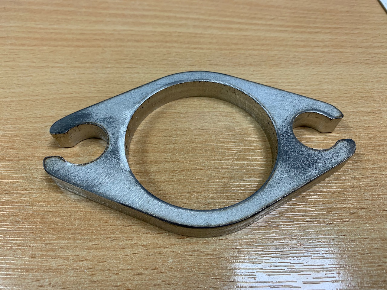

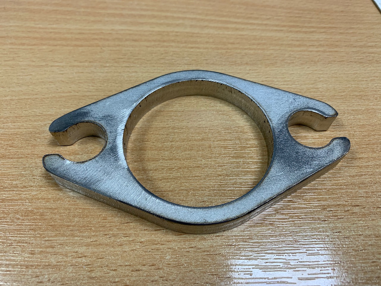

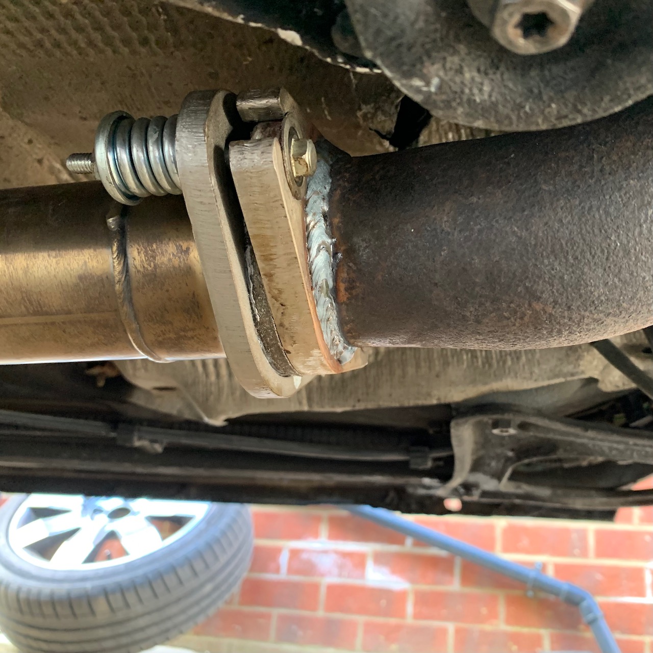

Depending on how bad it is, you may be able to get a new flange welded onto the manifold - see picture.
I got mine from a member on here but the name escapes me now, but stick a wanted post up - use my picture by all means :)
I got my local exhaust centre to weld it on.
If not, you should be able to pick up a second-hand manifold easily enough, and then weld a new flange onto that.

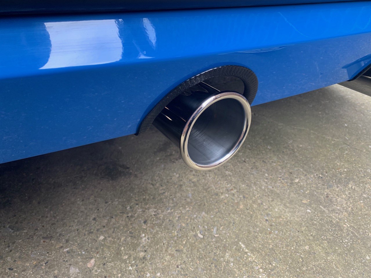

If you have to replace your entire exhaust and have deep pockets, take a look at the PMS systems, they're top-notch. See - https://www.pure-motorsport.co.uk/182-racing-exhaust-system.html
Tick the 182 Manifold option, then 200 CELL Sports cat, and then you have a choice of tips.

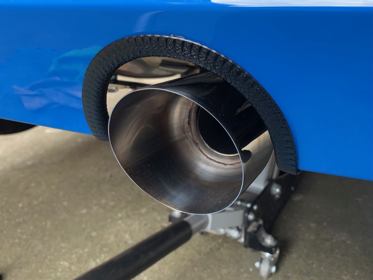

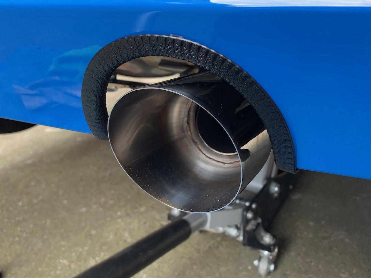

I've had the 3.5-inch slash cut which look really nice.

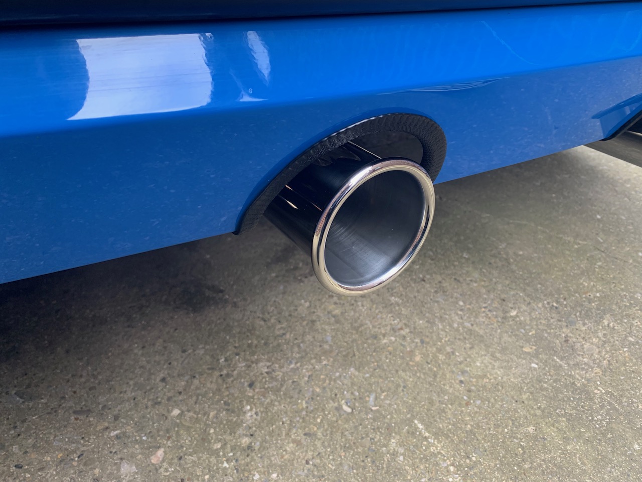

But have recently switched to the 3" outward rolled type, for the OEM look.

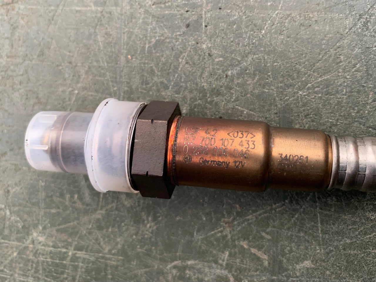

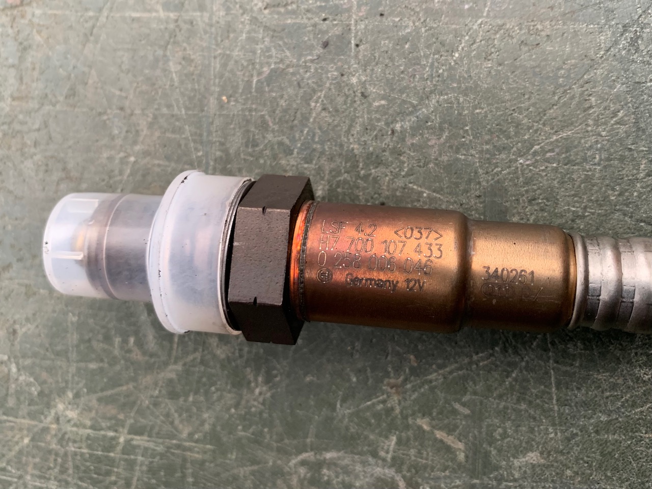

No issues with MOTs either but I'd recommend sticking a couple of BOSCH Lambda sensors on for good measure. These are what Renault use, but you'll pay half the price for the same part by ordering the Bosch. Renault Part Number is (7700107433) - OEM Mfr. Bosch (0258006046).

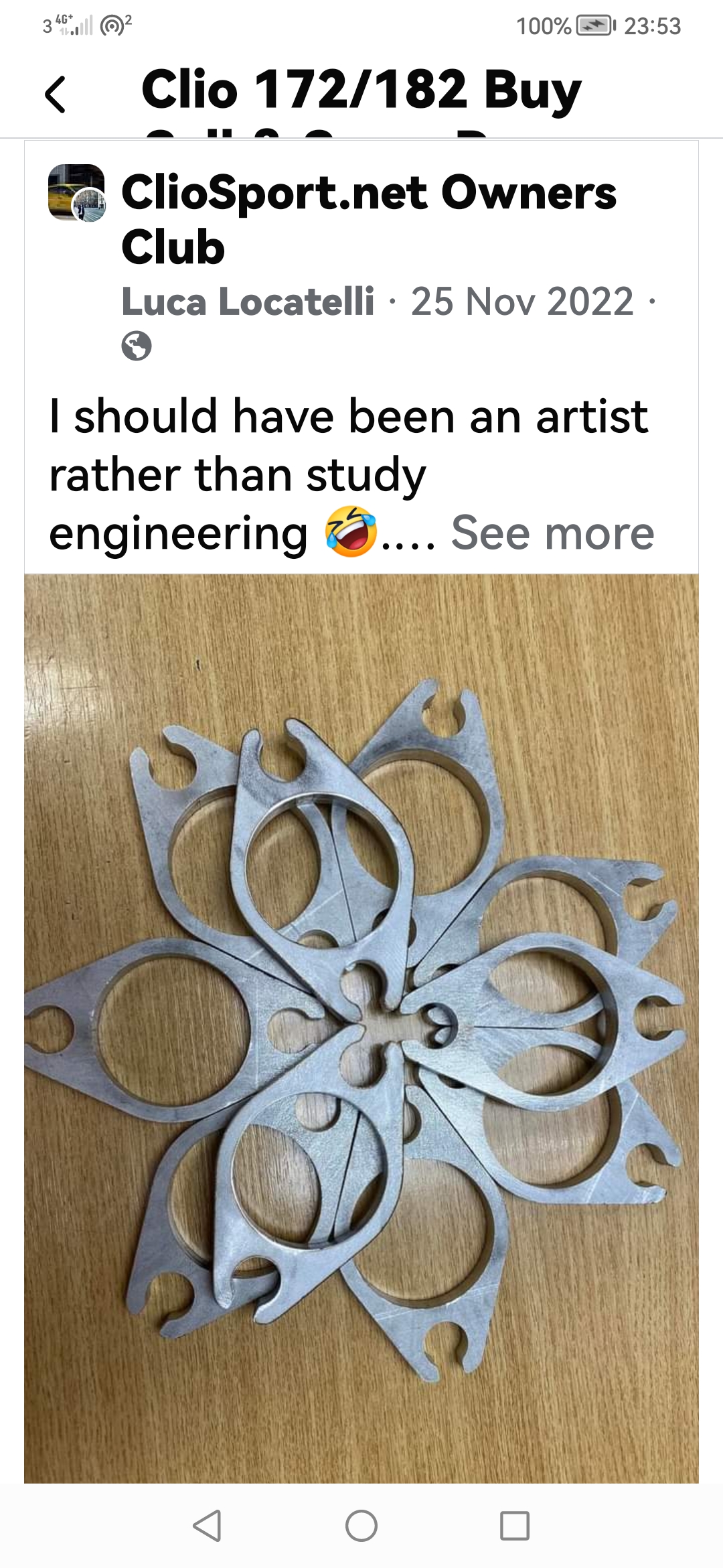

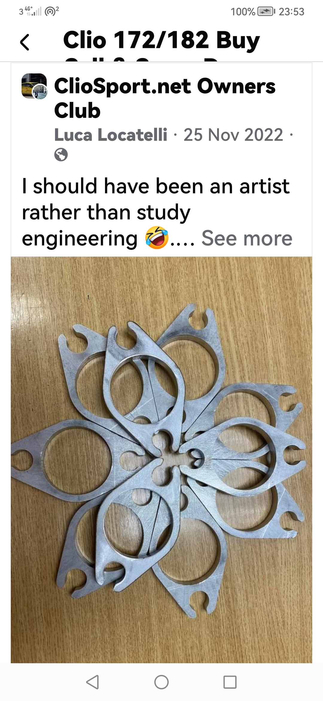

There's a guy on Facebook called Luca Locatelli who sells stainless flanges.
When my car was at Birchdown, they welded the stainless flange in place with the exhaust manifold still in situ.

You don't need a Clio specialist for this job - just a reliable exhaust centre.
My local exhaust centre welded a new flange in place while the car was on the lift. It was a straightforward job.
If you're up for fitting the exhaust yourself, it's not too hard. I followed a guide on the PMS website, and it went smoothly. But if you're unsure or prefer not to tackle it, any decent exhaust centre can handle the fitting for you. Just talk it through with them beforehand, and they should be able to do everything in one go.

Get it vbanded on the flange. The spring clips never seal with the s**t donut.
They do if you've got a decent fitting kit.
This is one I knocked up out of stainless parts years ago. It's still going strong and even better now I've got a stainless flange. 😁
