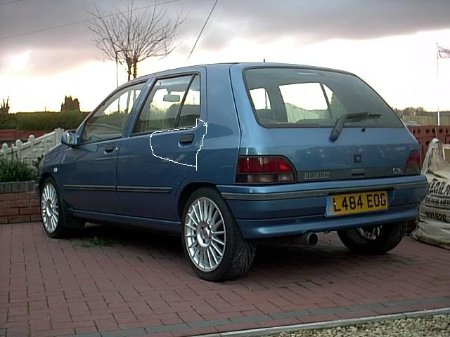

obviously to get the perfect finish and as the handles are at the back of the door, to get a good colour match, painting into the rear quarters is what should be done, however with aerosols and with inadequete experience i wouldnt recommend this n ide just paint the back door tops.
the white line is where i would paint to with the aerosol.

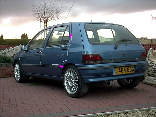

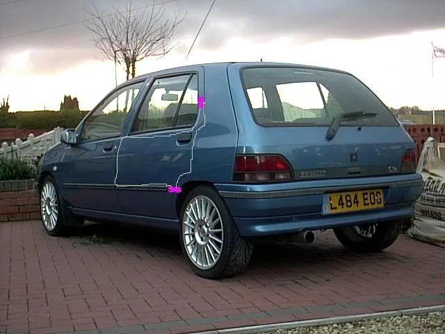

now your ready for laquering. get yourself 2 or 3 cans of cellulose laquer. acrylic will be available and provides a harder finish, but cellulose is more durable so i use that.
the white line is how far your gonna laquer, the pink marks are where your gonna have to improvise and blow it in. as you dont wanna paint the bottoms of the doors (unneccesary) and you dont wanna go right over the top of the door (unneccessary/colour reasons/pointless).
ide say your gonna need 3 coats of laquer. apply it well and try get a good finish. between laquer coats dry it off for a while.
