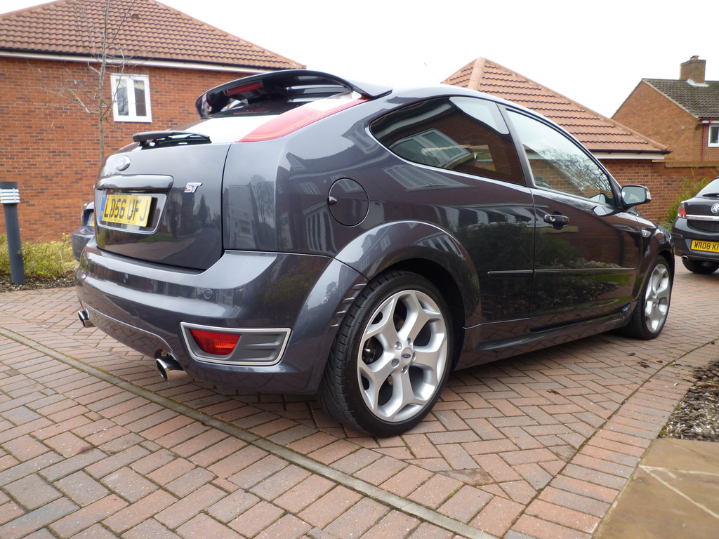

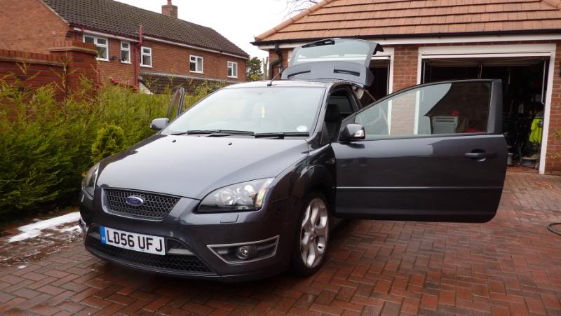

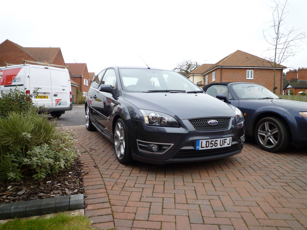

Today's detail saw me travel to sunny Stone, to give my mate Russ' newly acquired Ford Focus ST3 a bit of love. I agreed to do what I could in the 8 hours or so that I had...

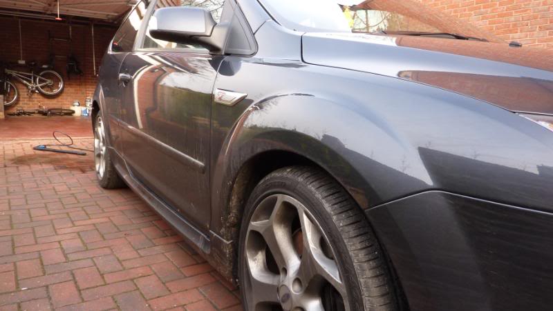

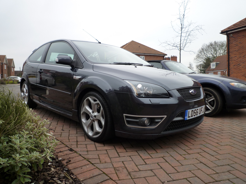

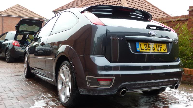

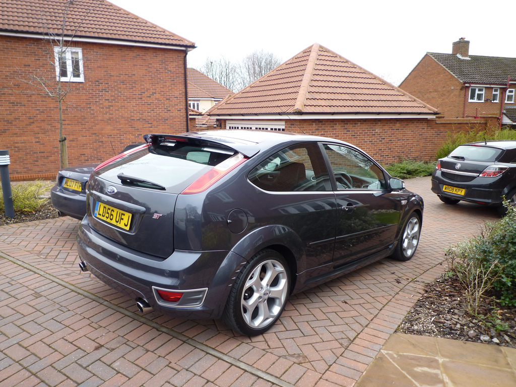

A few pics of the car when I arrived:

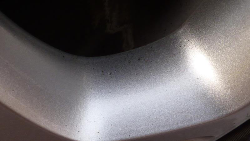

However, I did have a small problem...
Luckily, I had some Tardis to hand, which quickly dealt with this heavy contamination. However, the back of the wheels still need a bit of care, which Russ is going to take of himself when the weather improves a bit (Russ - let me know if you want some Tardis mate)

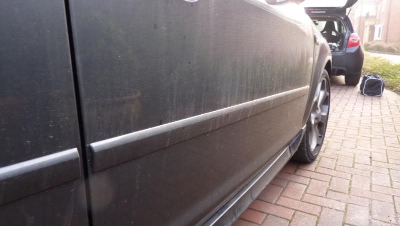

Next up, the car was rinsed with my Nilfisk E140, hand washed with Zymol Bucket, Sonus Mitt and Dodo BTBM, then onto the claying. I used Elite Poly Clay with Born Slippy lubing it up.

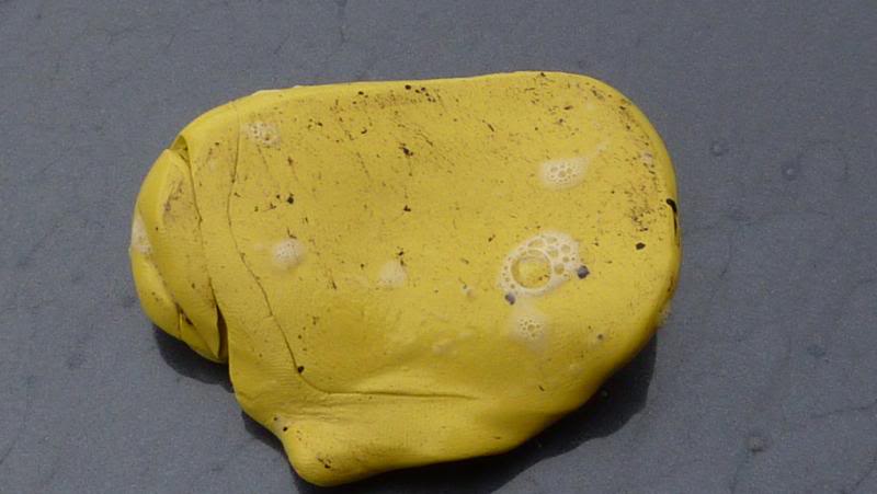

As I began claying, I noticed large chunks of tar all over the car, so these were dealt with first with Tardis and an MF, then onto the claying. The used claybar:
Not too bad at all...

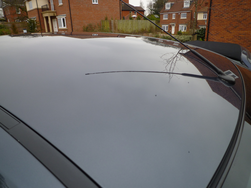

Next up I dried with my new AS Drying Towels (great towels!). A few 'after wash pics':

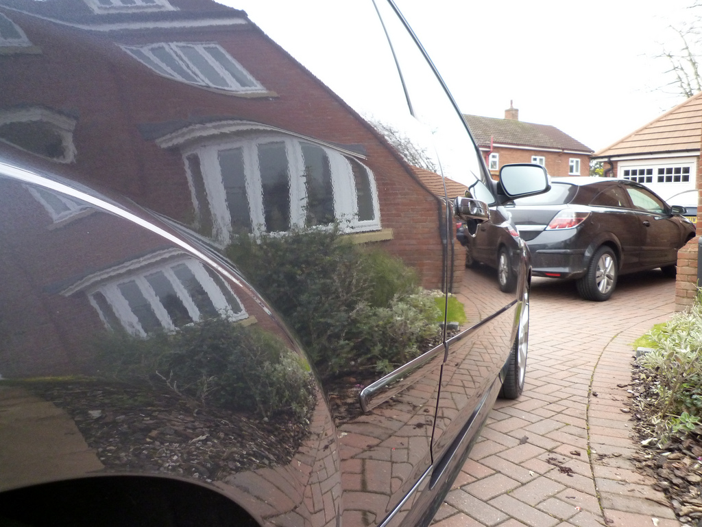

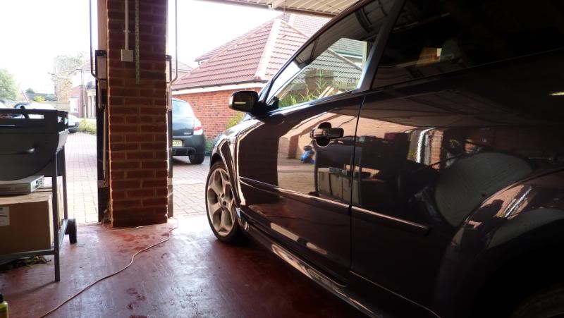

Next up, the car was moved into the garage (a god send today, was a bit nippy!!), and the paint was assessed.

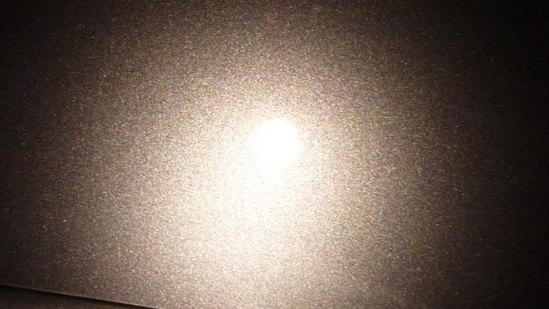

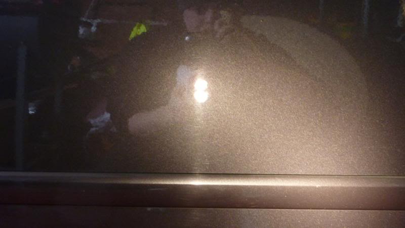

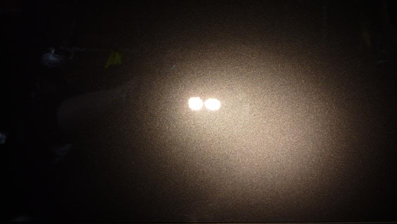

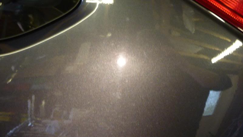

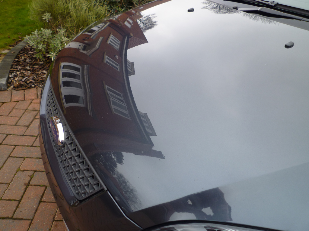

Overall, it wasn't too bad - just general swirling, with a few stone chips and a few RDS's, particularly on the bonnet. I was struggling to get my camera to focus, but here are a few pics of the swirling/paint defects:
The paint averaged about 180, with some higher and lower readings in places, but plenty of paint and a good, even coat:

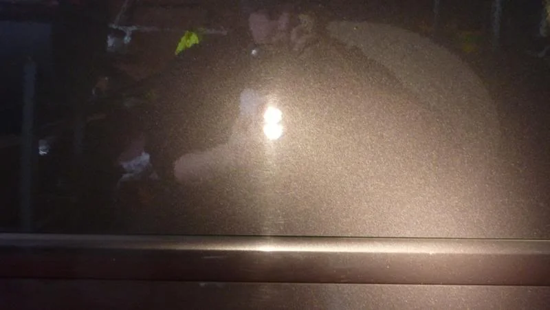

After trying a few combinations, I was getting near 95% correction with Dodo Juice Lime Prime, on a Planet Polish Hex Ring Green Polishing Pad, worked by my Chicago Rotary.
Again, I struggled with the focus on my camera, but here's a 50/50:
and corrected paint:

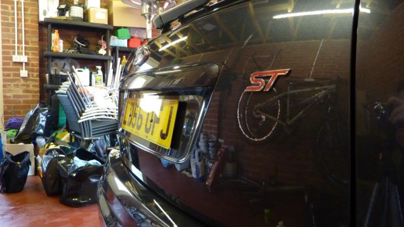

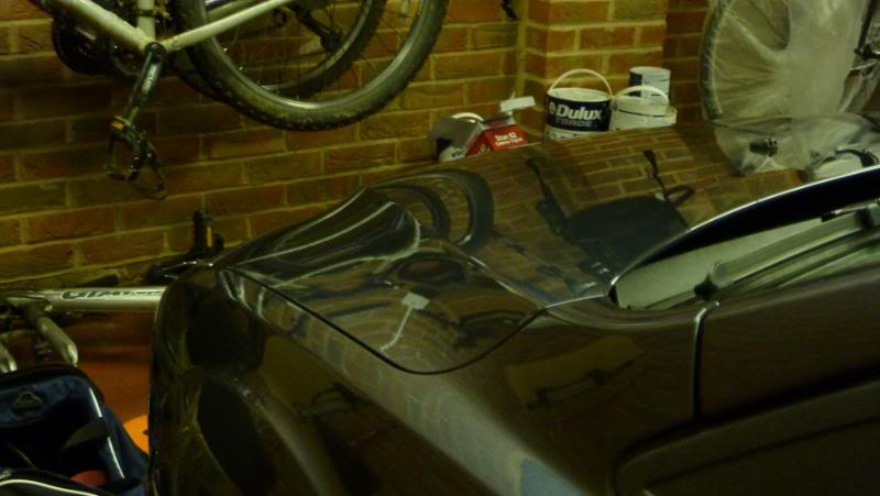

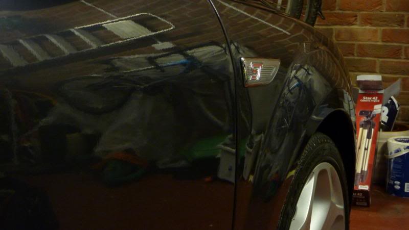

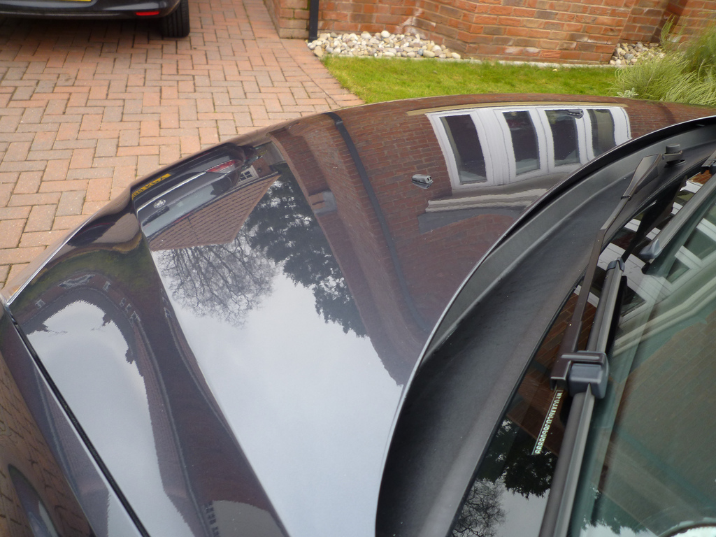

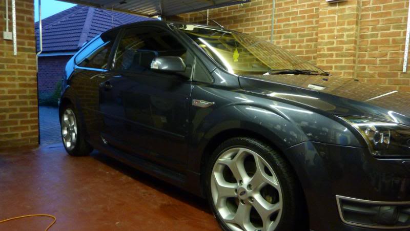

Anyway, some afters after the polishing stage:
After correction, I opted for Auto Smart 'WAX', which I have been testing on my own car, with very impressive results - great sheeting and beading, which will make this car a breeze to clean for the coming months. This was followed with a Britemax #6S wipedown.
Glass was cleaned with Megs Glass Concentrate, tyres dressed with CG NLTG and exhausts polished with Megs NXT

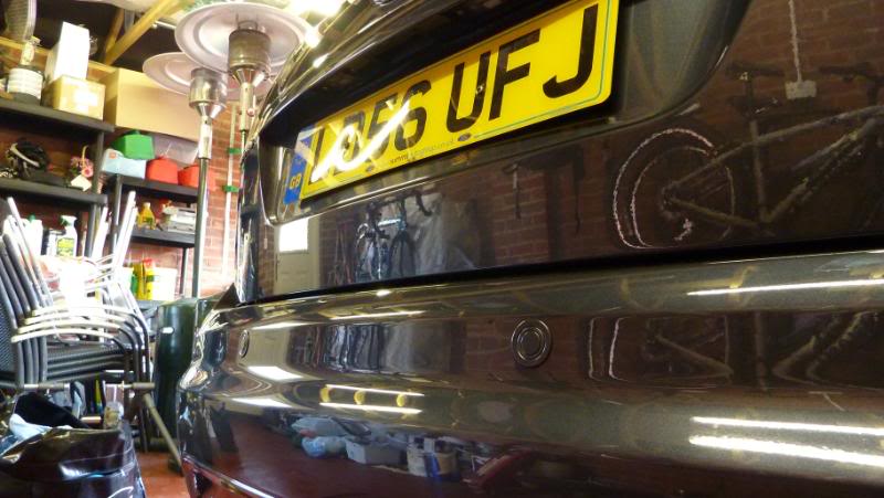

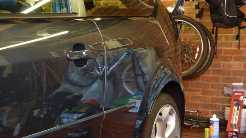

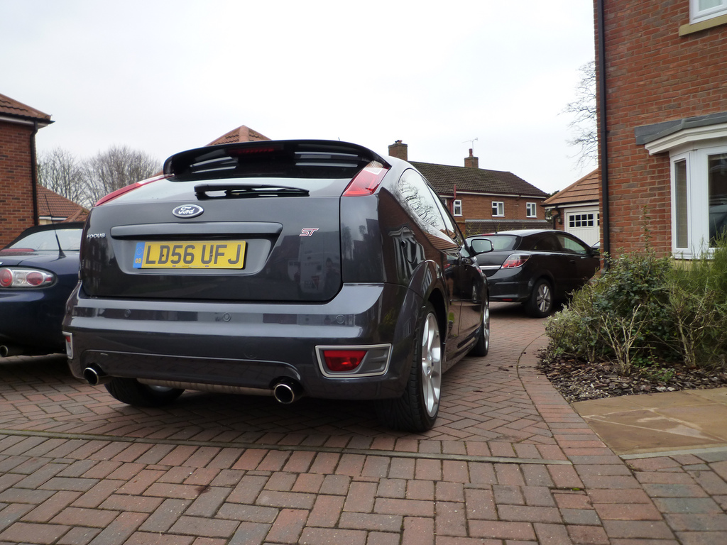

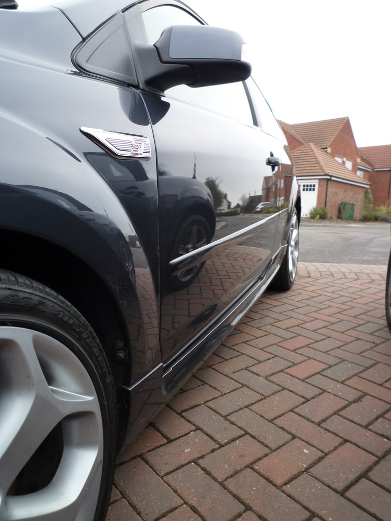

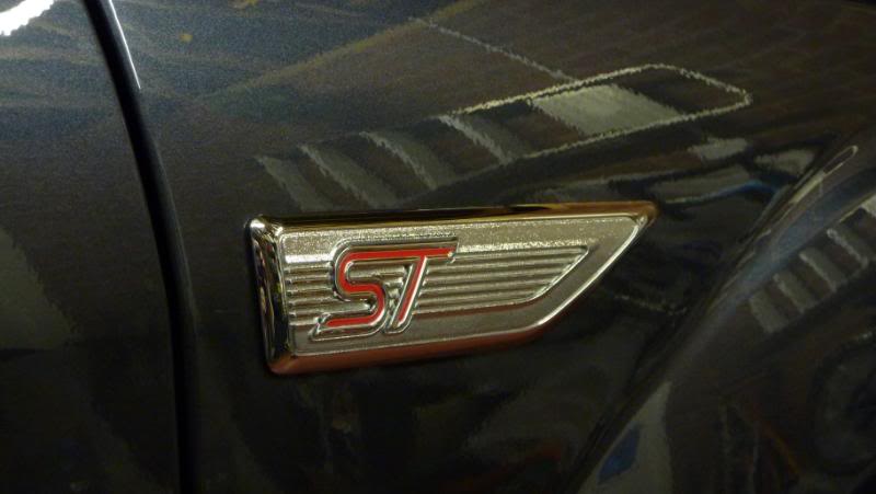

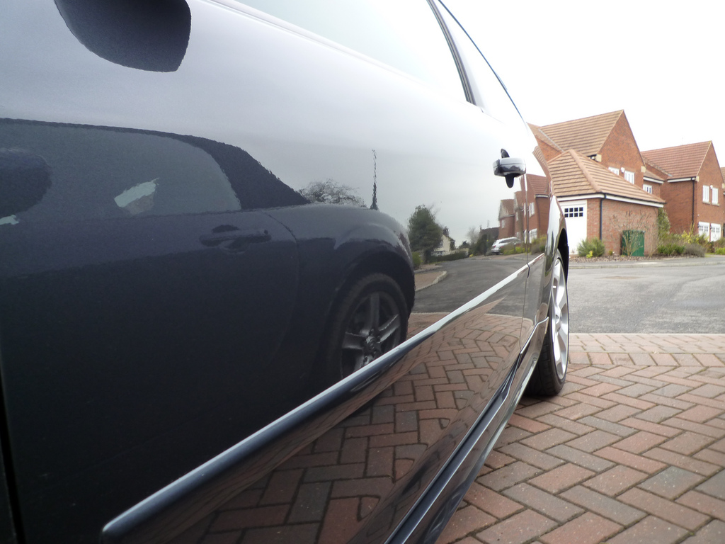

A few finished pics, but unfortunately the lighting wasn't the best :(

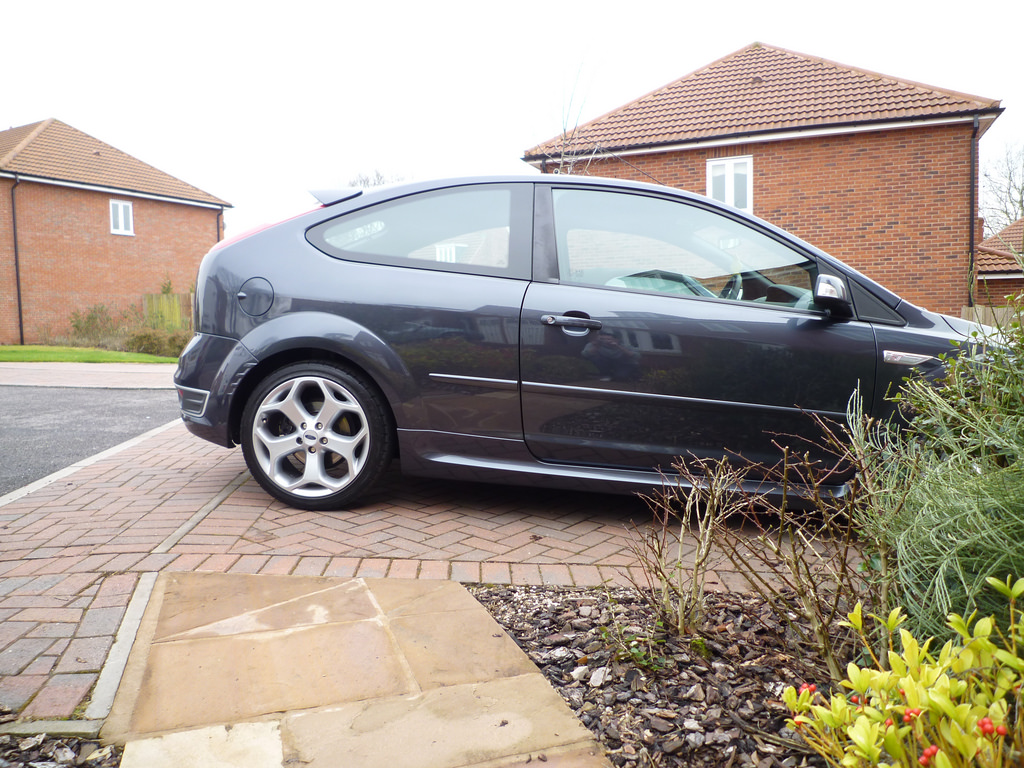

Few more pics for you all to look at that ive taken today. Cant stress how good a job Russ has done on the car. Would recommend him to anyone. He worked his sack of yesterday as well. He really did look fucked at the end of the day lol.
