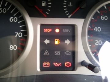

One day my 172 would not start, and since has been parked up on my drive for the past 2 years. :cry:
Now I have posted this thread in the main discussion section as I am not looking for a solution to the cars starting issue, I am looking for your opinions on what you would do in my situation.
Long story short I have the dreaded 'solid red' immobiliser light displayed when the ignition is on. I have tried multiple fixes to no avail, I have scoured this great forum for help and tips, but everything I have tried has not worked.

From previous research I thought the general reason and solution for the issue you have is replacing the UCH behind the dash. That seems to be the main cause of immobiliser and non start issue. I take it the car does not even turn over?
Have you tried the basics such as earth straps, key battery, main car battery, fuse, relays etc just in case it is something simple.
A secondhand ECU, UCH and keys can be picked up pretty cheap with all the sports being broken.

Op iv not read up on what fixes you have tried already to sort the immobiliser issues but about 6 months ago I had the same problem.
I tried all the suggested solutions from here regarding relays,Uch and the like but nothing solved it.
I eventually traced it to the 12v supply cable to the Ecu being broken/damaged somewhere, it was only reading 6.8v so I ran in a replacement wire and it has started no problem ever since.

I sold the car in the end 😞.
Sold the car to a friend who is a mechanic, he stripped back a load of plastic covering the wiring loom and found a break in two wires (purple and cream wires).
After fixing the wire break the car fired up into life!
So the good news is she did not get scrapped and lives on.
