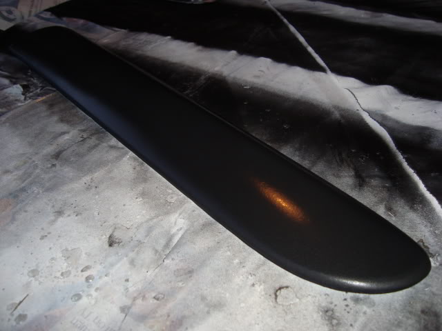

Here is one section with one coat of Laquer on:
I've put two more coats on since then and am going to leave it and see what it turns out like tomorrow.

I'm guessing to not getting a nice smooth outcome on the clear?
Eyeing the pic you posted.
So removing 'orange peel' and buffing/polishing it to high gloss again.
You could use Autoglym 03 Paint Renovator and finish it of with Autoglym Super Resin Polish.
