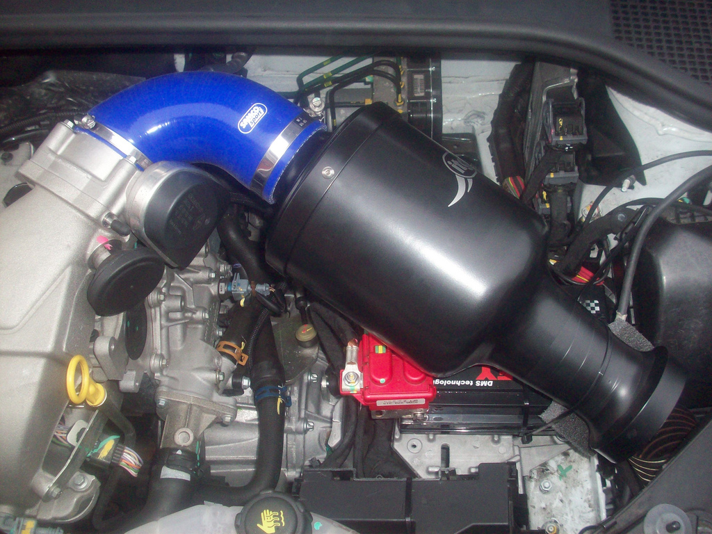

different car i know mate but i've done a couple of custom filter setups on my 197 using a smaller battery to create some extra space and an ITG maxogen,tested them both on the rollers at RS Tuning,a few pics
this setup ran more mid range torque so i stuck with it as thats where the car neededs it
maxogen setup by scott1532, on Flickr

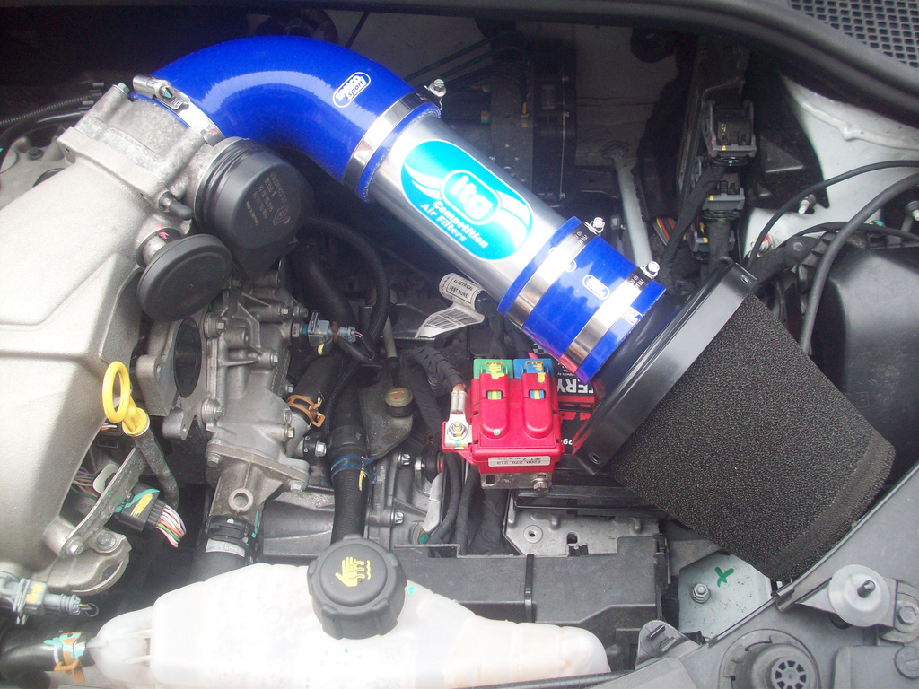

this setup ran a few more bhp on peak power and sounded mental,might go back to it one day
open cone setup by scott1532, on Flickr

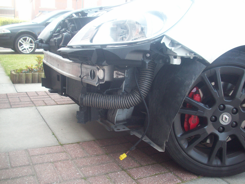

and i also ran a CAF from the lower front grill
plenum temps by scott1532, on Flickr
hope this helps,i think there are plenty of ways of making a good filter setup cheaply
