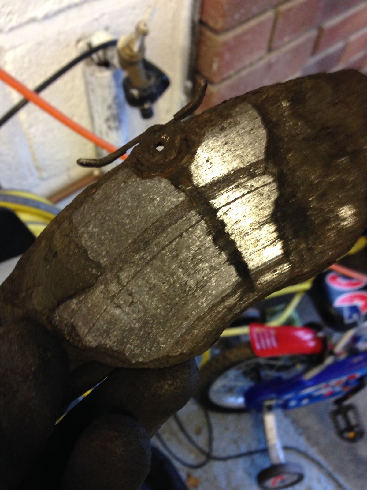

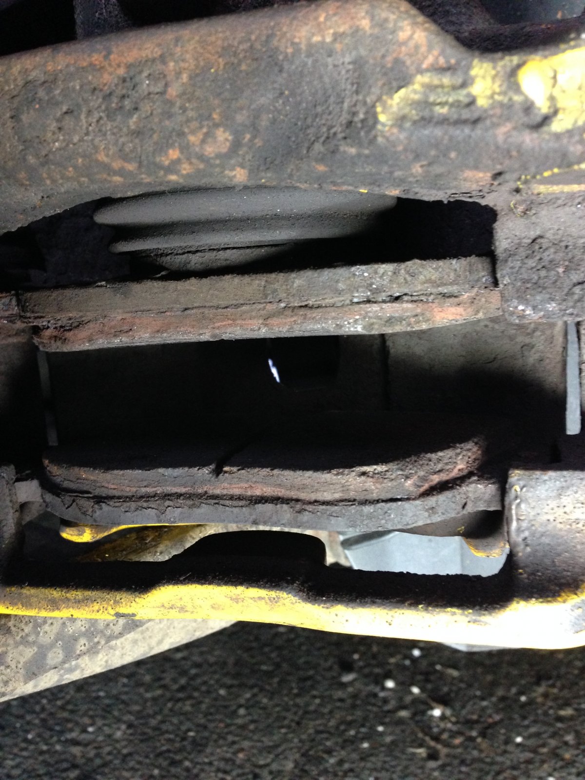

Do my front pads have another trackday left in them?
Car  172 Cup
They are ds2500
Keep the pads in the first picture and get some more 2500s as the inner, piston side always wears quicker than the outer so you could rotate.
