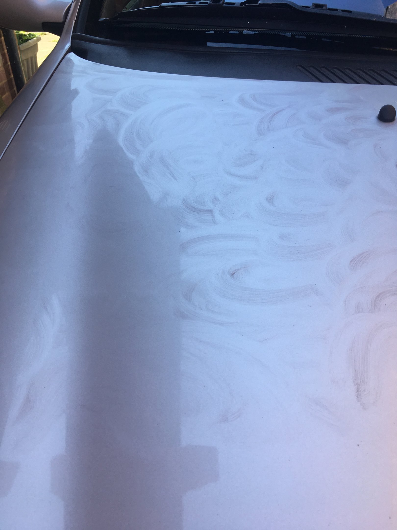

Just got some but its quite hard and hardly any wax gets picked up by the foam pad or your fingers, read a review that said something like that might of happened. What should it be like?
@Chapppers11
Not sure what qd is mate, am new to all this :) The wax does apply, Im just not sure if enough goes on the car, should it be coated on thick or just a thin layer, do you rub it in so the surface is just coated and leave it till it dries, or give it more of a working in?

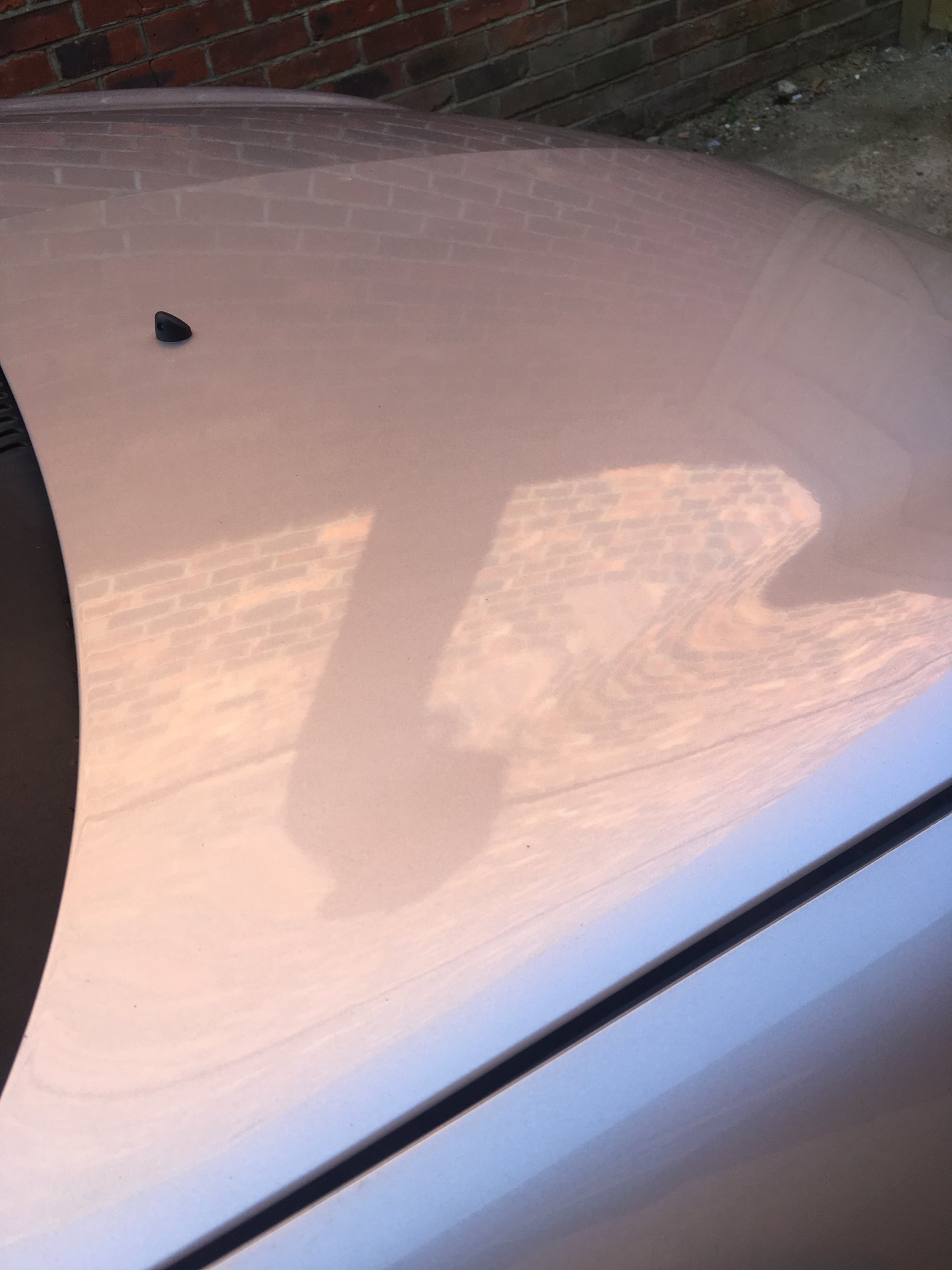

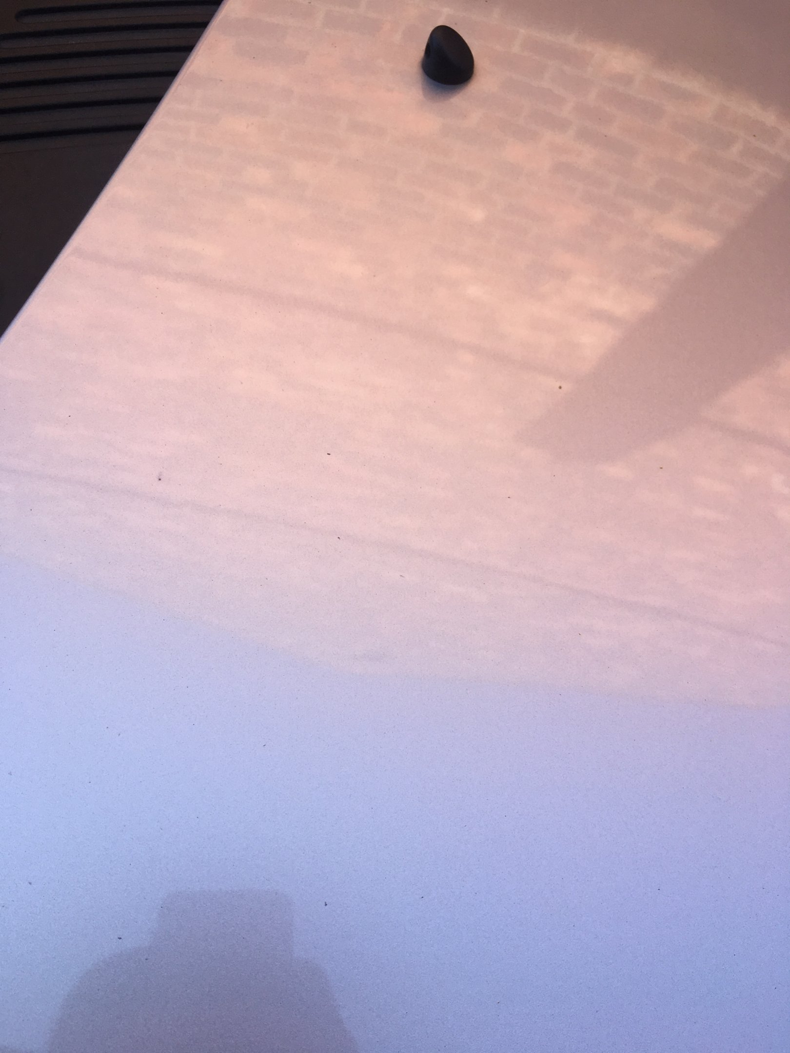

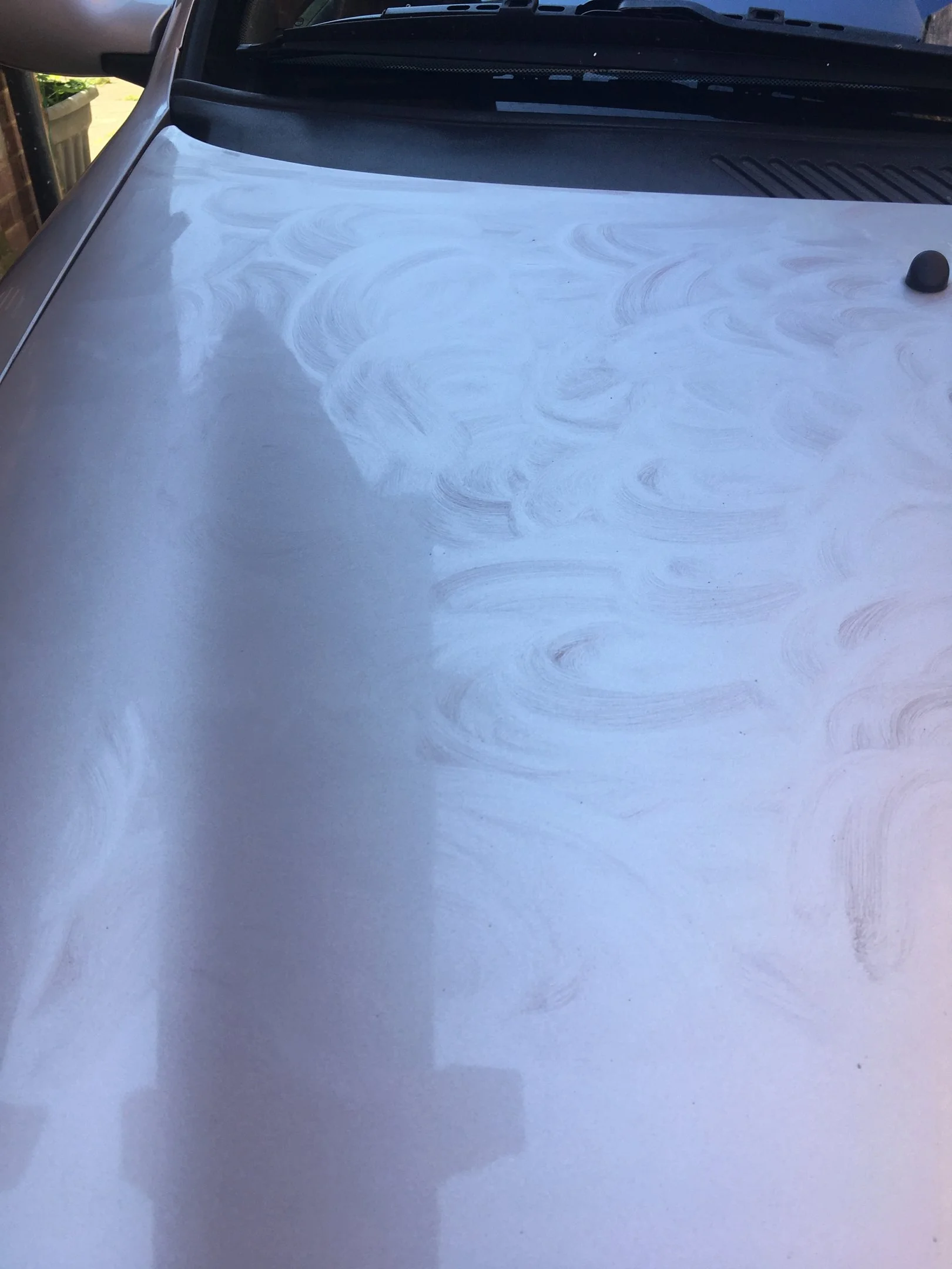

I waxed this panel, suns on it

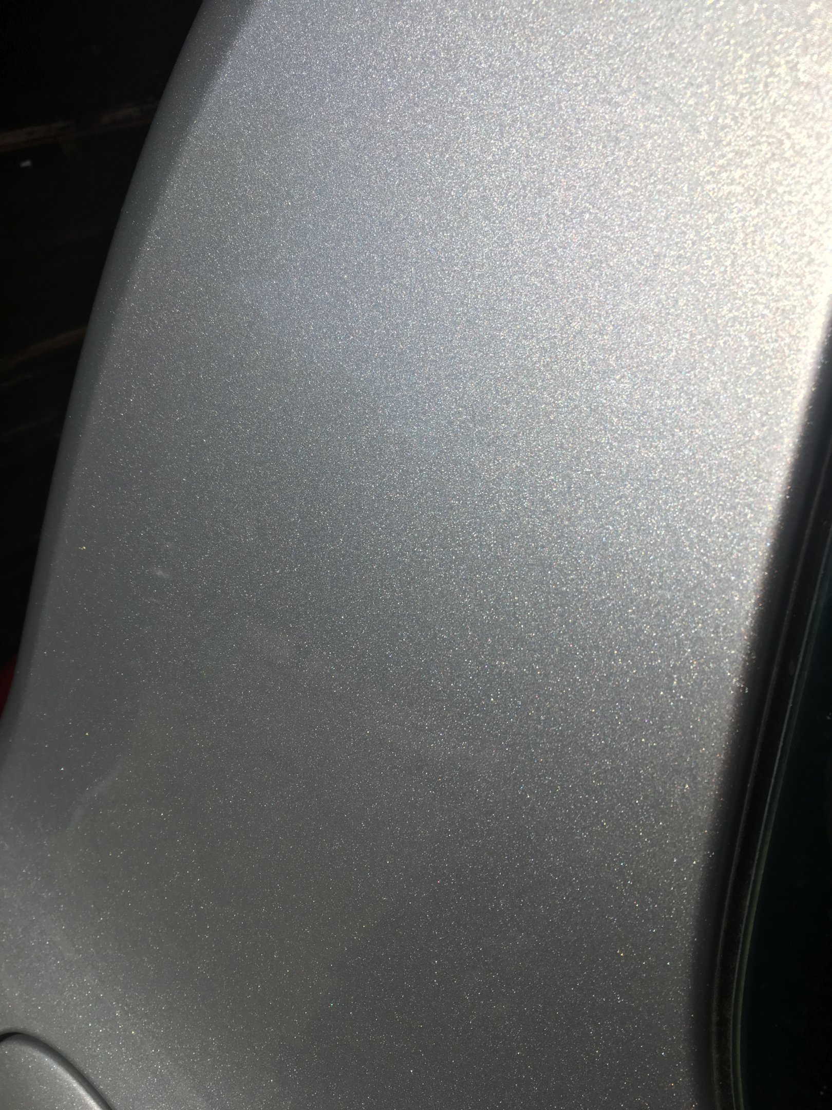

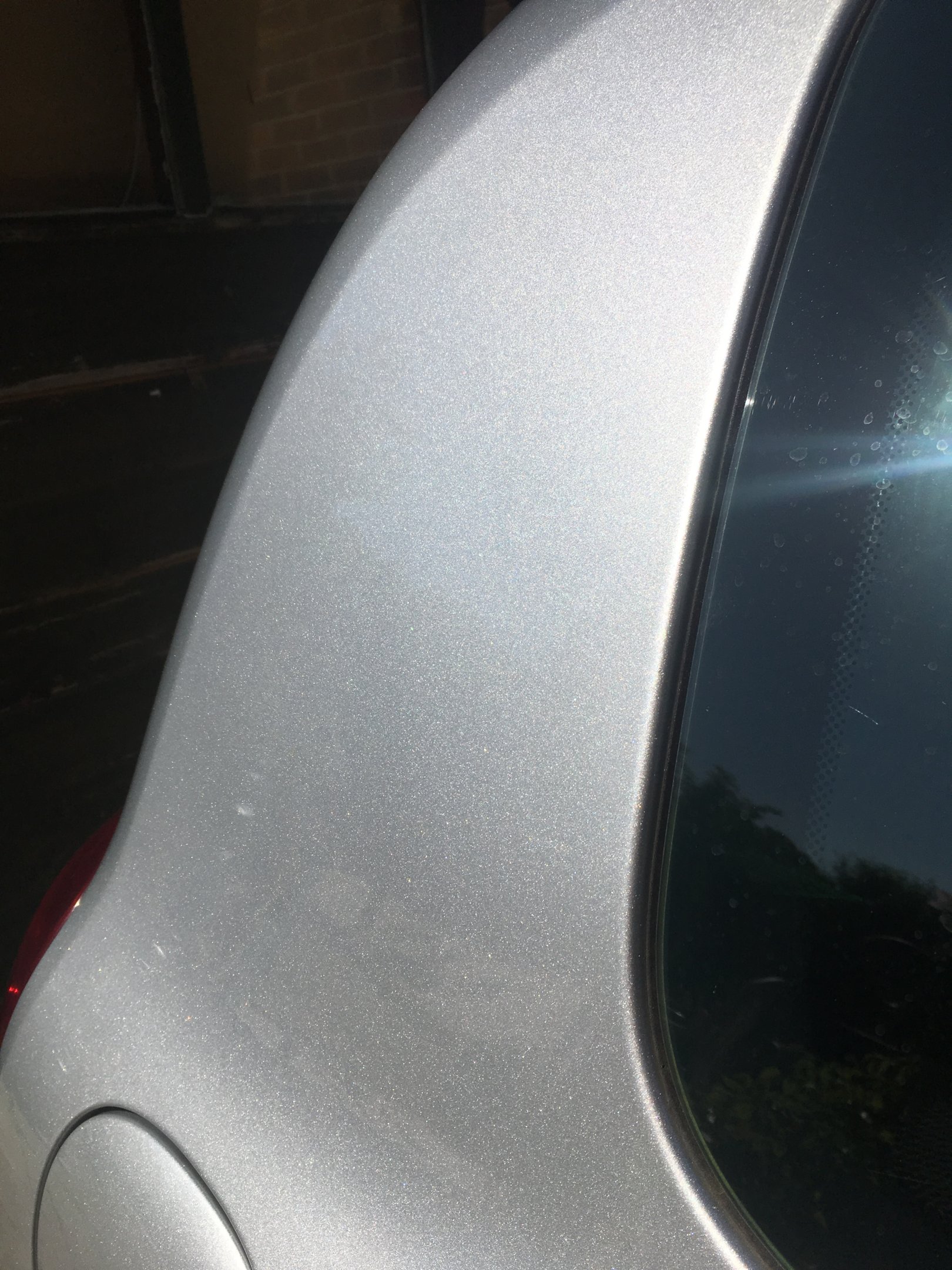

This is just washed with dodo sour power
Camera can change things though..

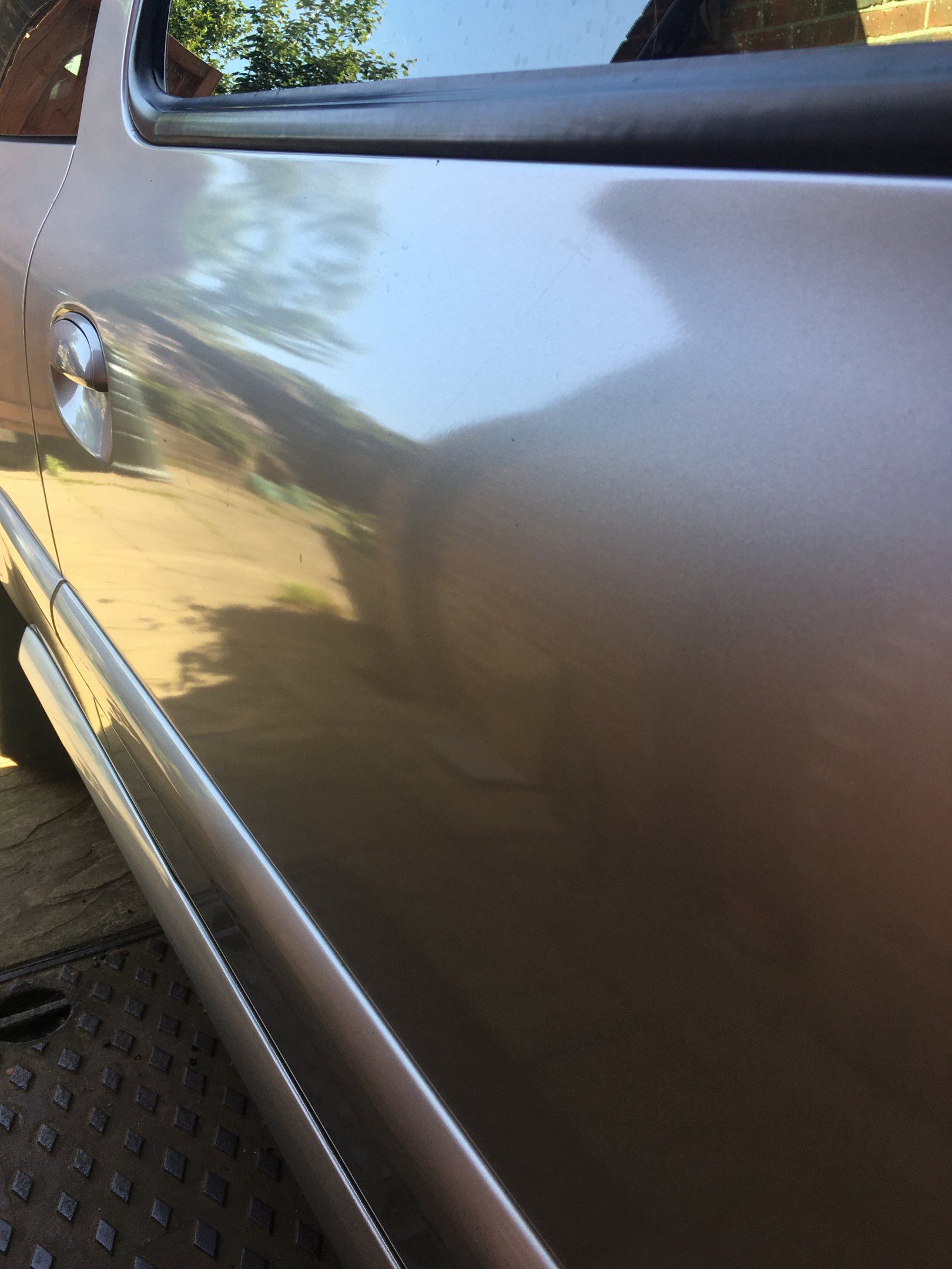

It was a bit marked when I got it, some bumper rashes and small marks, not too bad. A bit after owning it it was key scratched in a lot of places, they are real small like it was done with pennies, think they lit a lighter on part of the roof as well, ever since then I cba to try and keep it nice and clean, its just miserable lol

I’m assuming you didn’t decontaminate the paint and all that jazz before you applied the wax?
Yeah just a basic wash with a hand mitt, wasnt expecting loads but dont know the proper process to getting a good clean! I have autoglym magma so like a iron x stuff that can be used on bodywork, so I would use that after wetting the car, then wash off then wash with shampoo with mitt, dry, then I guess its polish but if I just use the wax will it at least give a lasting coat?

To a degree yeah.
Wax is only as good as how well the paint is prepared.
If looking for a Sunday blast,
Wash
Some tar remover
Wash
Autoglym srp
And a couple of layers of wax.
There is other stuff but that’s a decent start for not lots of money.

Less is better because it could end up a ball ache to remove. Lightly swipe your finger through a panel you’ve applied to and you’ll see if it’s covered it.
