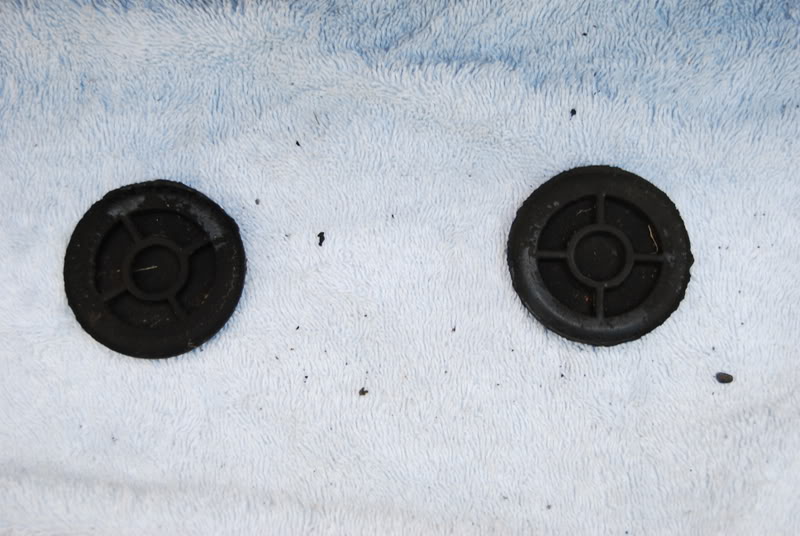

i just un-done the seat, took it out, and theres 4 rubber washer things. About 20mm high, i just pulled them out and put the seat back in!
  rps13
no not really, the rubber washers dont hold anything together. you can replace them with 2mm metal washers or just cut them down if you're worried.

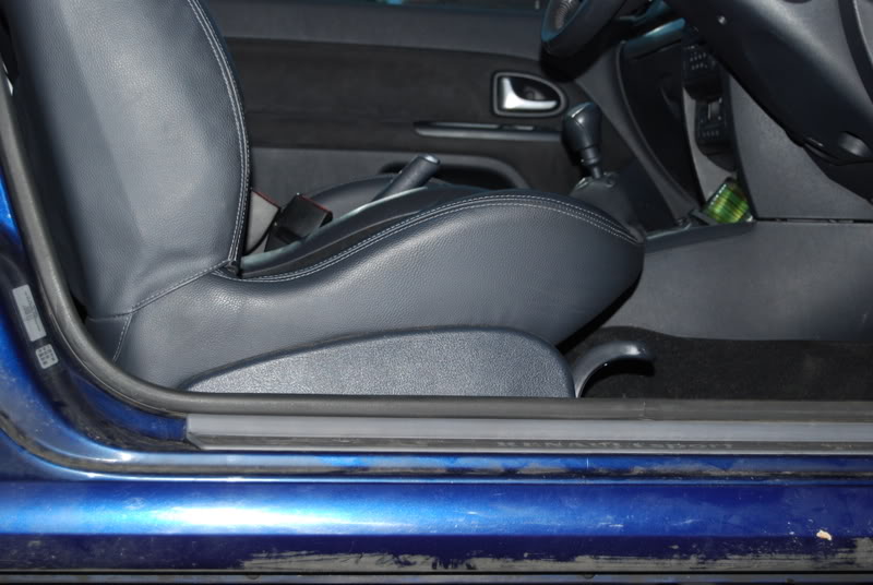

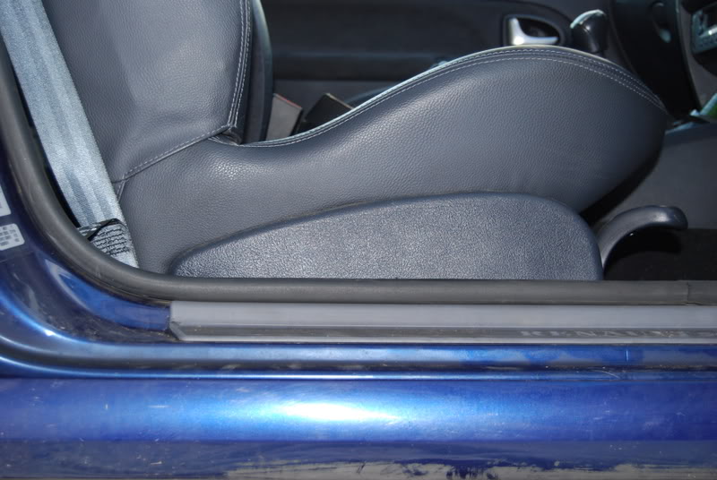

Taken mine out today, Noticeably lower. Really good mod though for the standard seats.
Dont expect to be sitting on the floor, about a inch max lower

Pics after and before would be great.. ;)

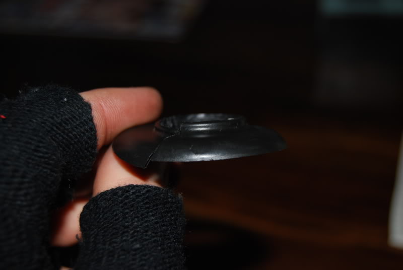

Crispy there under the subframe thats the rubber washer lmao :) easy to remove,

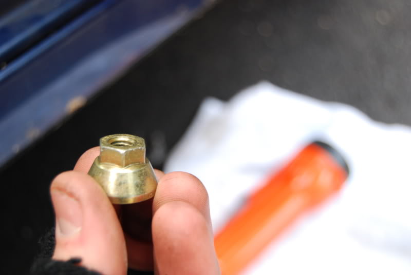

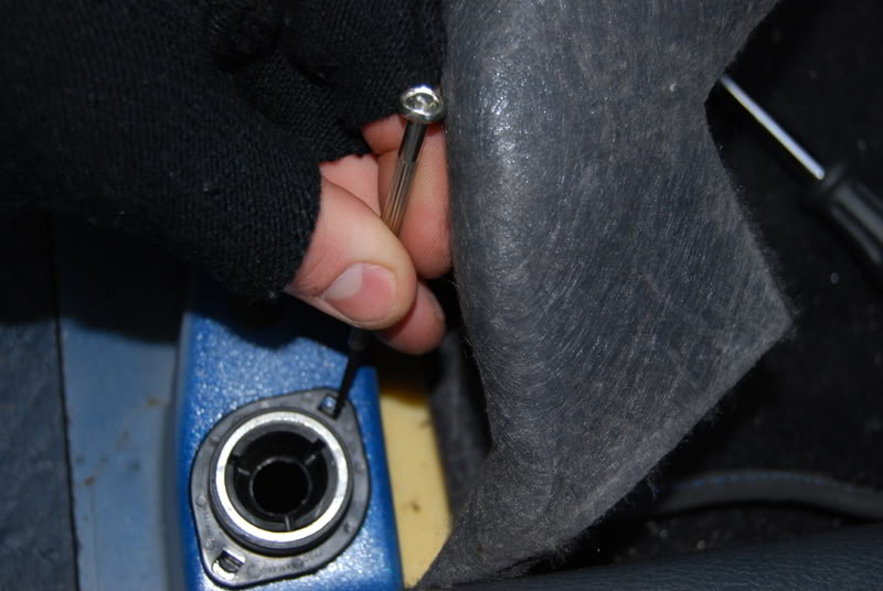

yes mate you are looking for these bungs
remove and then remove these bolts:
the other two bolts are in the exhaust channel, there are two bit circular cutouts you will have to feel for with your hand.

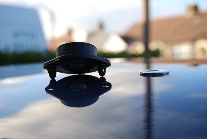

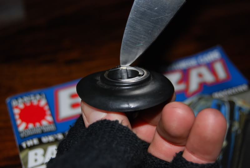

take out the mounts:
wack these back in with some washers and your 15mm lower exactly.
you will need a long 1/2'' socket for the bolts

Ah so washers are needed then? What size did you use? Just to check ive got some of the f*****s before i get the seat off.
  rps13
you can use any old washers as long as they have at least a 10mm internal diameter.
the reason i used these is to stop the runners and rivets fouling on the carpet.

Why do you need to take out the metal bit from the visible plastic circular thing. Do you not just take out the mount under this?
