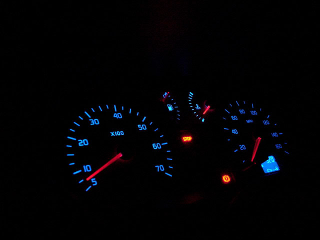

a few people on here have kept standard dials but changed the led's instead!
imo the standard dials with blue leds looks sweet :)

same here, are they surface mount LED's ? if so i mite get some and have a go @ work
Yep, reletively easy to do if you can solder them ok. Its an expensive mistake if you screw up.
  fastest passat in't world
Blue dials are easy enough but making the needles light up red is going to be difficult.
As standard, the clio uses 6 LED's to light up both the needles and the digits. You would need to block the blue light to the needles then fit separate red led's onto a new circuit for the needle illumination.
Possible but will take time and patience.
well i am an apprentice electronics engineer so i may have a chat about it at work tomorow and see whats what.
