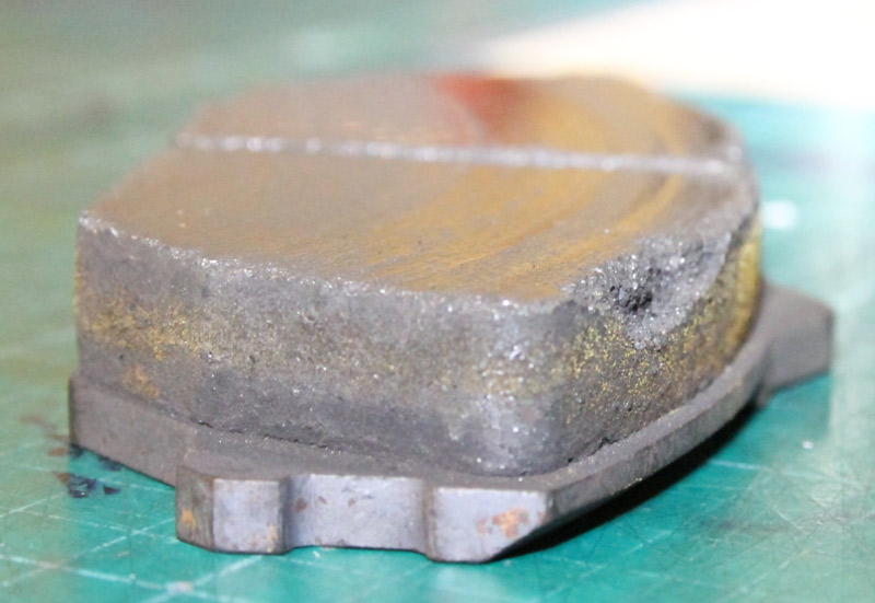

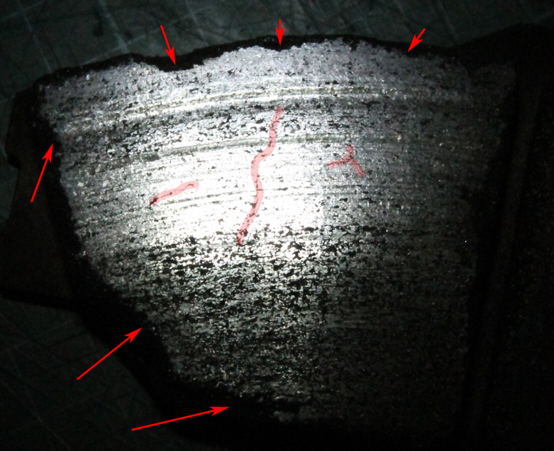

After a second opinion on these pads please... They have done one track day and a few (maybe 100) road miles. Box specified no bed in required but I did the usual 60-15mph medium stops a few times to get them warm and scrub them in to the disc. They work perfectly well but the edges seem to be crumbling (can pull bits off by hand) and there are some cracks running through the material.
http://www.tartybikes.co.uk/media/car/clio/pad1.jpg
http://www.tartybikes.co.uk/media/car/clio/pad2.jpg
Retailer says it's nothing to worry about:
"this is perfectly normal, the material is prone to chipping, hence the foam in the box when they are new. Micro channels in the material is also common owing to the material make up and the graphite element to it."

, so I can't really understand the cracks. The last set of these I had came off the backings, so maybe I'm being over cautios?

Yeah, my RC5s did exactly the same (these are RC5+) - I contacted K-Tec before buying these and they were adamant that the issue had been rectified, so fingers crossed...
I had a clean cracks right through the middle of several set of OE pads, still worked OK but I'd be worried about all the crumbling
We had a dodgy batch a while ago, was a change in their production method if I remember. Obviously that chipping you see isn't ideal, but with an eye kept on it, it should be ok, and the bonus with the compount is you can run the material right down to near the backplate without any noticable brake fade.
