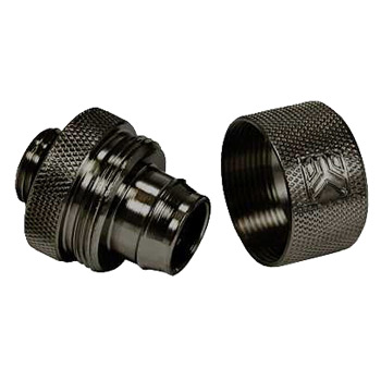

I went for the Phobya block, will see how it goes - I had the XSPC Delta 3 before but I didn't think it was all that good tbh.
Should be all back together and done by tomorrow night hopefully. Also this is the first time I've used compression fittings so will definitely be doing a leak test minus the innards lol

I guess if your only doing CPU cooling things are pretty loose, its when you come to do GPU and MB cooling on top you need to start using 45s and 90s. You shouldn't have any problems with the straights.

Finshed putting it together just now. Compression fittings are loads better... just a few more braiding/tidy bits coming and it's done
