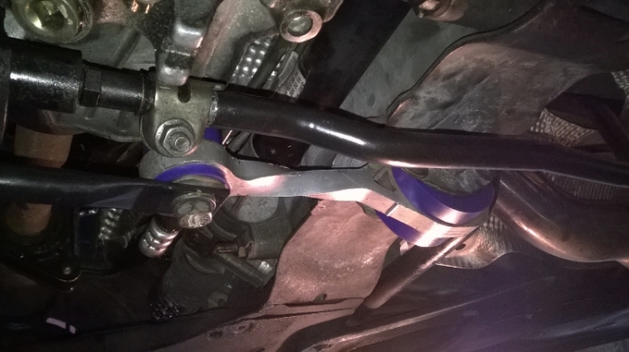

This is my dogbone fitted burt

Am I right in saying that the vertical bolt in the above picture goes into the gearbox? If so, it's possible that your gearbox has been replaced in the past with one from a ph1, hence the use of a non-twisted mount.
This is possible, the phase 1 f4r shares the same box as the Cup from memory.

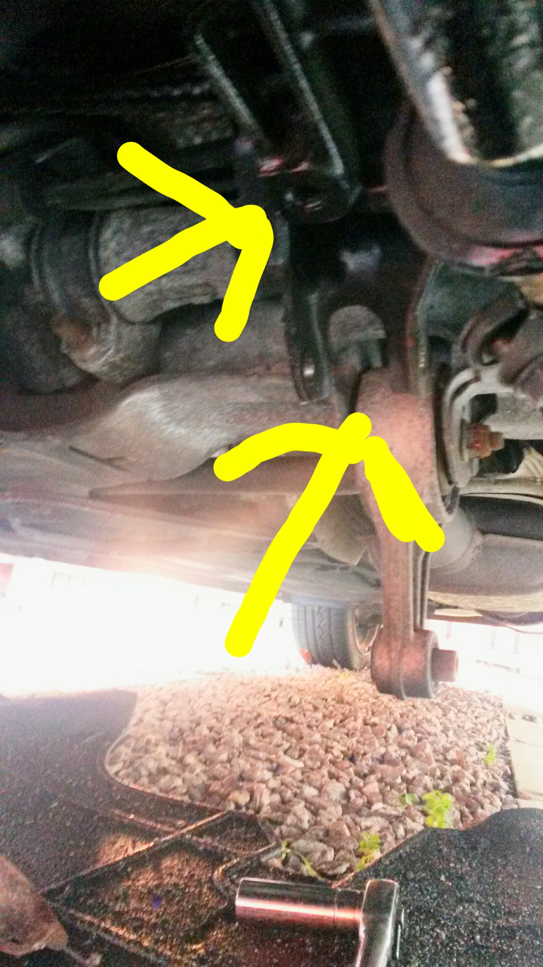

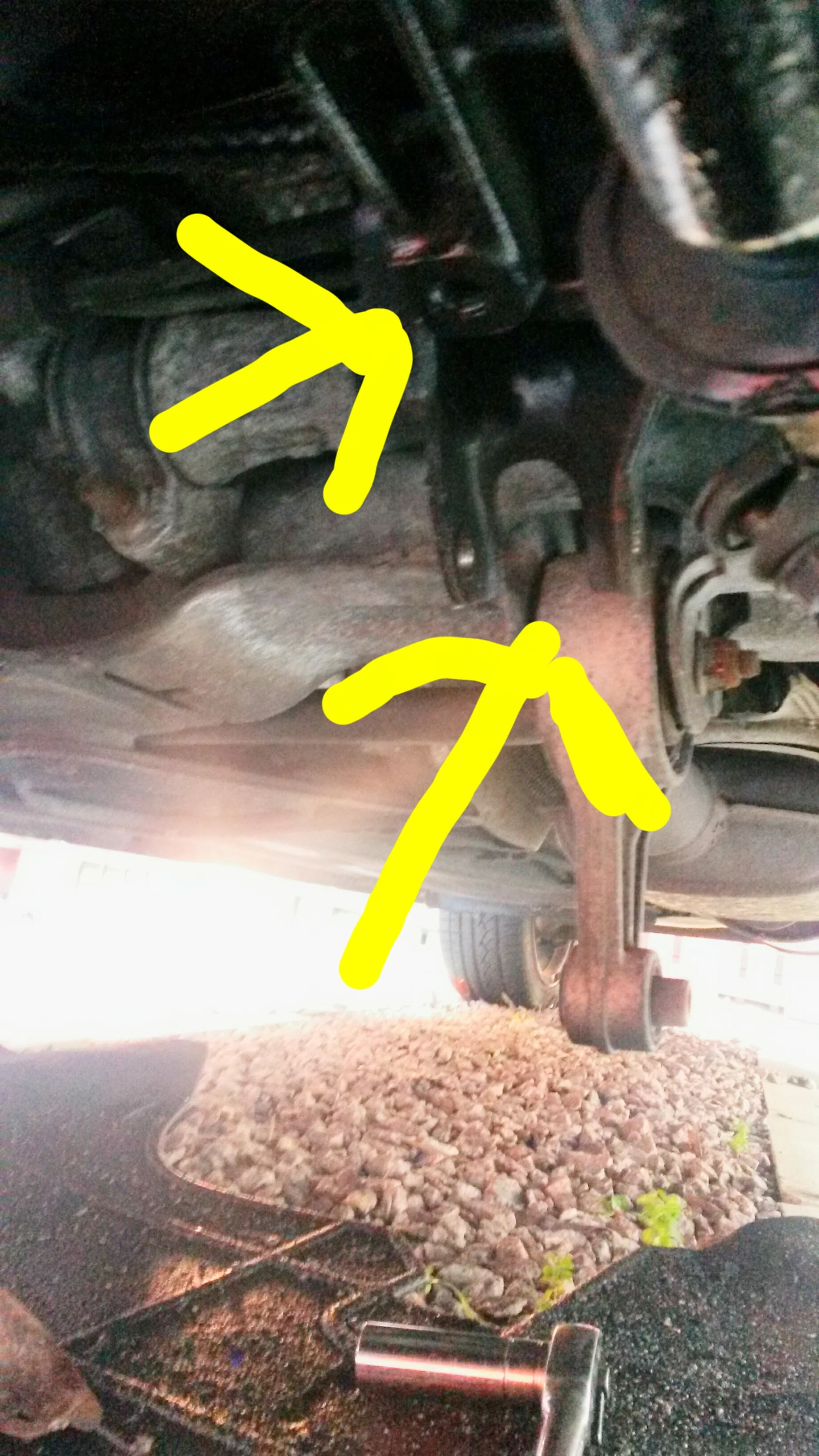

Yes thats what im thinking, my gearbox does have a threaded hole in the right place for the twisted mount though
  Renault Clio 172
The top left arrow points to the threaded hole, the other arrow points to the bracket the original mount bolts to
