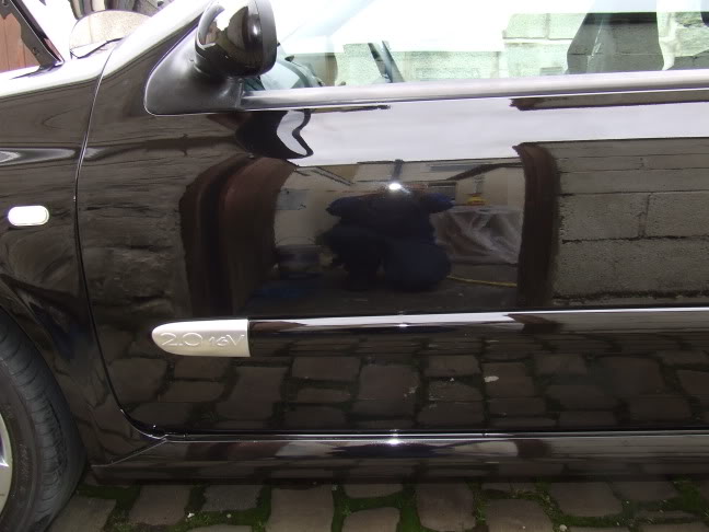

Hi the door trim with the 2.0 16V badge on is loose. How are these stuck on? The whole lot including the black bit.

yeah mine shake around a little too must be a clio thing-as far as i know they just clip on!

Yup, little 60p white clips from Renault, just slide on.

the clips are built into the strip the lock into holes in the body work, my guess is that somone has been trying to thieve them! It happened to mine and i stuck mine down with sikraflex
