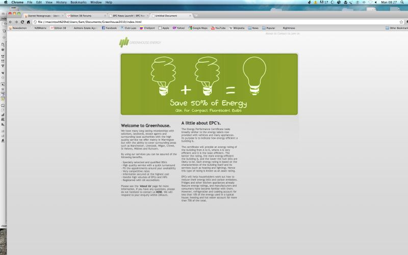

Here is a quick screen shot of the page in construction, ive re-designed it slightly since my last problem. The text below the main image is lower than the text next to it but I cant workout why, ive got my valign = top?
In dreamweaver....

Here is the code. Ive just bunged it all in.

  Cupra

Fixed it for you. I just copied the same line to both sections:
HTML:
<td width="275" height="366" valign="top"><p class="bodytext1"><span class="header1"><span class="header">
mas
  MK7 GTD & Mini GP
You hero, I will get that put in when im home! God bless CS!!
