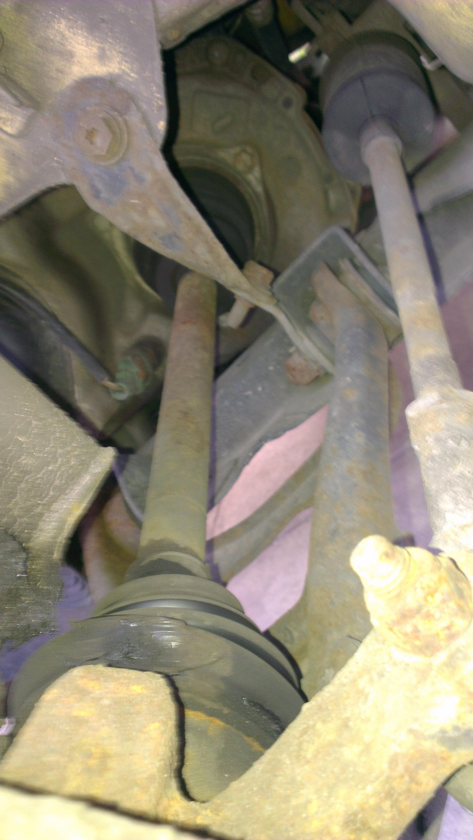

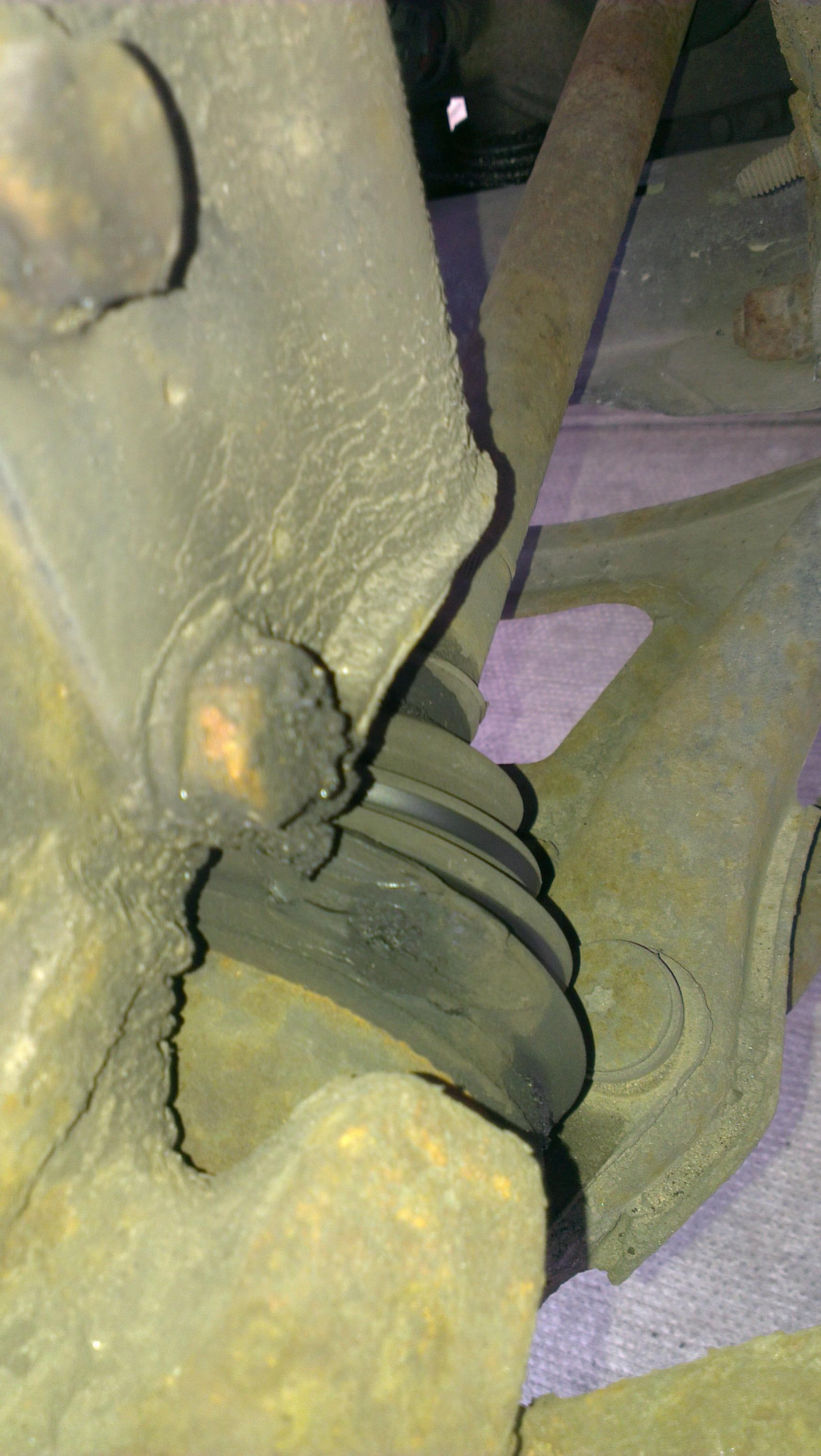

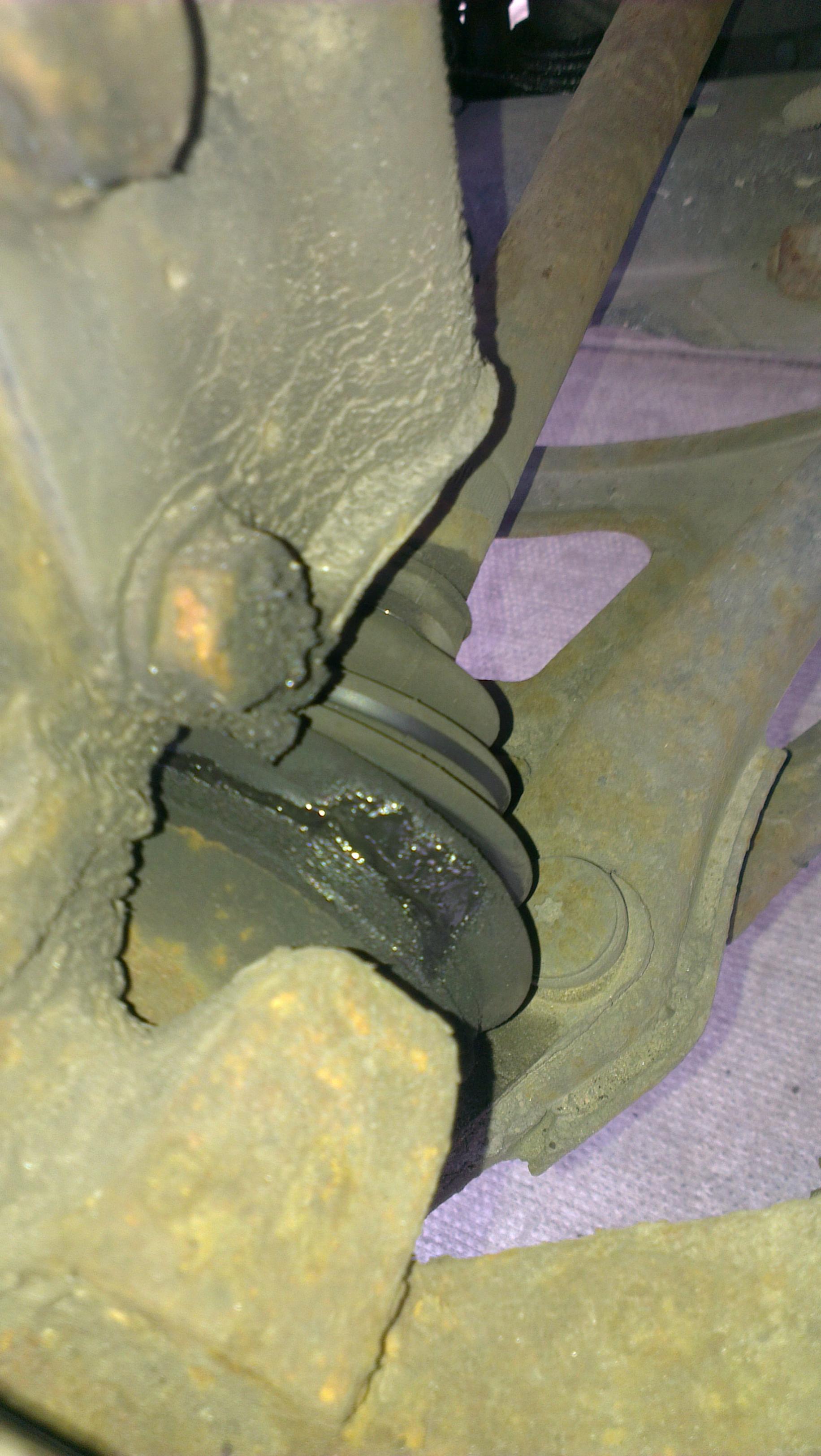

Got some pictures of what I'm working with:
Can clearly see one hole that has been botched by previous owner. That's split now. And there's also another patch of grease in first pic. So I'm assuming there is two holes. So that definetely needs replacing before MOT. There is a small amount of play in the drive shaft, accompanied by a knocking sound. So I would assume that it's toast and needs replacing.

only needs a new boot £65 is about the going rate including the boot from an independent garage.
can get a stretchy boot and cone for under £10 delivered easy to do your self take about 30mins to do

I was under the impression that if there is knocking and play in the shaft, then it's already gone past just a new boot. Don't want to spend money on a new boot etc and then it still need a new driveshaft. But obviously at the same time I don't want to spend the money on a new shaft if it's not needed.
Mindfook.
If its knocking you will need a shaft fitting shouldn't be move than £50 as for a shaft have a look on eBay wouldn't pay more than £60 sure I've seen them for £25ish on eBay recon
