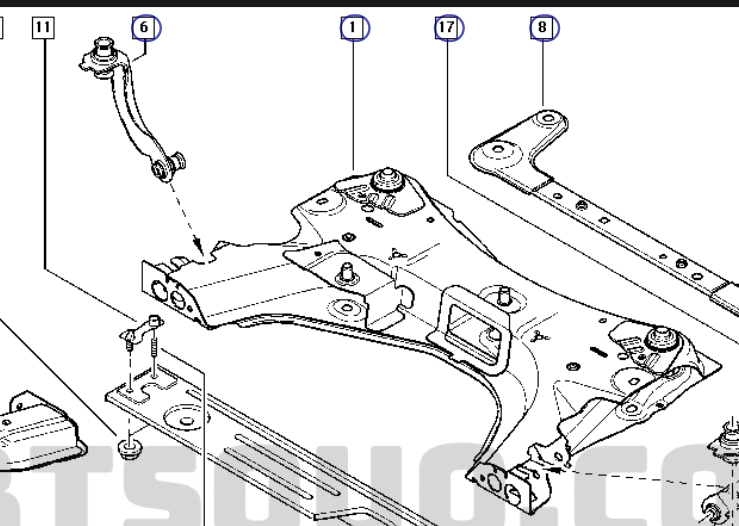

When replacing the control arm, I noticed the rubber on the side engine mount was completely knackered. I have the part number, but I can't find any information or tutorials on replacing it. I'm a bit worried that since it's an engine mount, it might be a right pig to do. It's the one labelled 6 - part number 8200127321. It might be less of an engine mount and more of a subframe mount. It seems easy to remove from the subframe, but I can't see how to remove the top bolt, and whether I would need to support anything.
Do you guys have any ideas about the knocking, and where I might be able to find information on replacing this part?

Interesting. That ones pretty easy to access so I'll give it another torque up this weekend. I really wish the horizontal bolt wasn't behind the radiator support bracket, else I'd go torque that again too. If I go to do that, I'll just replace the engine mount that that bolt holds on to cover my bases and report back.
