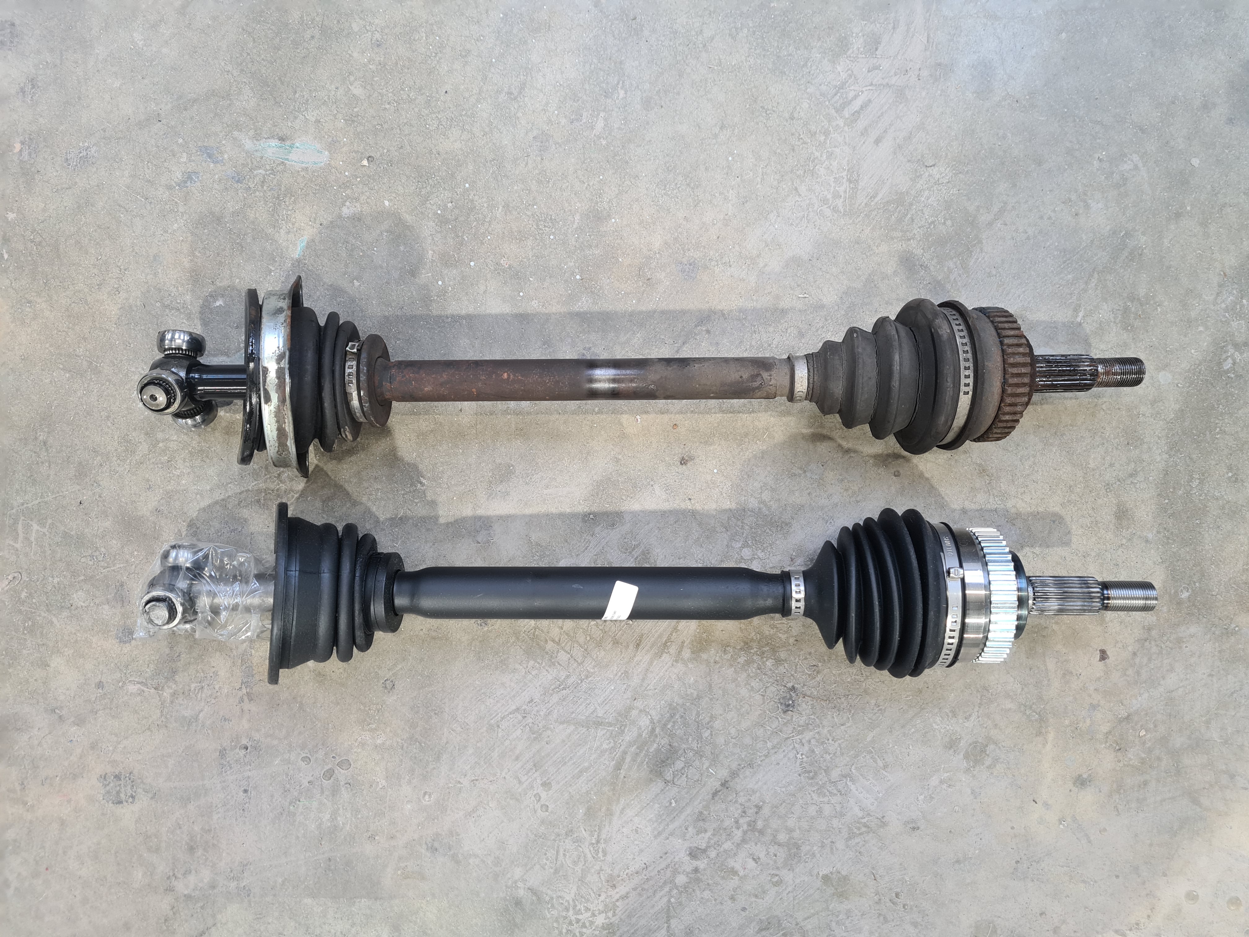

You won't get a brand new genuine one but Shaftec supply refurbished genuine ones. I'd highly recommend one of those.

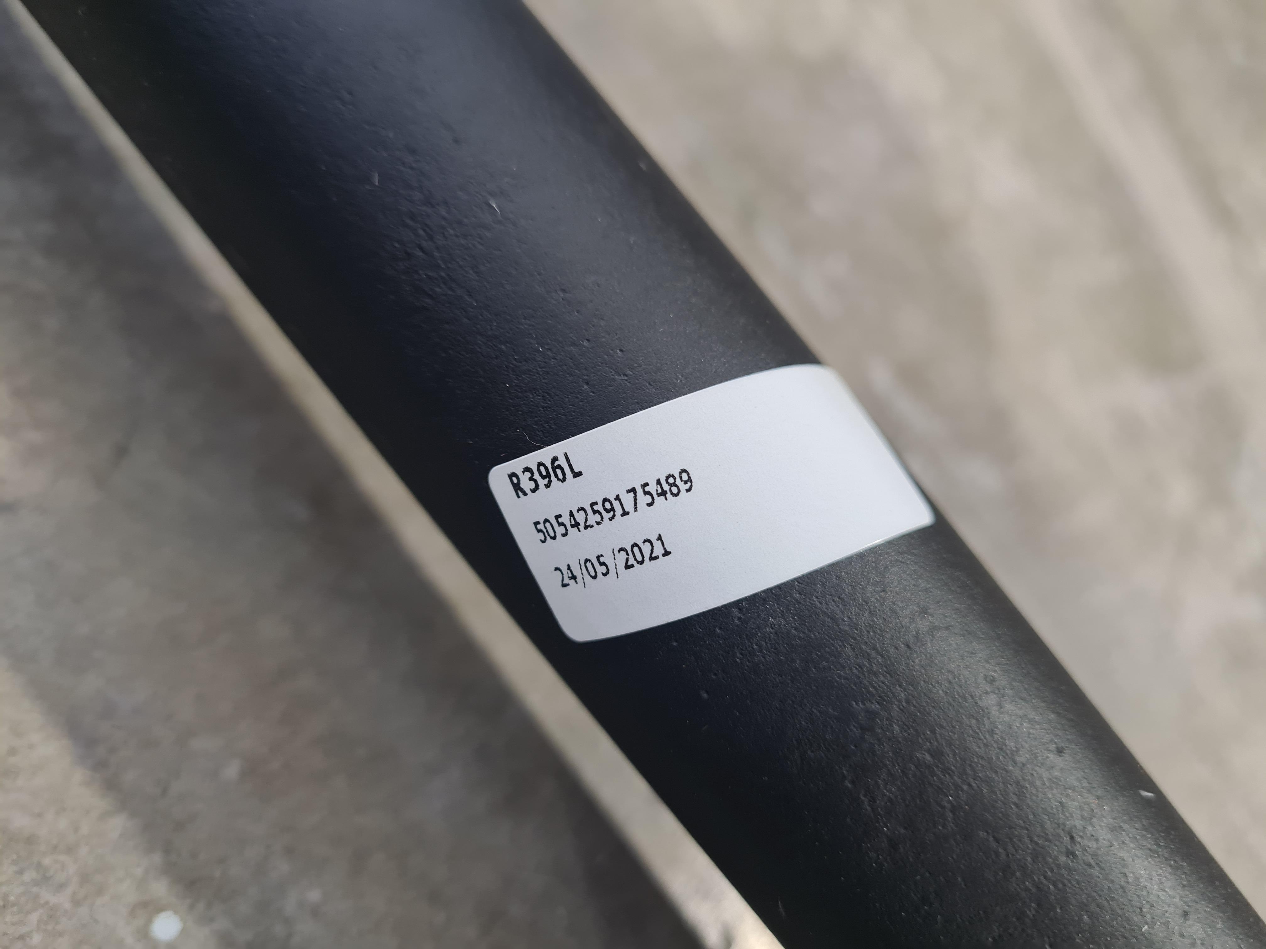

More money than the J&R but they're essentially a refurbished genuine part. You want R396R (OSF - Drivers) replaces 8200352042 and R396L (NSF - Passenger) replaces 8200372167.
I replaced my old j&R one with a shafted one and it was a better quality driveshaft, having them side by side.
