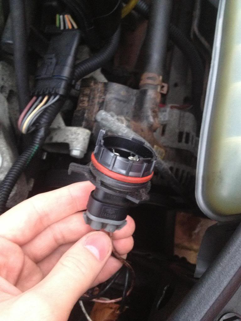

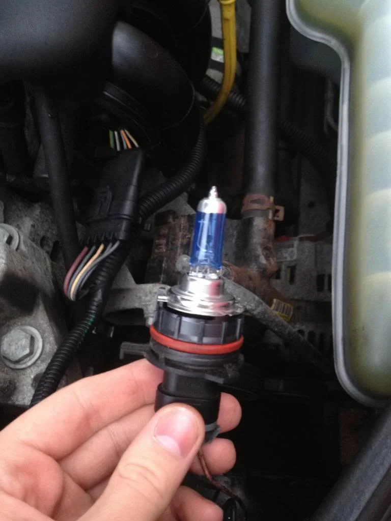

Can you get some pictures of how the bulb is wired up and working?

The problem with the dipped bulbs turning off is caused by the fact that you've got no fuse in the box for them both to be on at the same time. It won't be damaging to leave them like that (not sure what you have in the way of annual inspections in Israel but I don't think that'd be a problem either)
With regards to the holder, I'm not exactly sure whether they came with my bulbs or whether they came with the headlights. Maybe contact the person you bought your headlights from and ask if they still have the holders?

all is working now :)
i didnt need a holder, i just hold it with wire and its holding very well !
