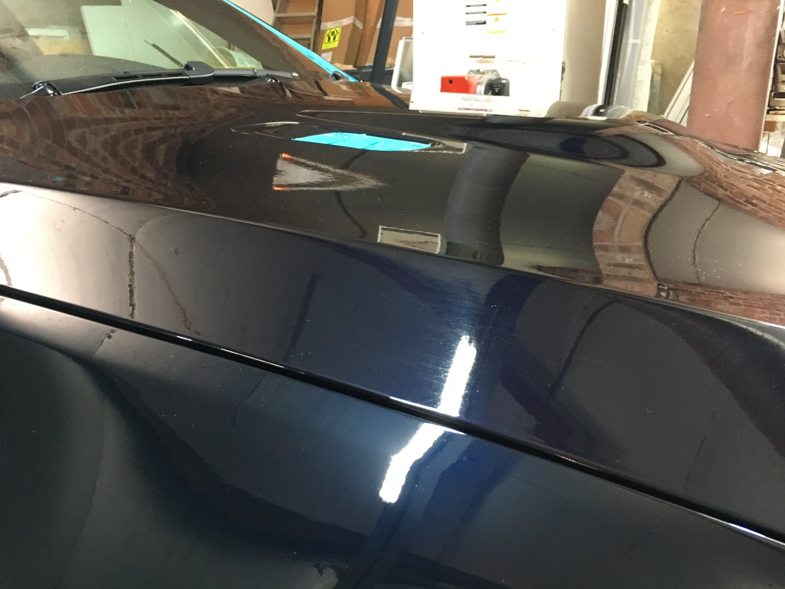

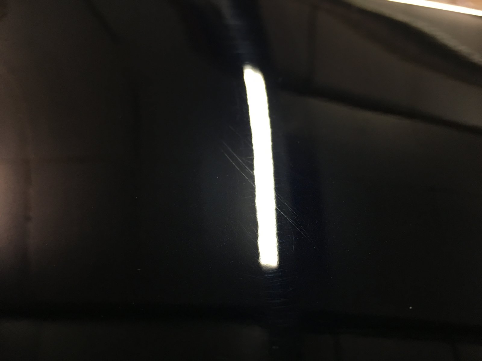

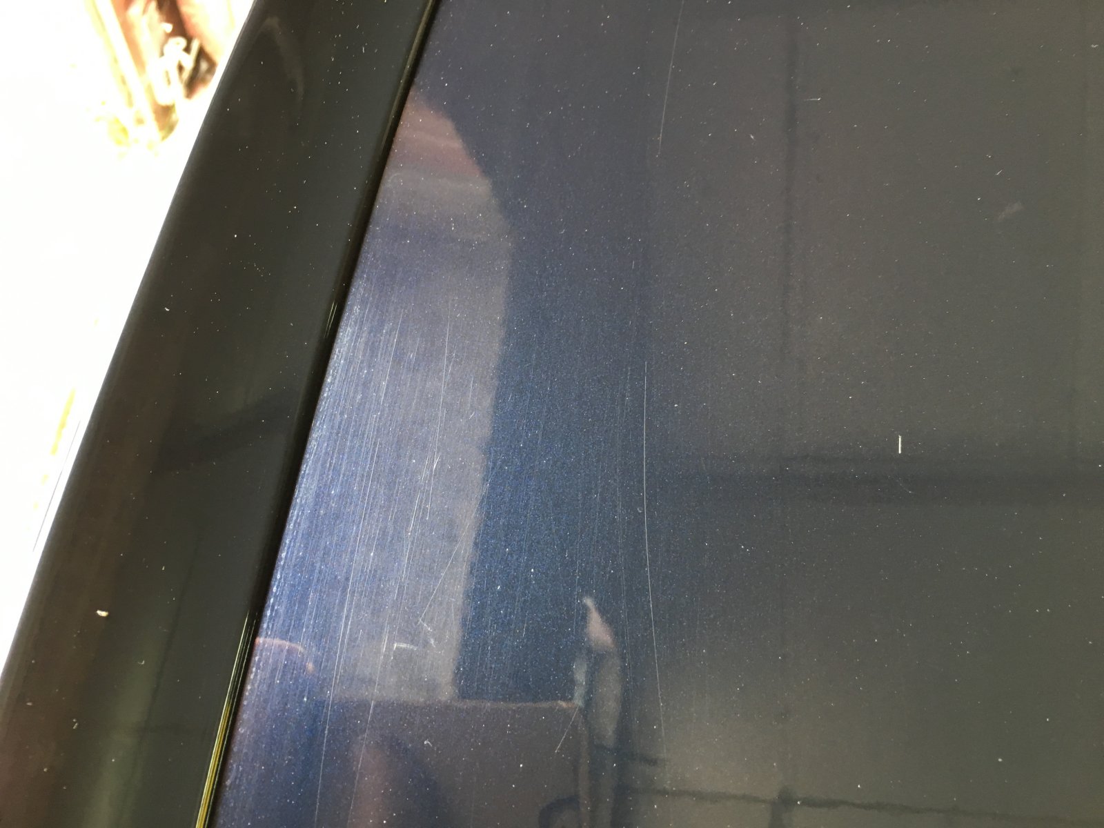

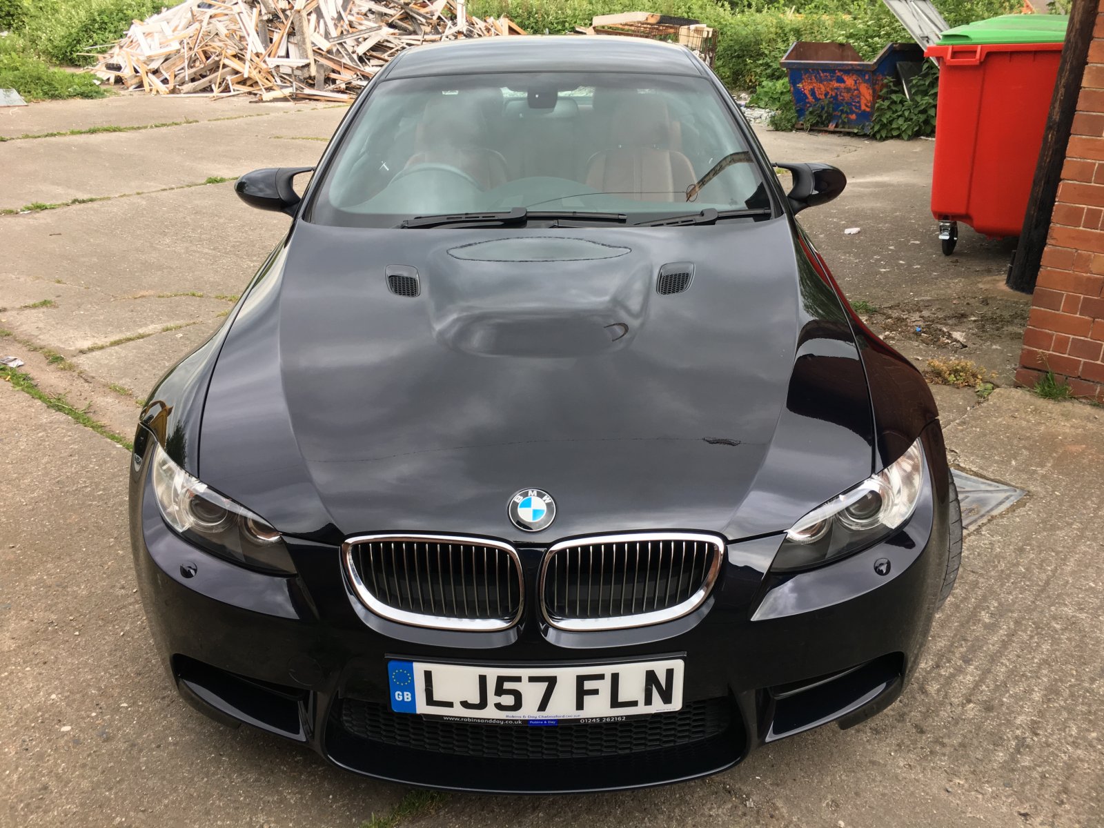

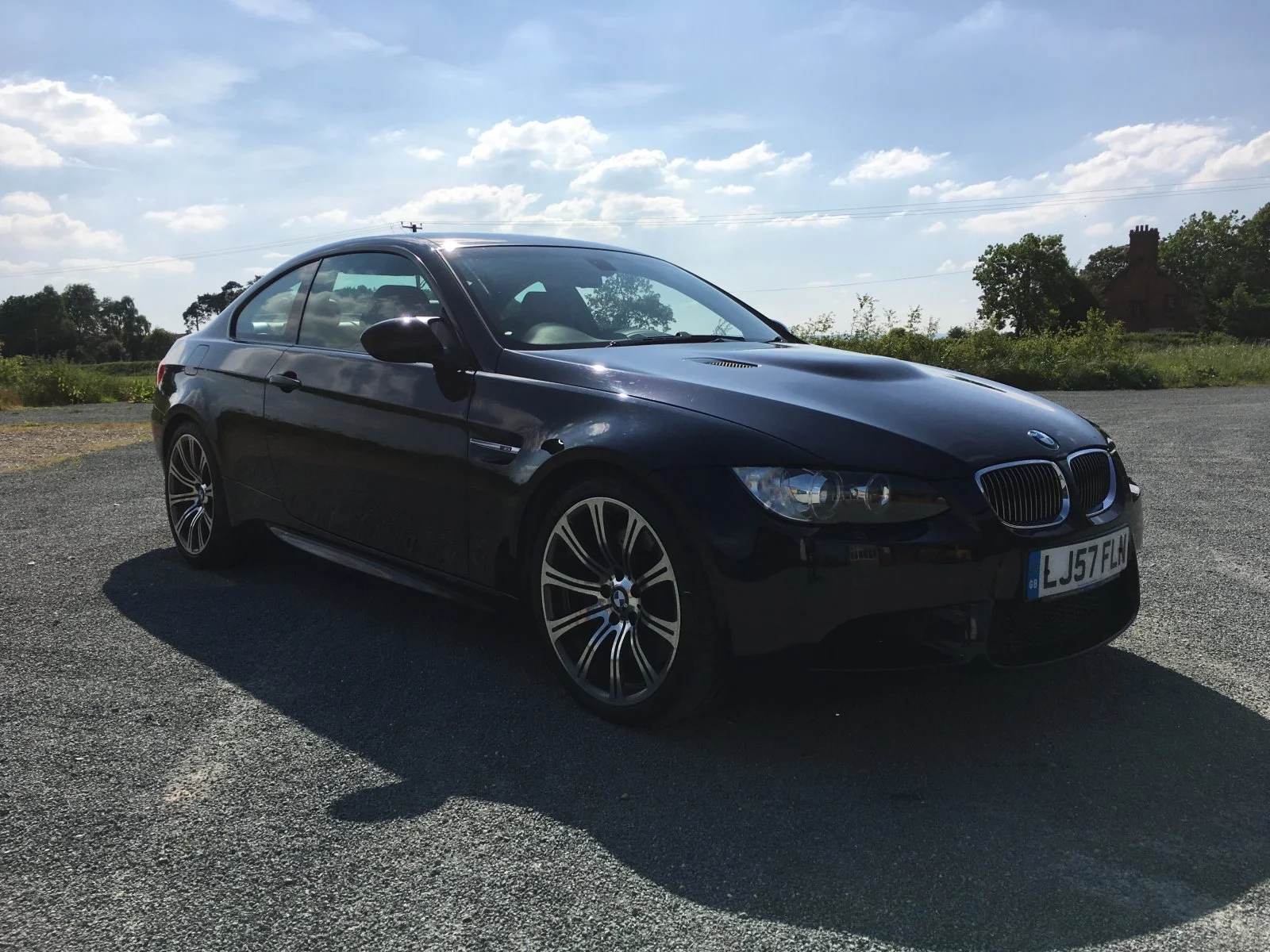

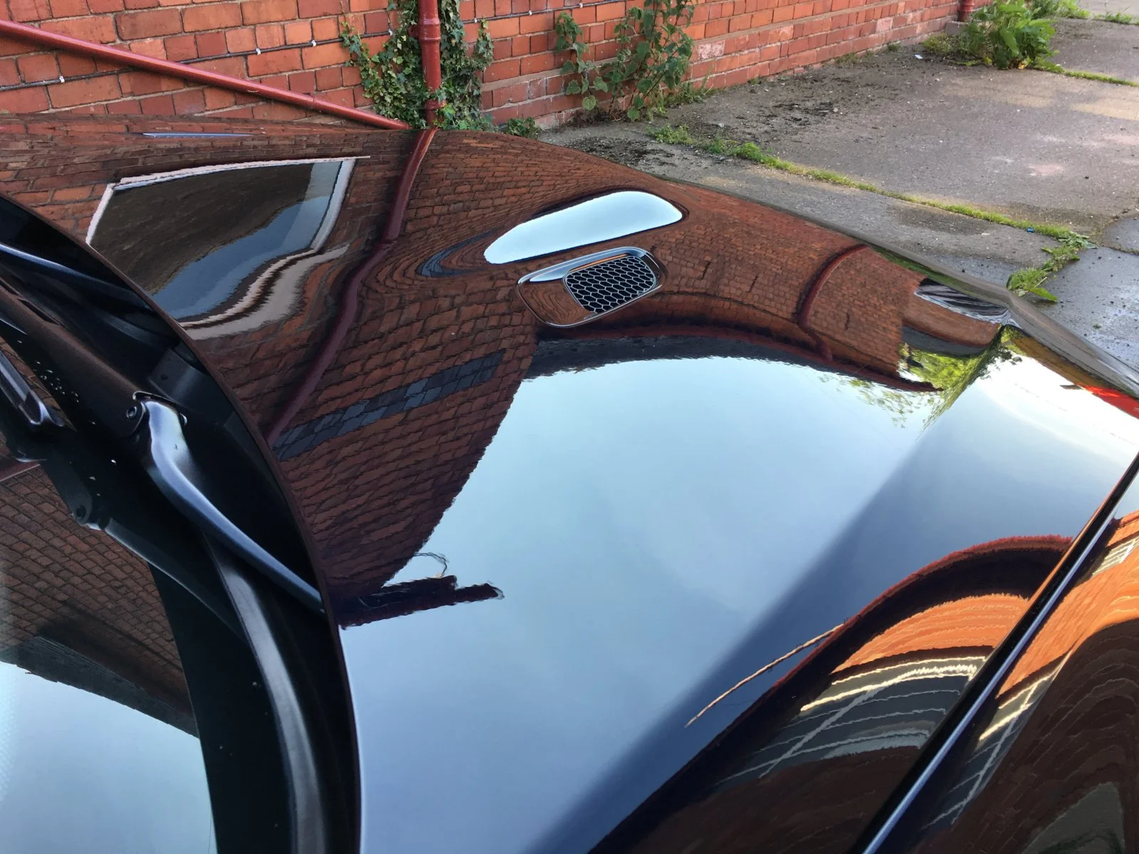

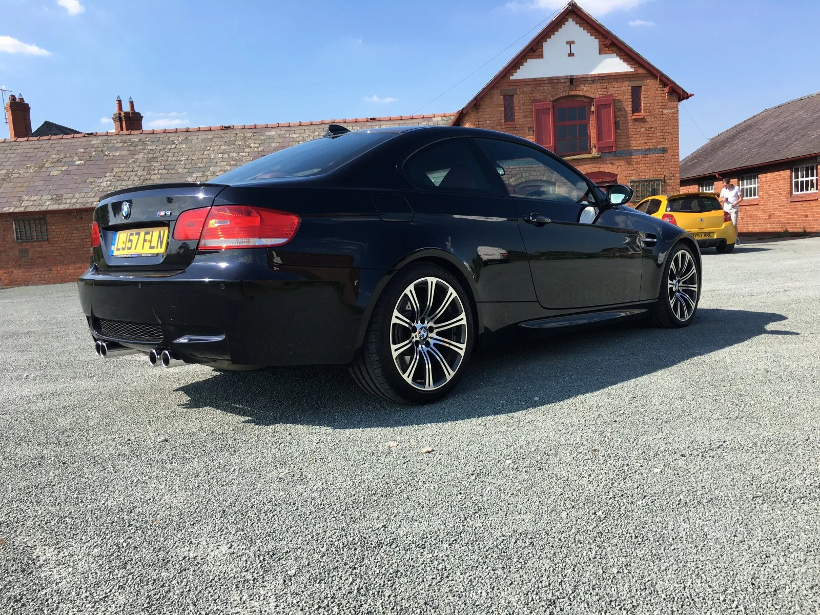

I was asked by a friend to give his M3 a going over to try and remove some swirls and scratches from the bodywork. The previous owner looks to have been quite aggressive with the cleaning.

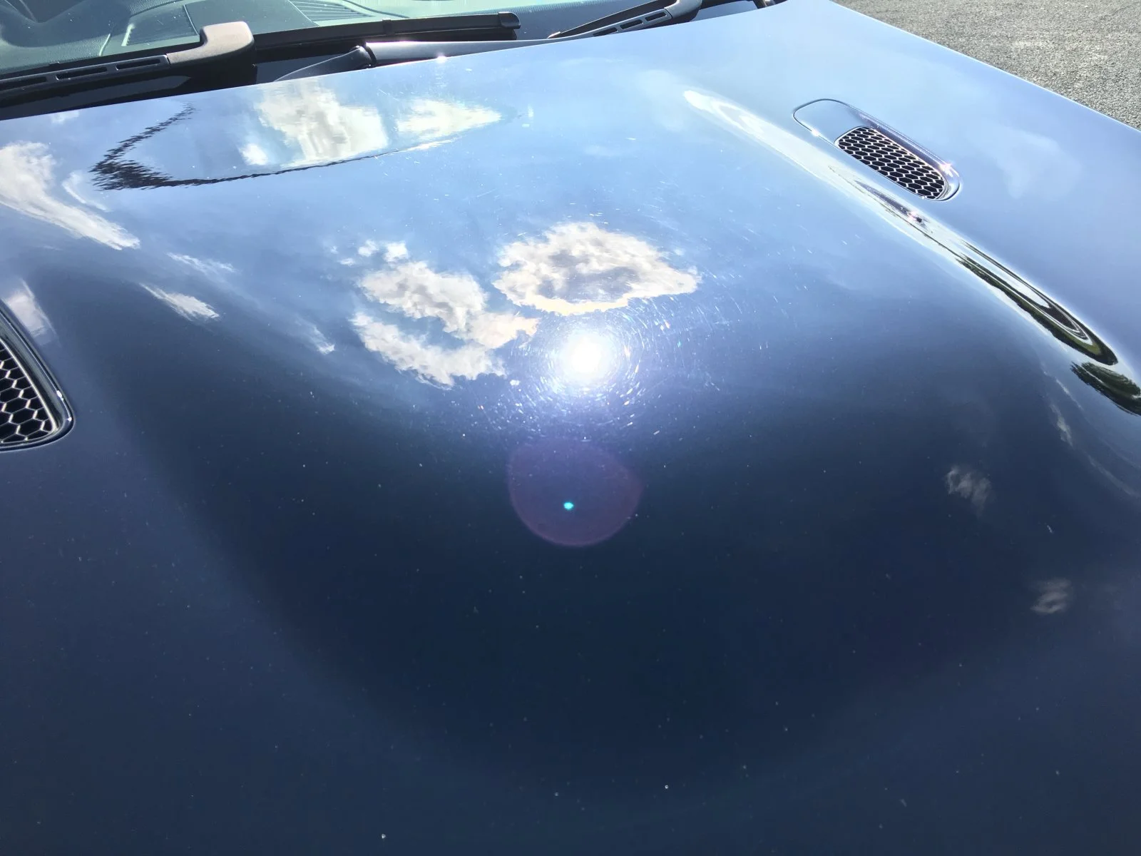

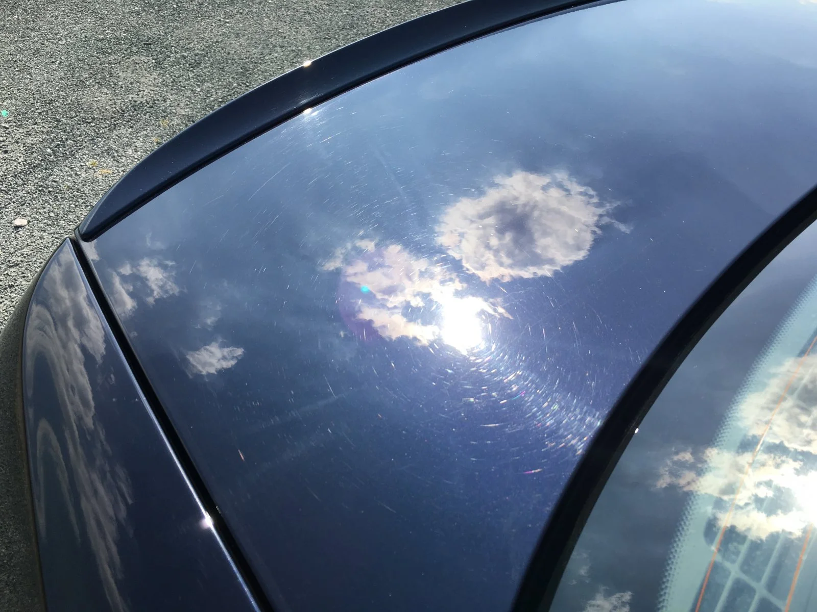

It's generally well maintained, regularly washed and usually sat in the garage, so it looks OK from afar but swirls and scratches come out when you get close

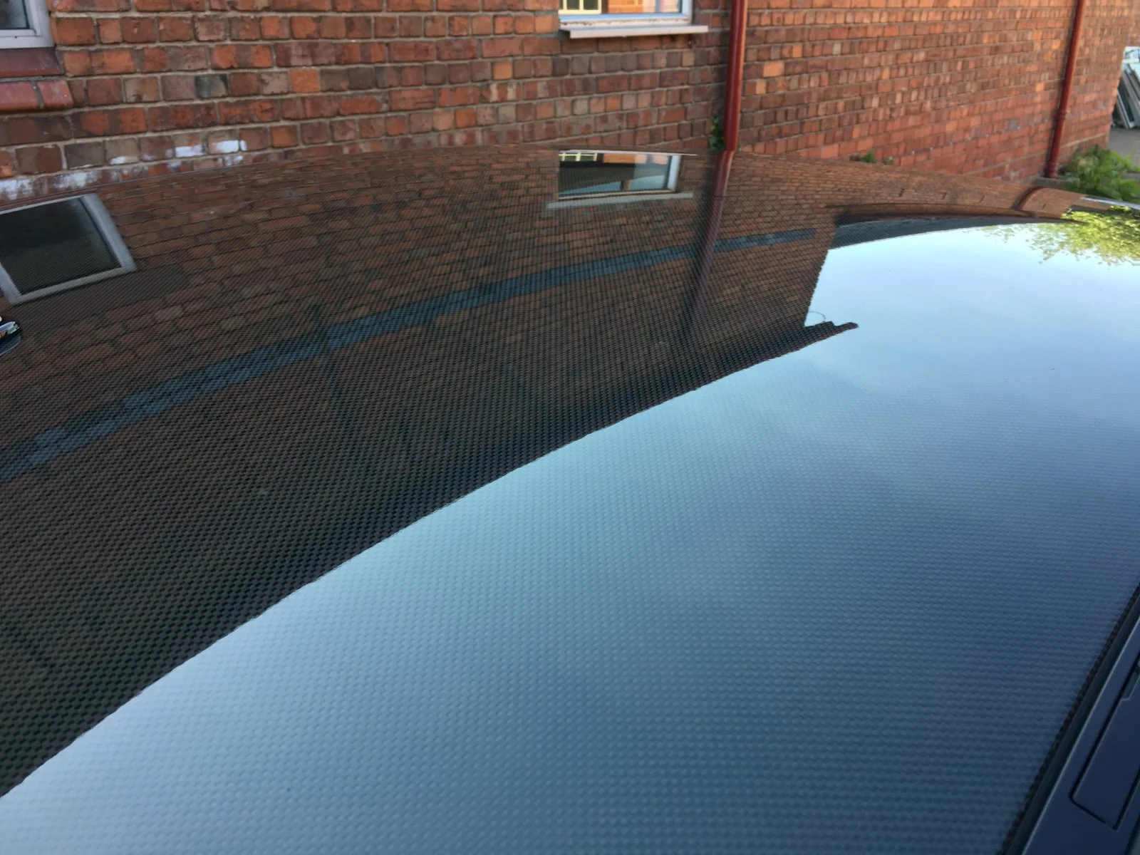

The whole car was pretty much like this, plenty of swirls and RDS's

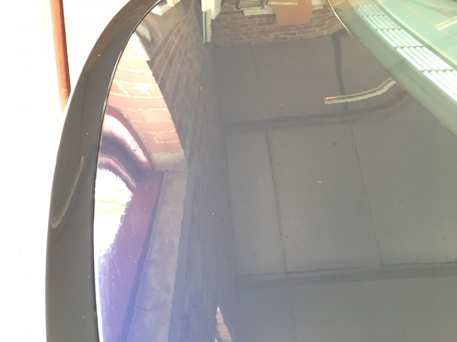

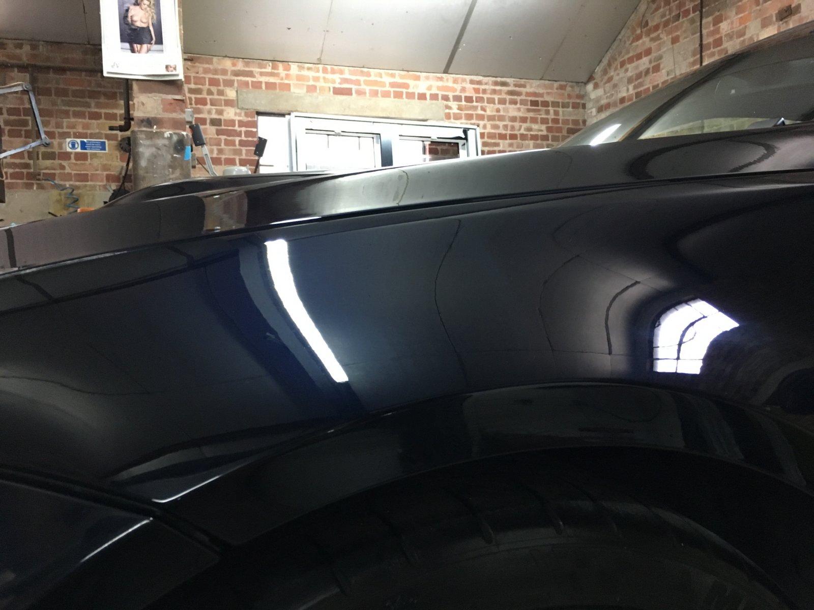

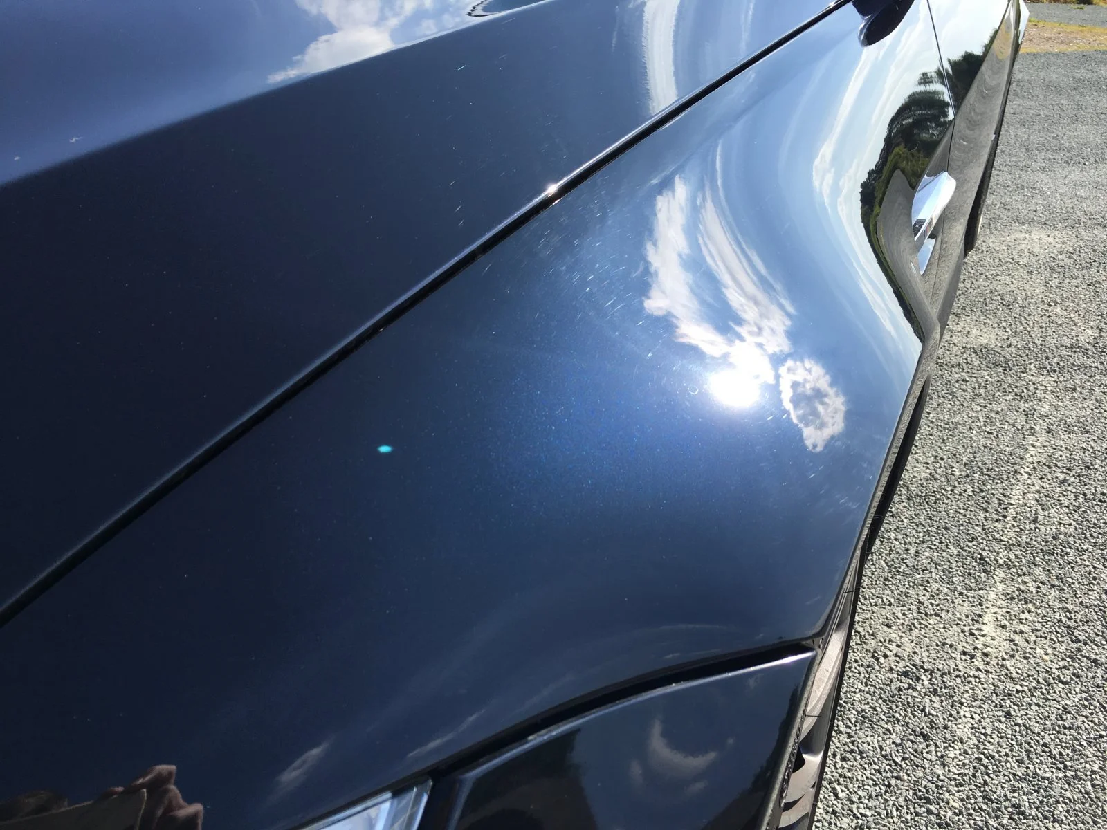

This wing was resprayed prior to collection so it wasn't too badly swirled. The paint was muuuuch softer than the OEM paint on the rest of the car

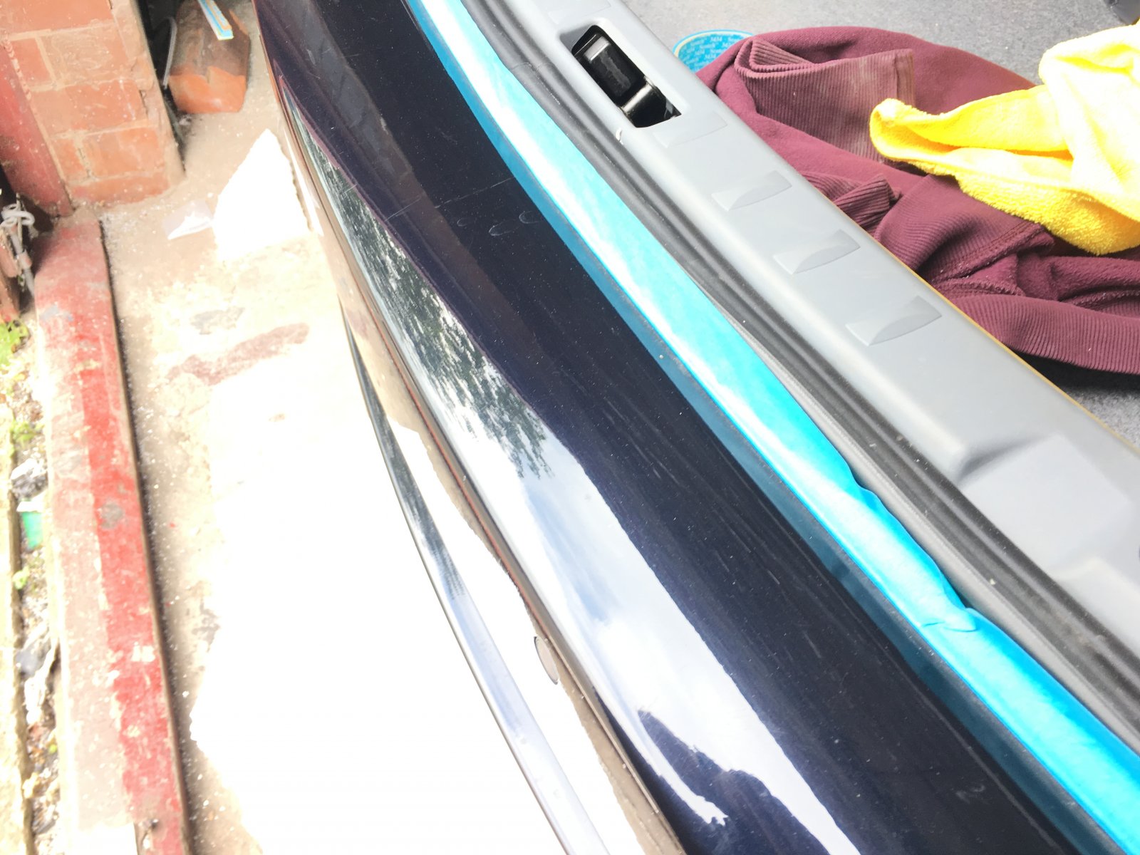

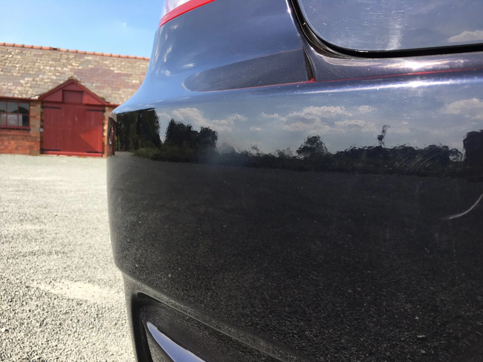

Random little bit of marring on the rear bumper from some T cut

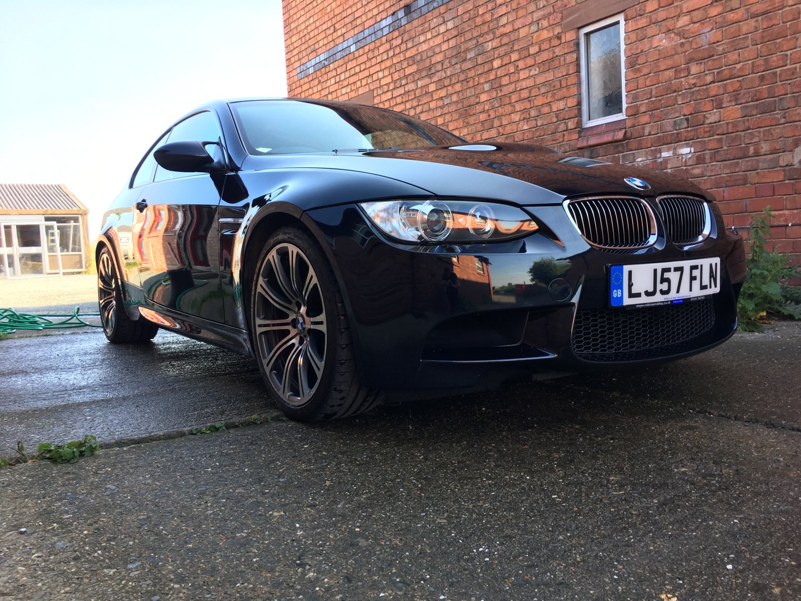

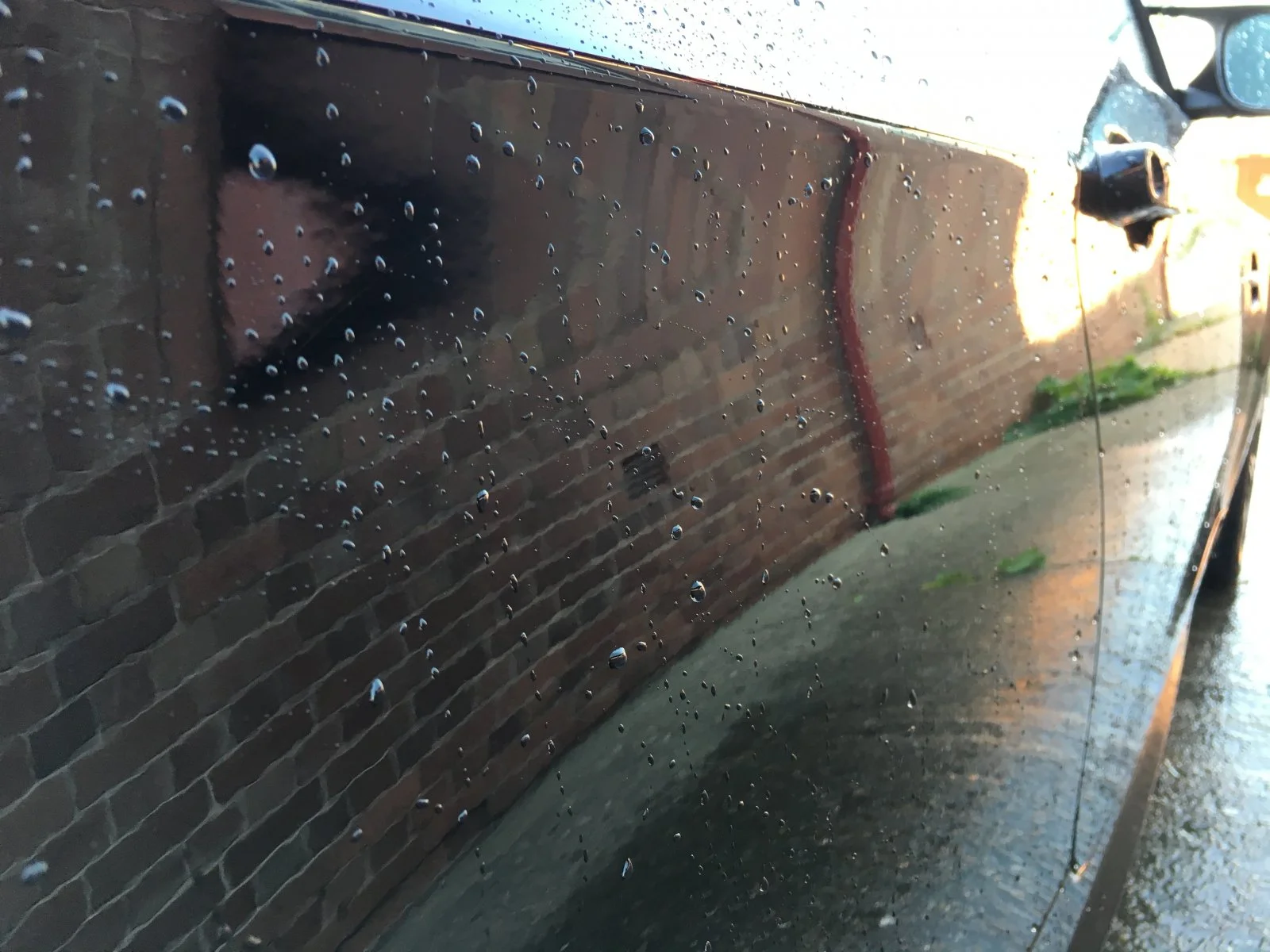

We moved it around the corner into the shade to wash it. It was 33 degrees when we did it on Friday so I didn't mess around getting too many pictures... You couldn't see anything anyway with the car being black.
Af ter the wash I used @autoallure show finish quick detailer as a drying aid. It worked well and smelled brilliant.

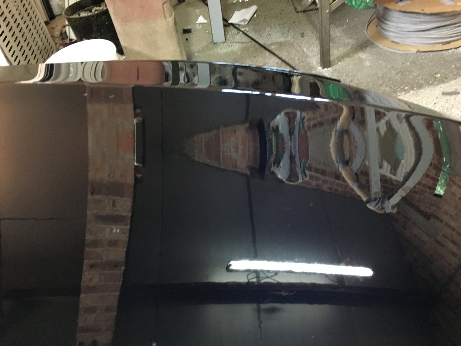

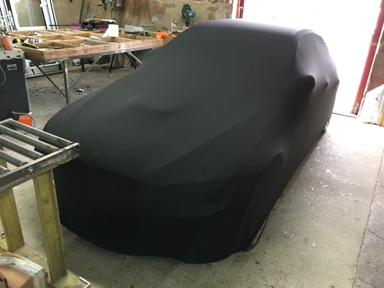

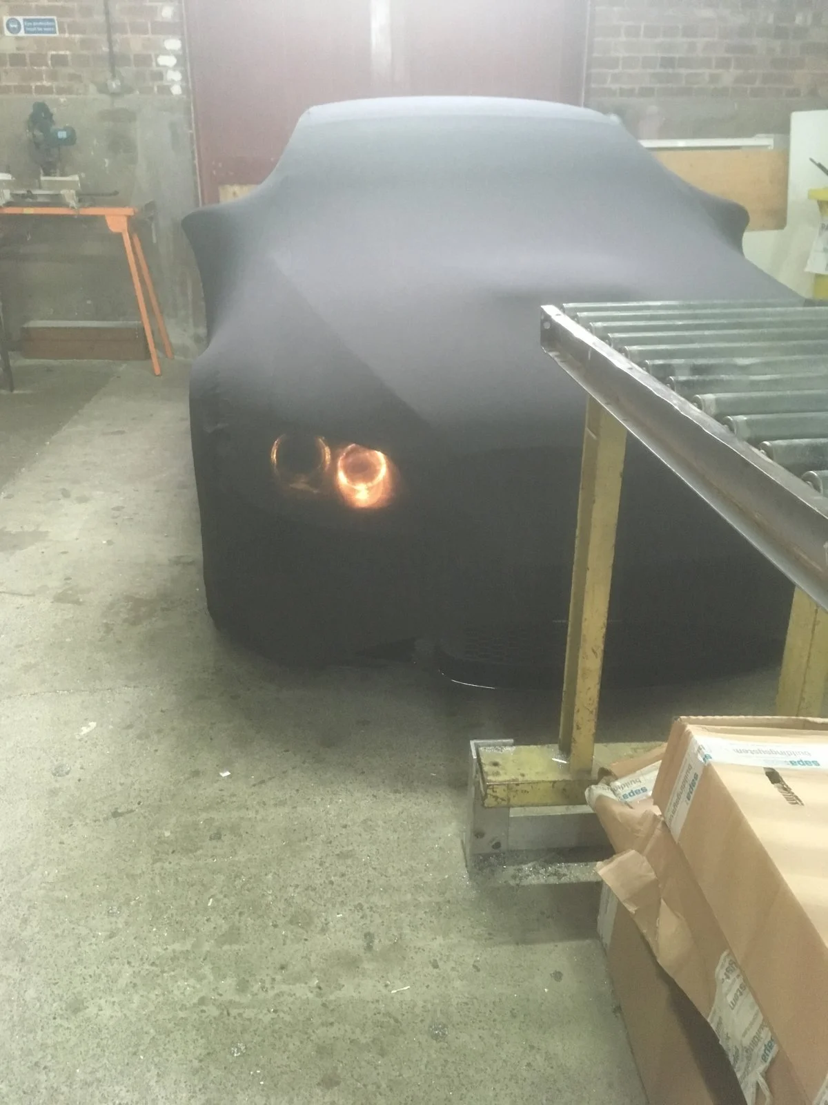

Then dried properly before moving indoors. Out of the sun the paint looks mega

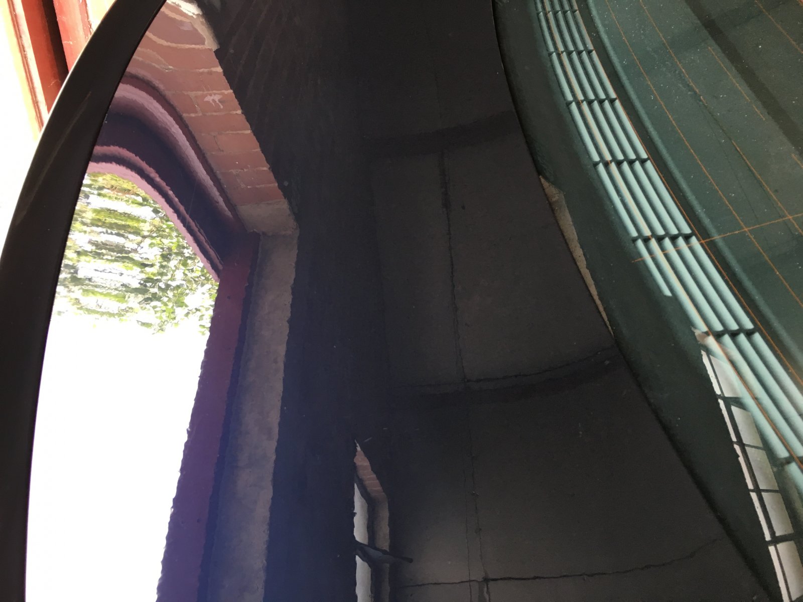

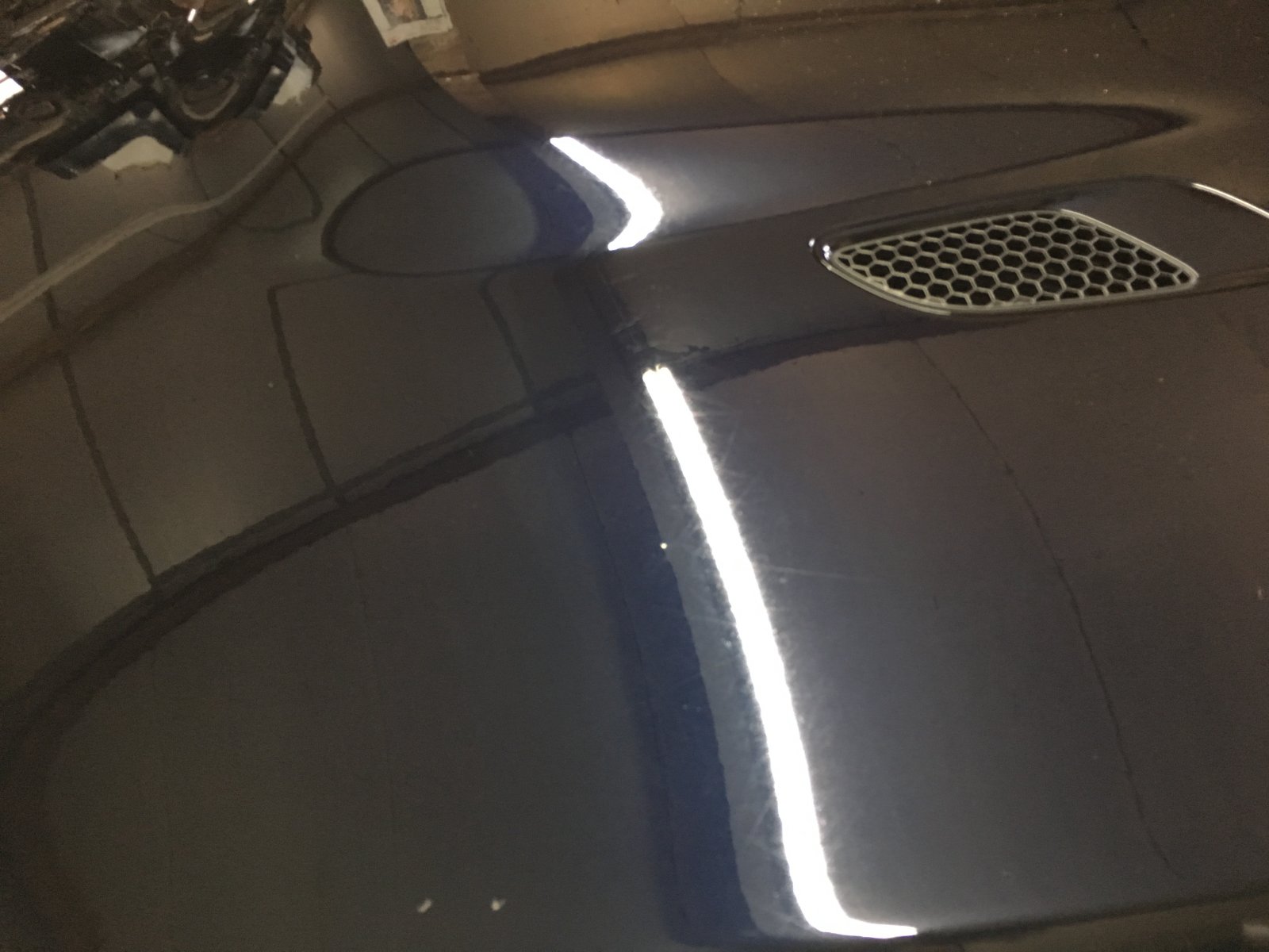

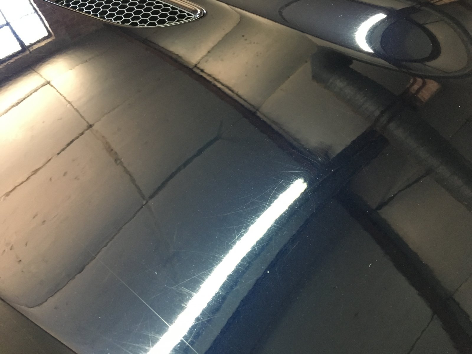

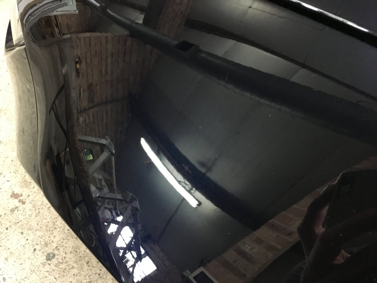

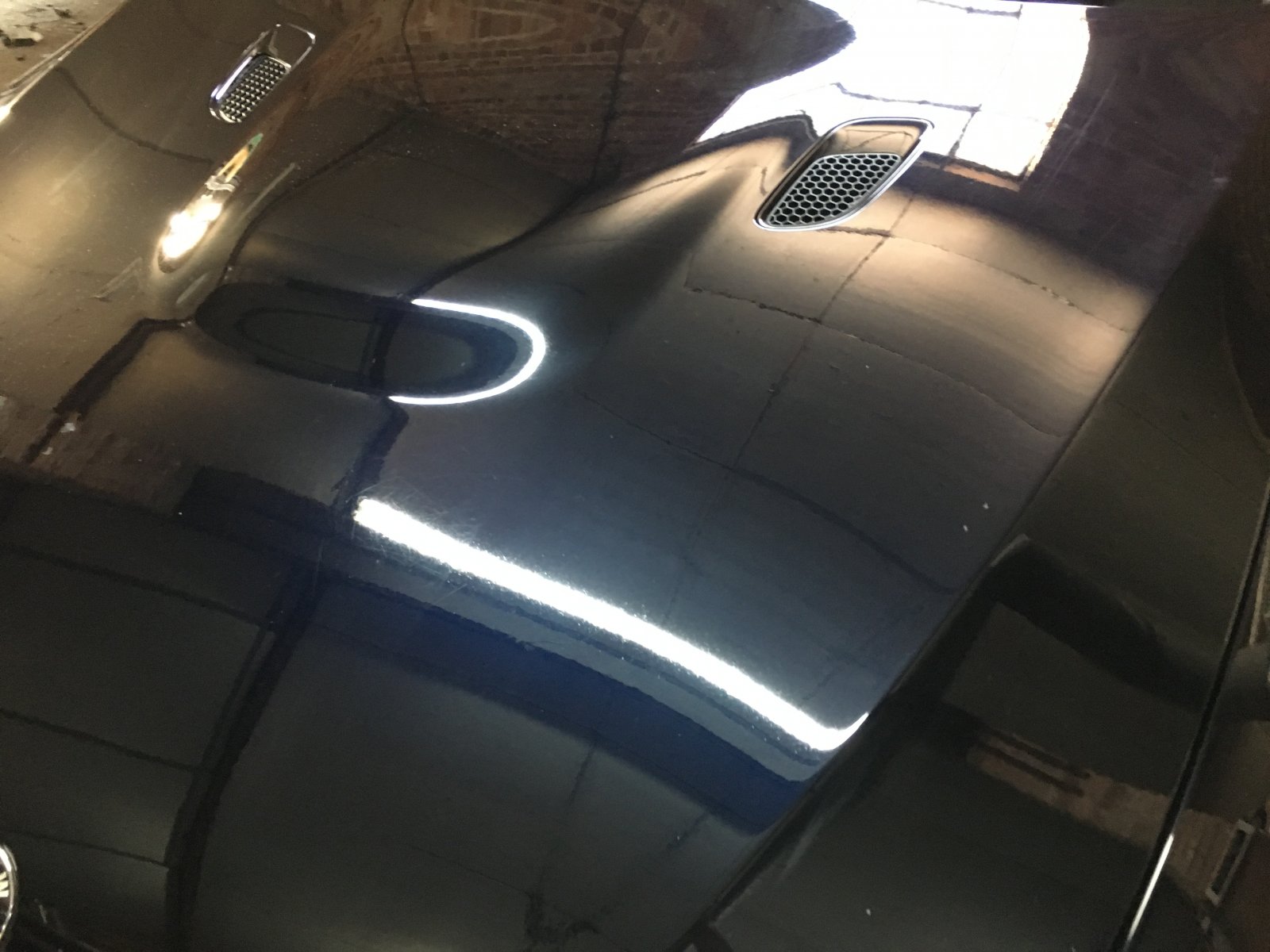

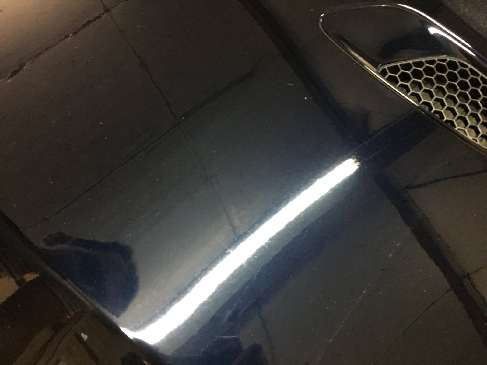

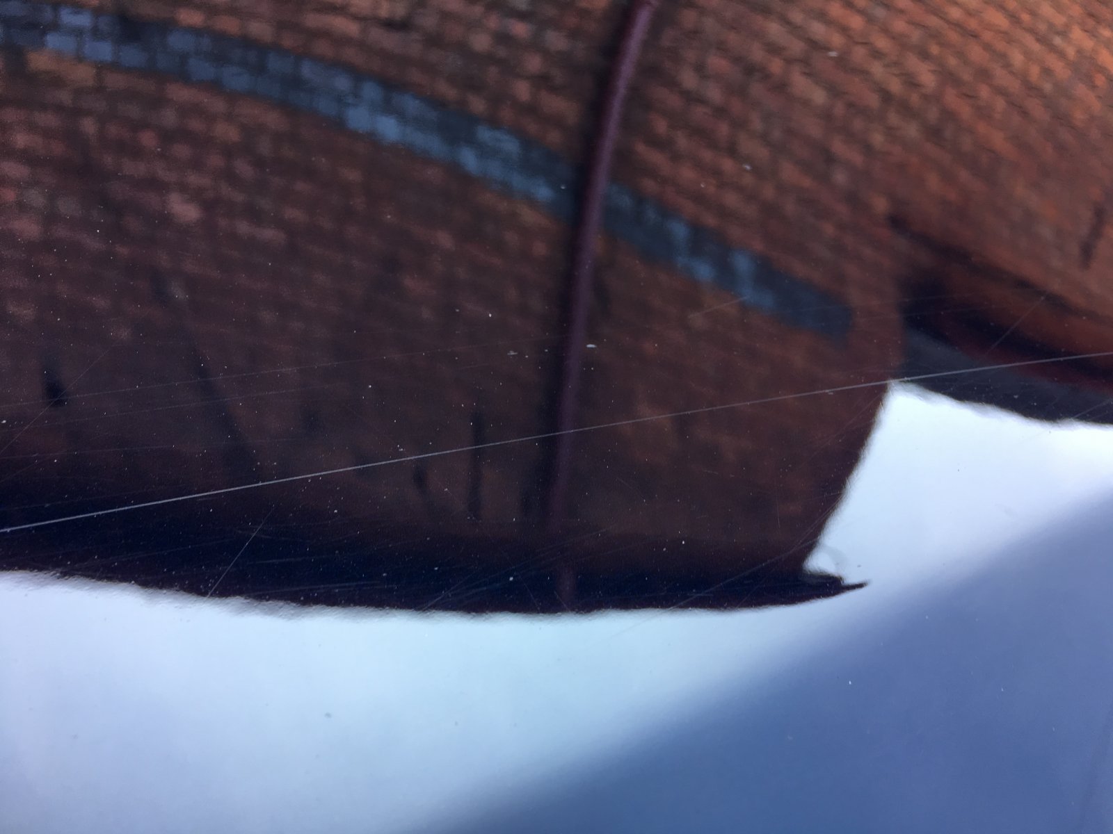

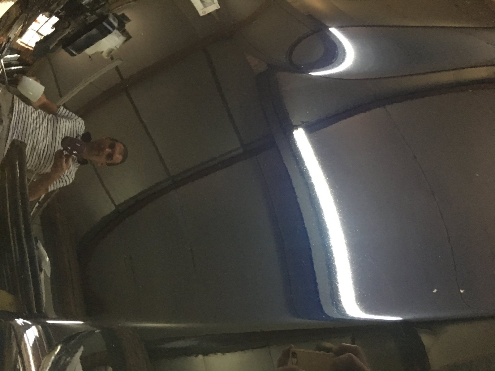

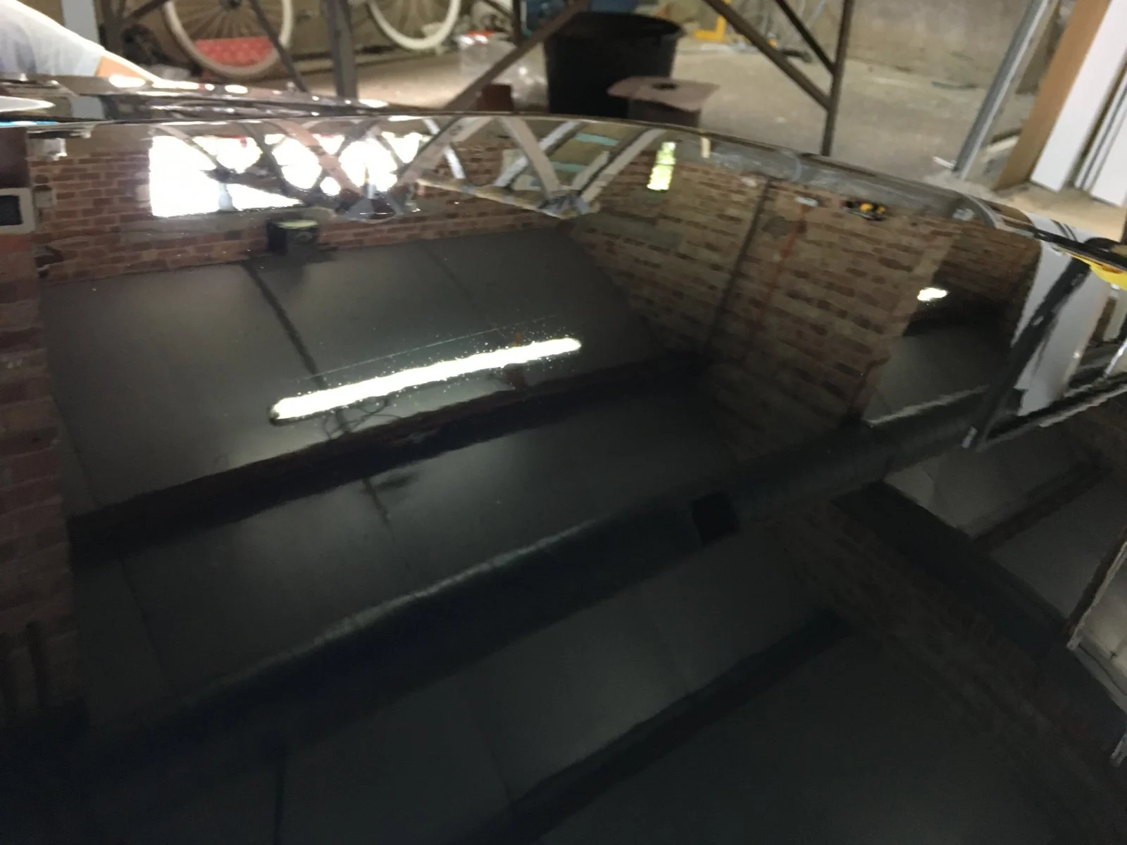

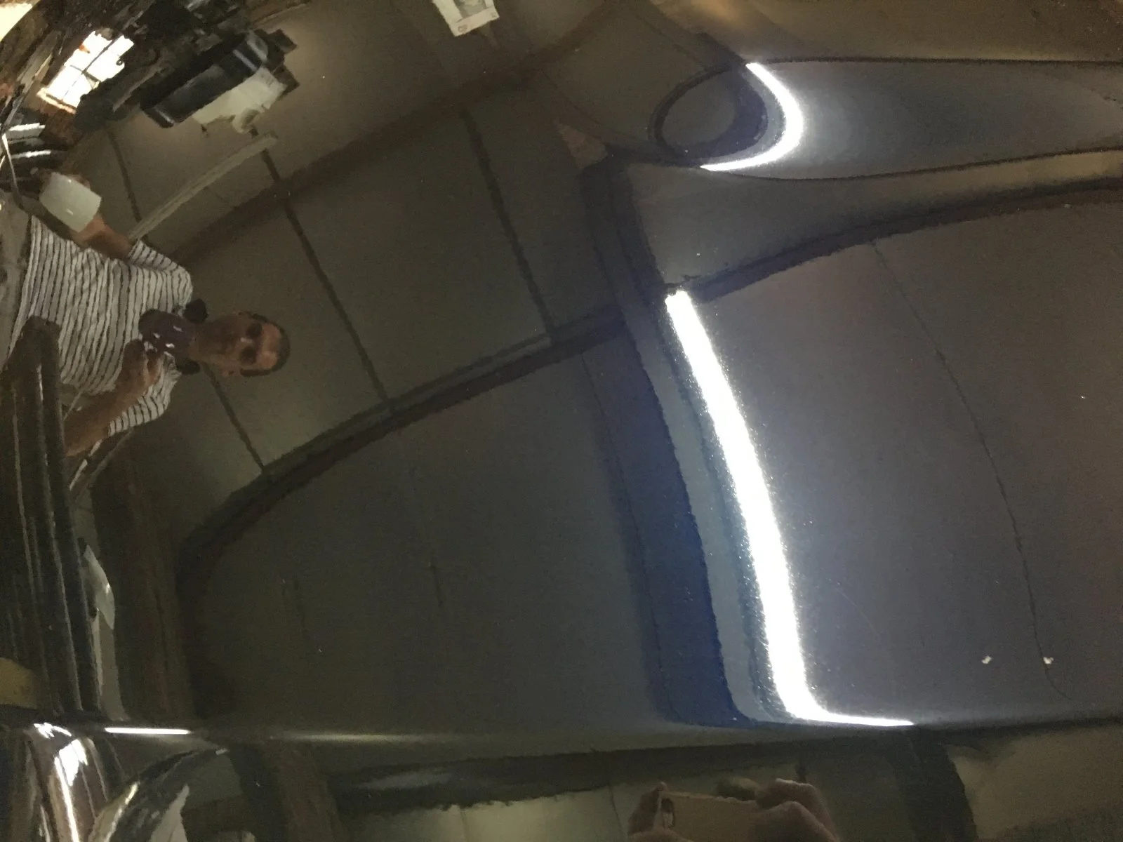

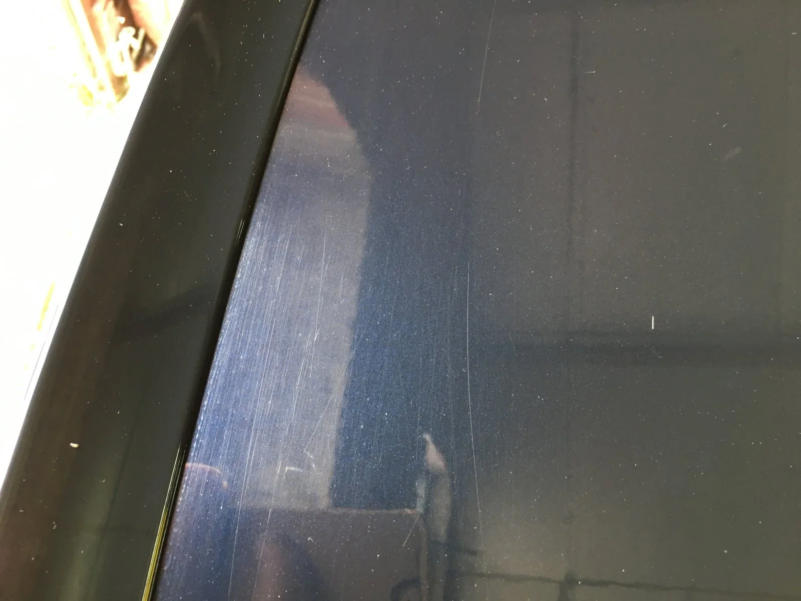

I struggled to catch the scratches outside
But inside the unit they showed up quite well.

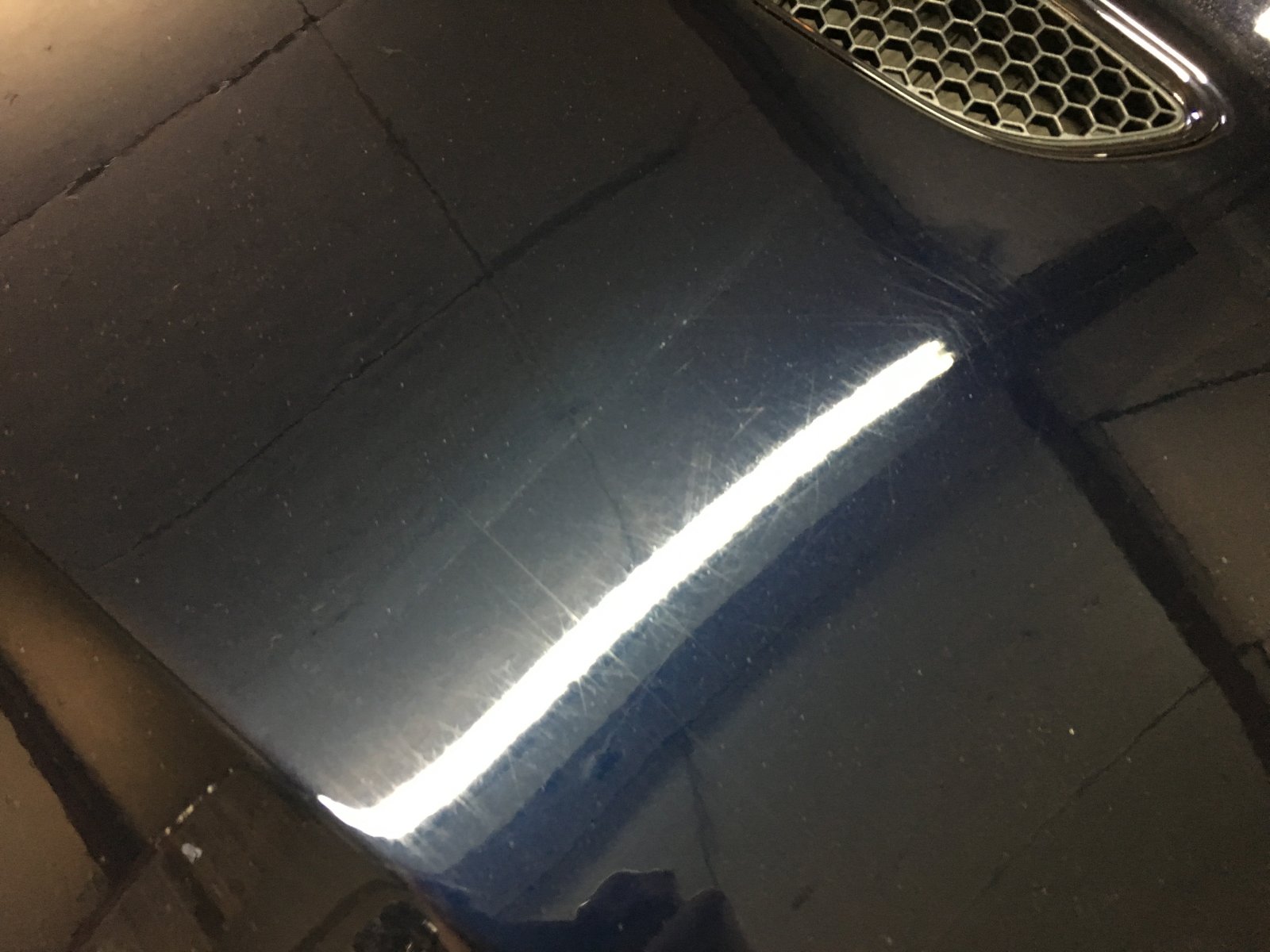

I messed around with a few combinations; auto finesse cutting pads and polish didn't really cut enough or finish nice enough
I moved to hex logic blue cutting pads with various polishes before settling on the orange heavy cut pad with menz heavy cut polish. The big guns were out lol here's a bit of a 50/50

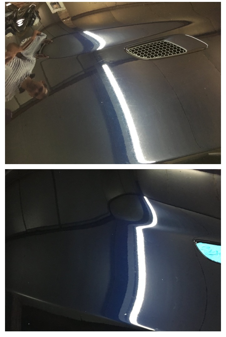

Before and after

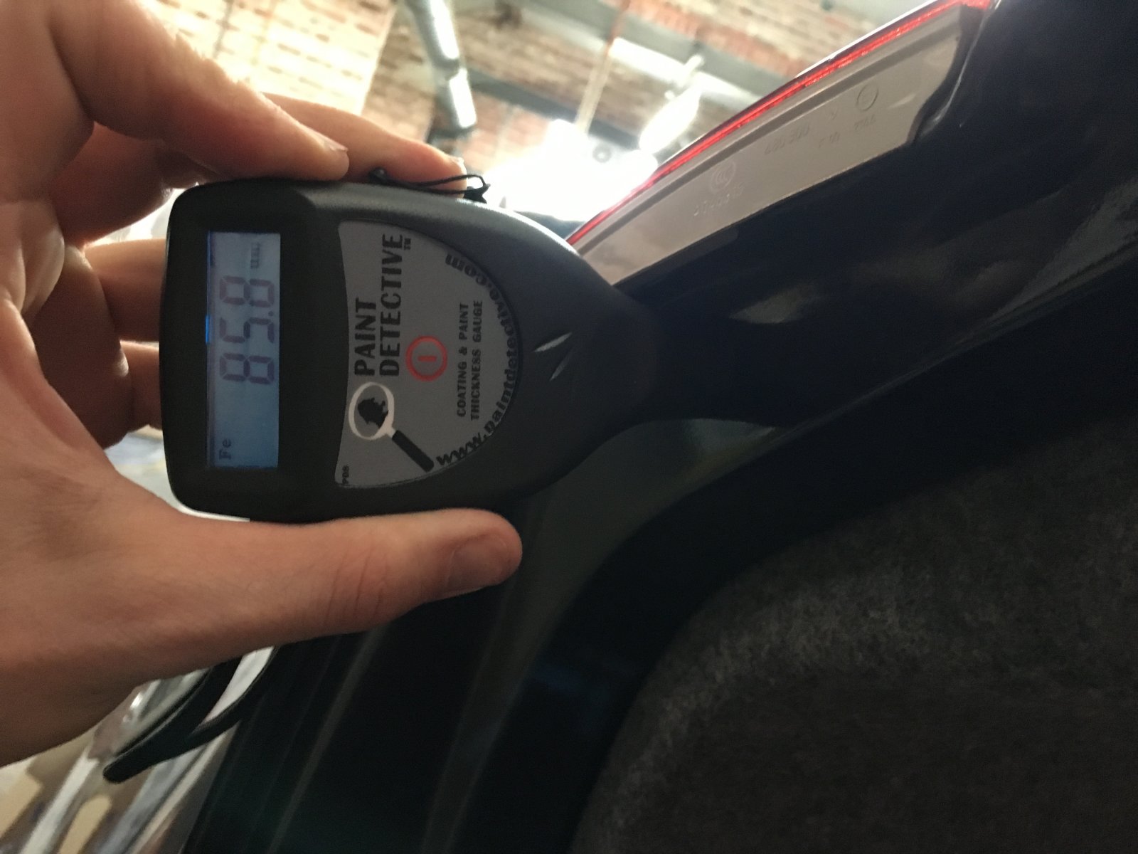

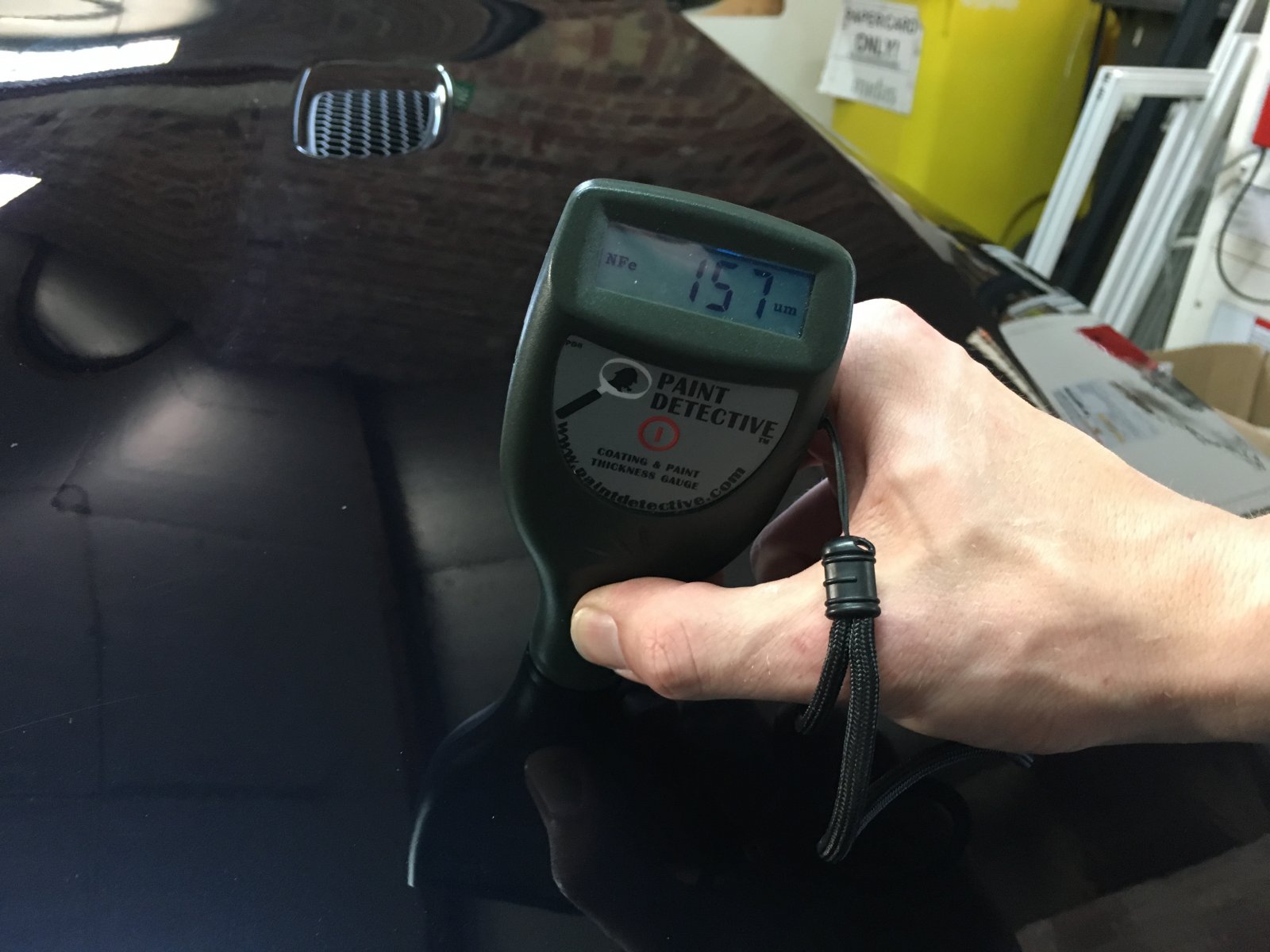

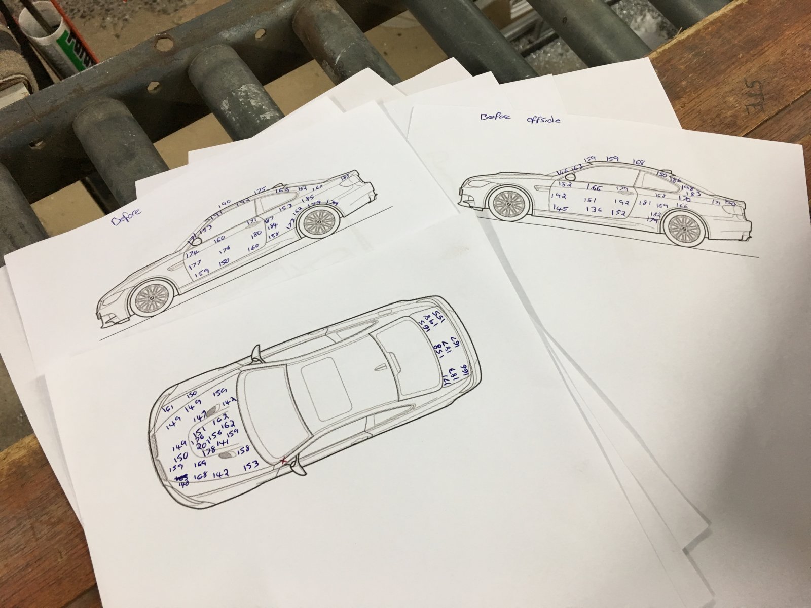

What I didn't picture was that I pinched the ptg from work. It looked pretty consistent, around 160/170 microns across the whole car. For those that are interested, the bonnet bulge has the thickest paint on an m3, 200 microns/0.2mm thick.

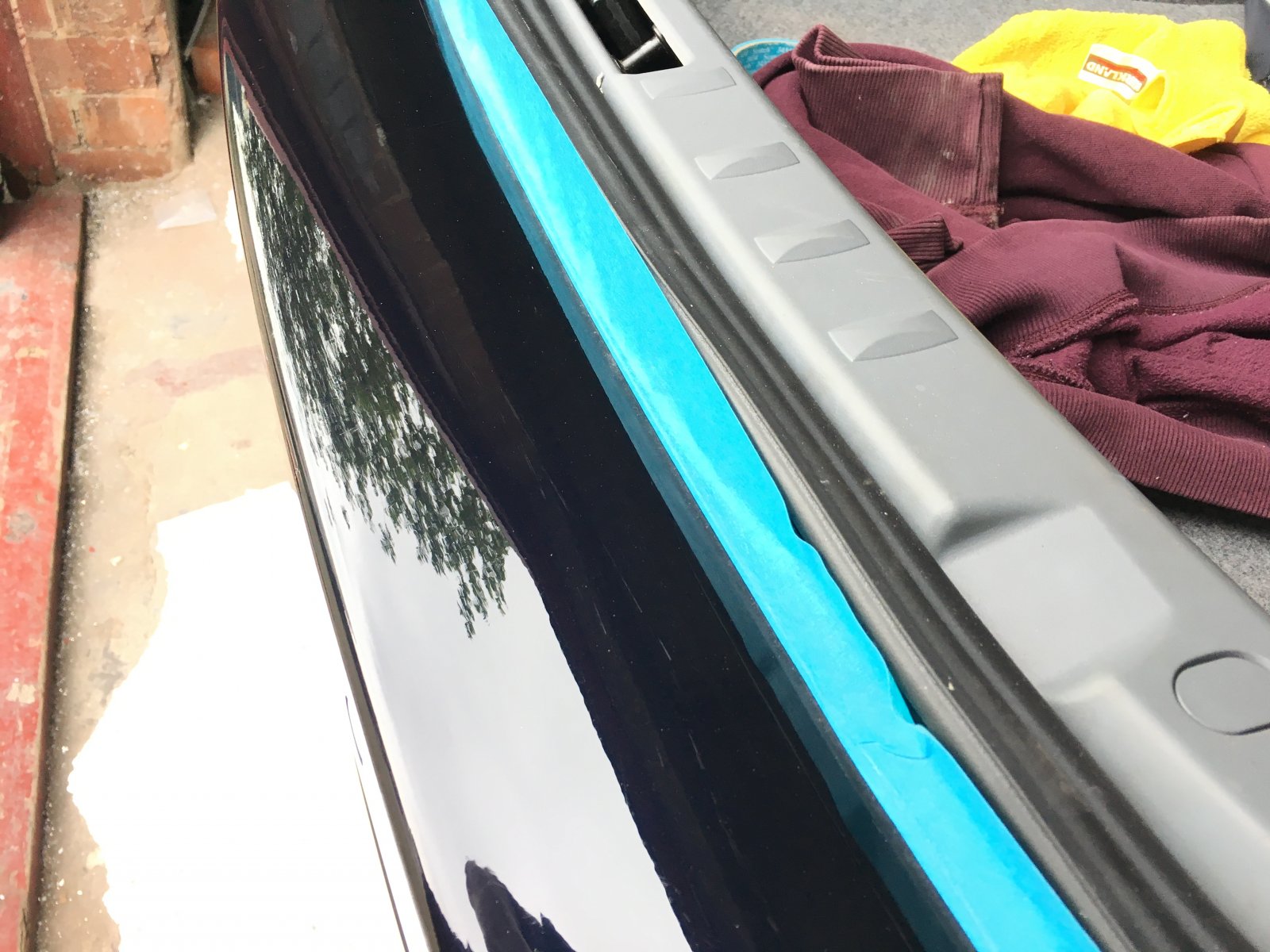

And under the boot lid with no lacquer to see how much lacquer I had to play with. F**k loads. Lol

I moved down to a polishing pad and polishing polish to polish the resprayed wing. polish.

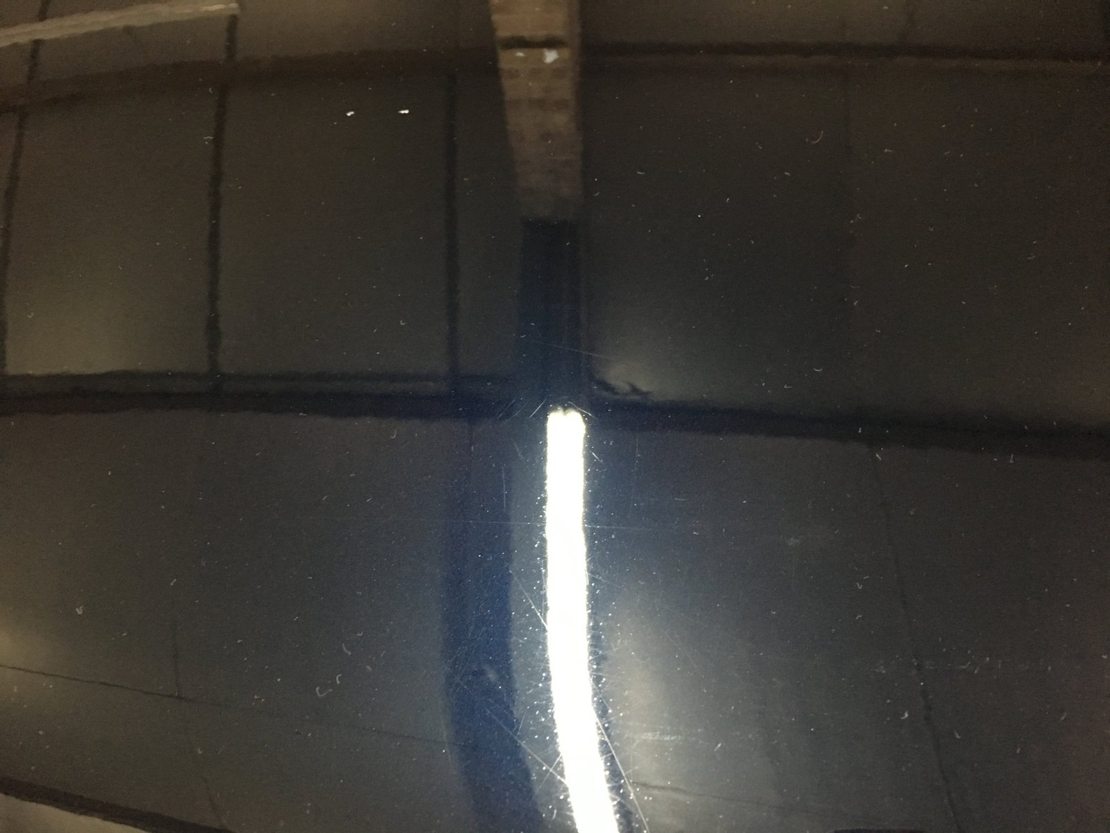

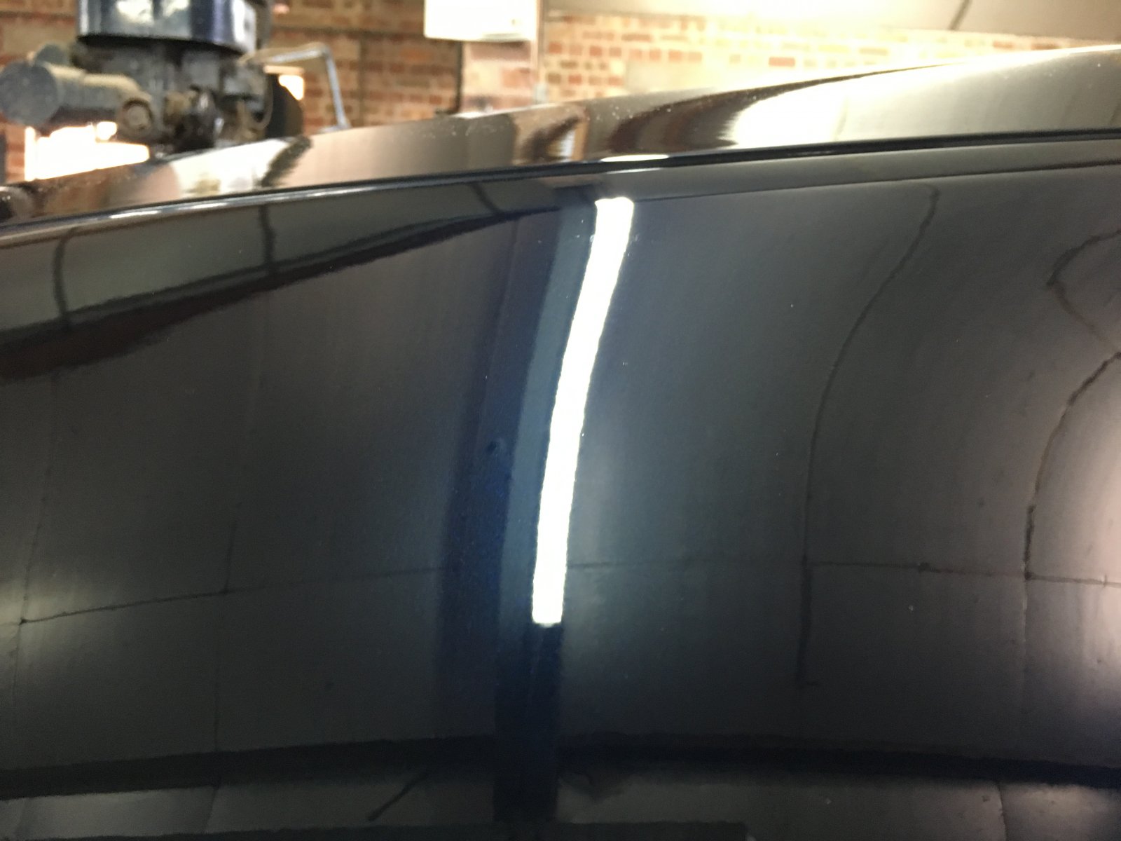

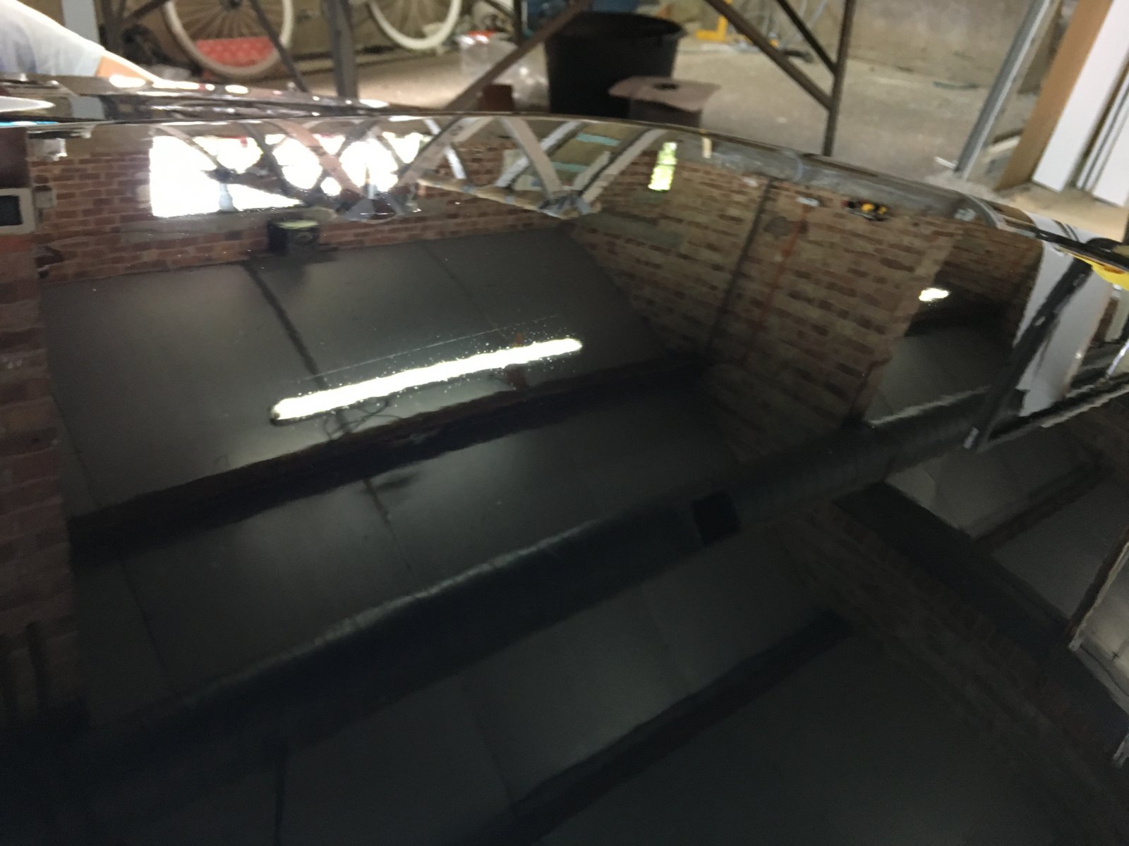

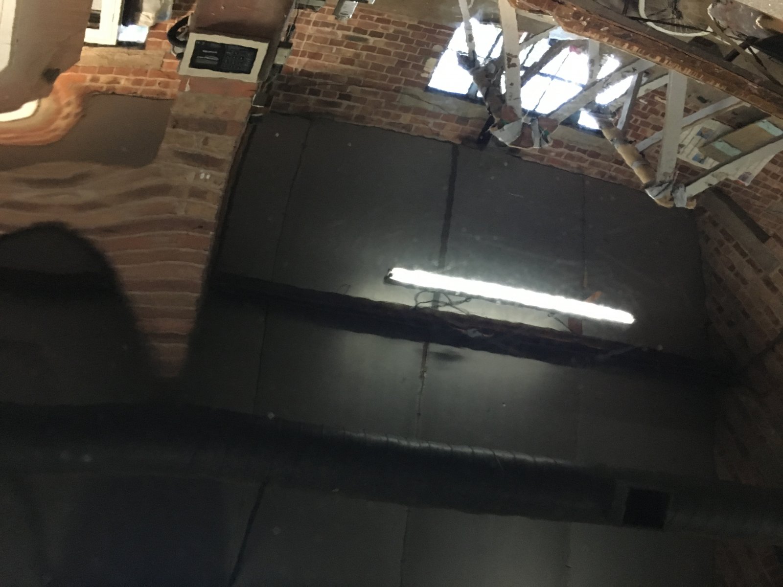

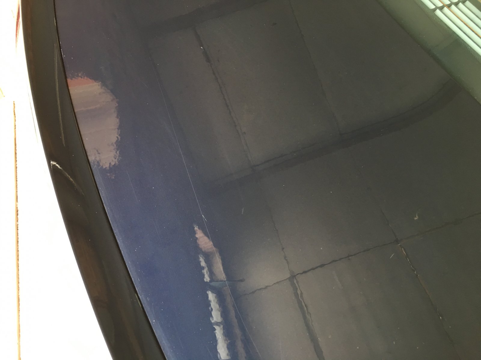

The boot was pretty heavily scratched and marred
The lighter marring and scratches were removed
But a couple of the deeper ones stuck around

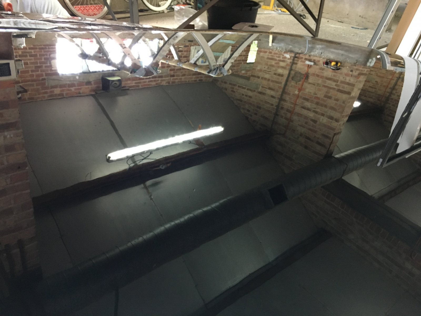

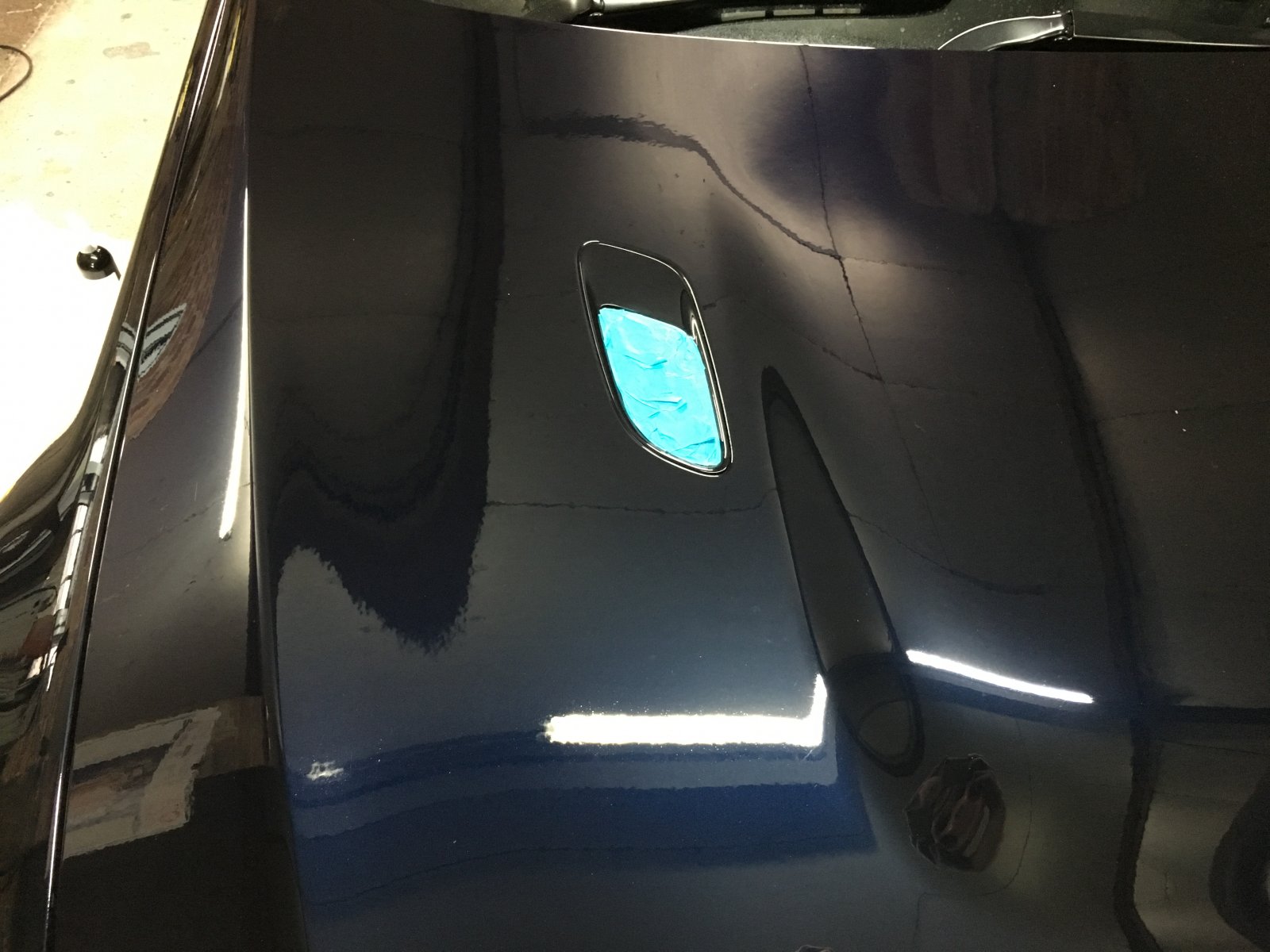

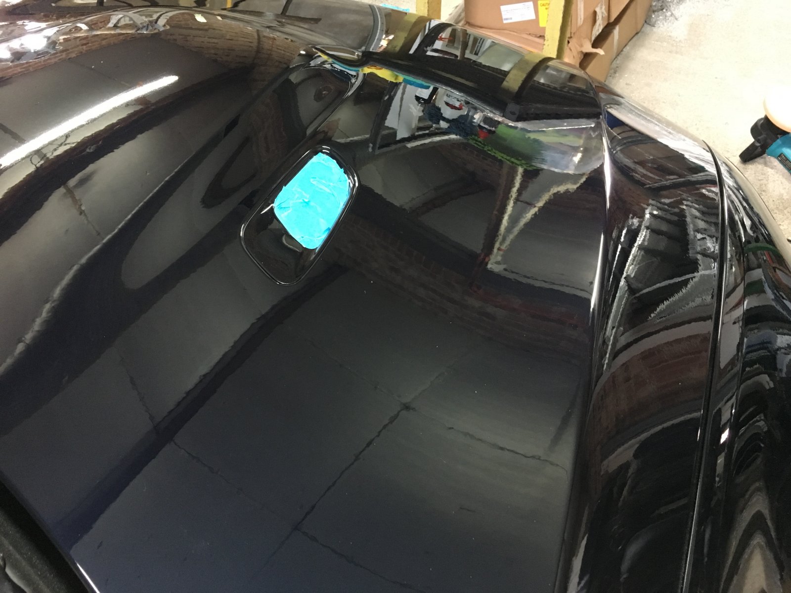

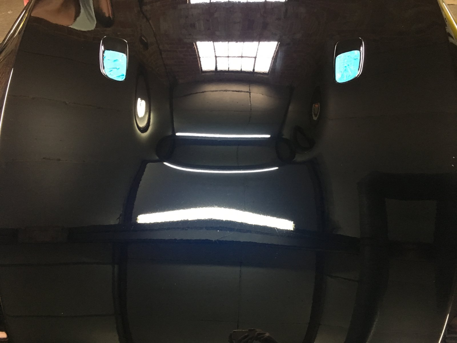

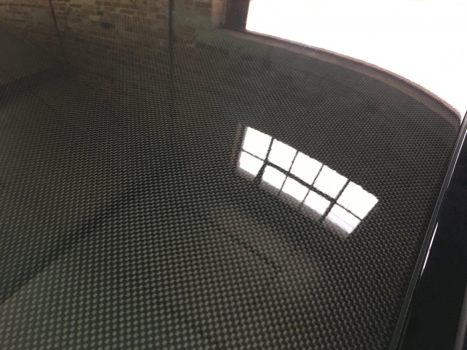

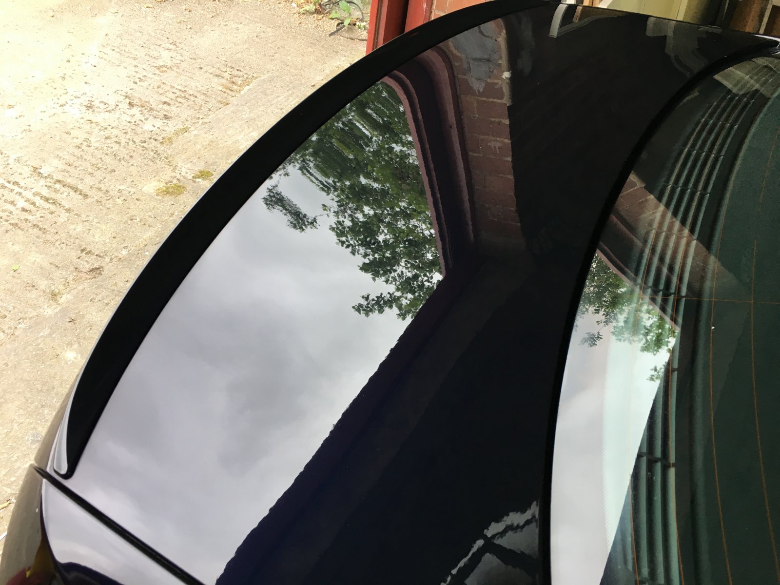

After the polishing was done I moved onto carpro essence on a microfibre pad to finish and lay a base for the reload

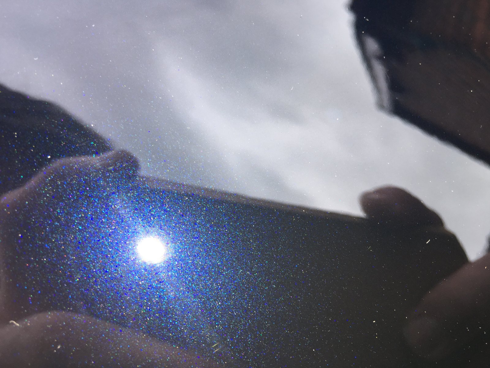

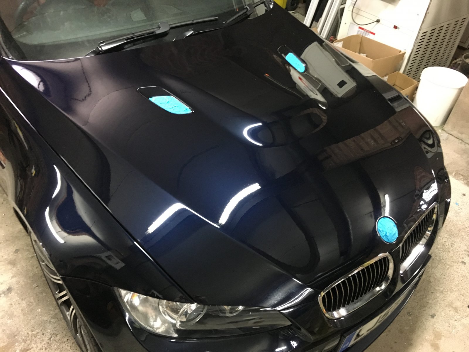

The menz polish finished fine but the essence really brought the gloss out.. and brought the blue out with it
Spot the face. This may ruin m3s for you in the future
Knuckles
ClioSport Admin

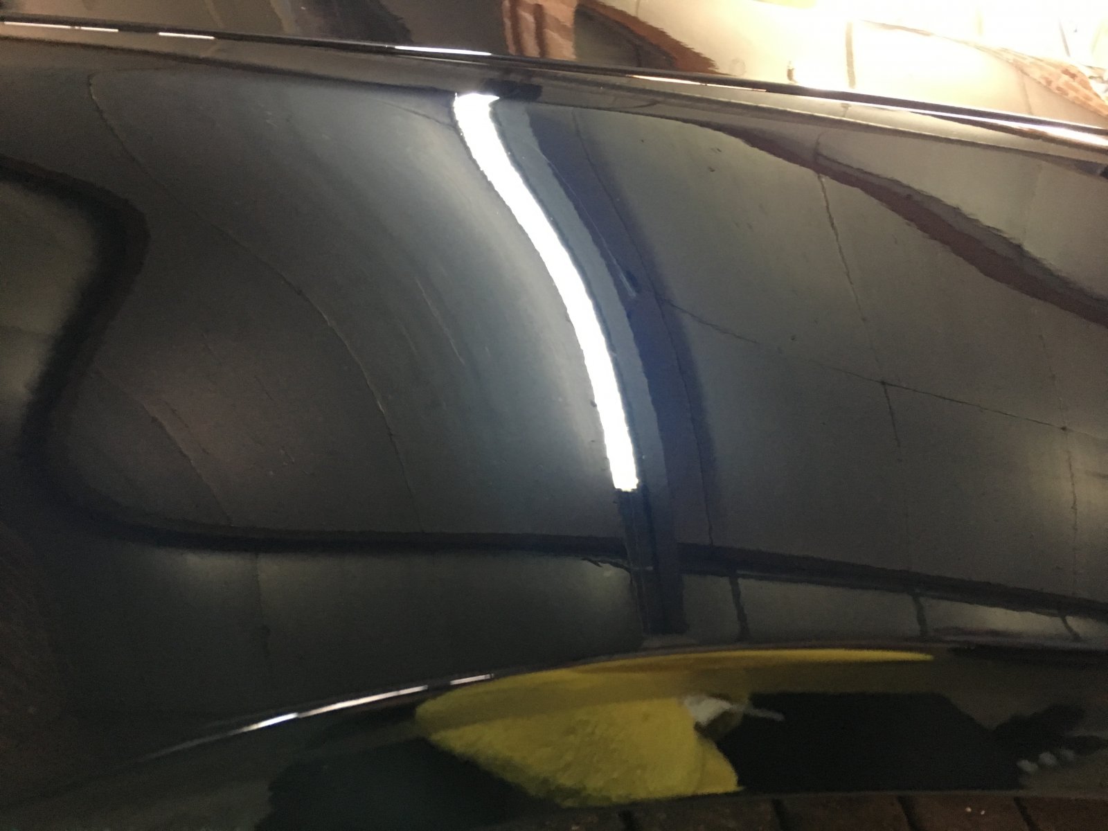

Essence filled in the deeper scratches somewhat too

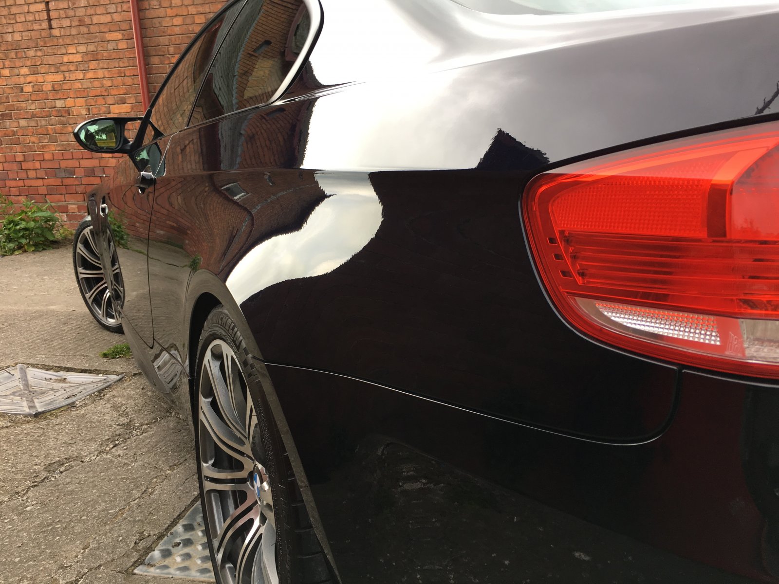

Dat gloss

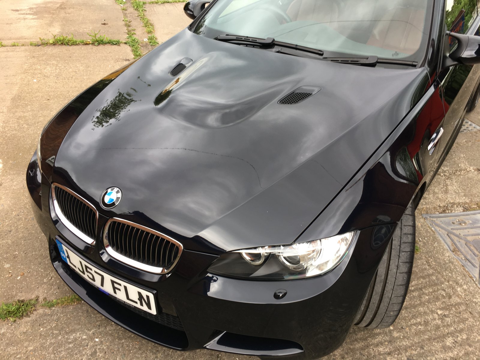

After I finished, we gave the car a couple of coats of gyeon cure *not carpro reload, my bad
Bonus paint thickness shot

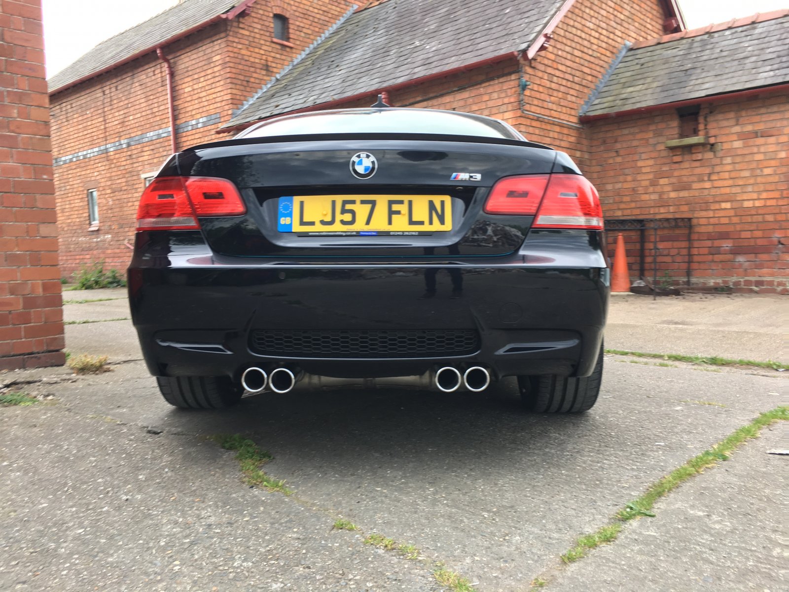

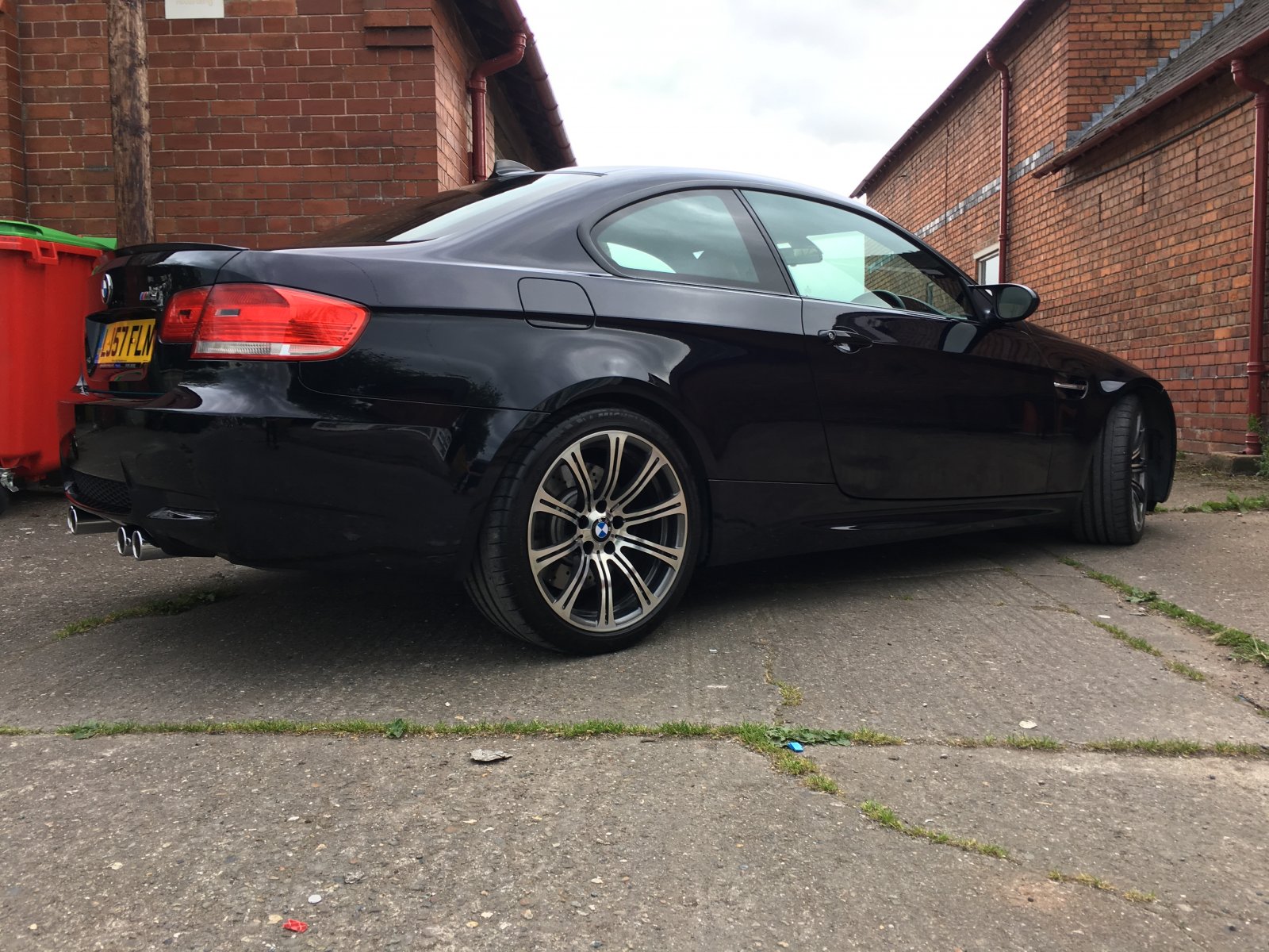

Then rolled out for some overcast afters
sburrell93
Scotland - South
Good work! Got to laugh at how bad orange peel in BMW paint is though. Always so noticeable under the light. Still, looks incredible and is not helping my want for one at all lol.
What colour is that? Looks black in most of the photos but a lot of the close up shots in the light look blue?
P.S You forgot to unmask under the bootlid in the afters outside :tongueout:

Carbon Black Probably mate - I have this argument at work (I detail at BMW) and i see blue. I rarely see a black looking carbon black car lol

Cheers! I've seen a lot of people wet sand them to remove it but that's a bit too big of a job lol
If you can, get one. It's mega. It's got the box chop too so sounds incredible
It's Jerez black. Removing the haze seems to have really brought out the blue
Yeah I did realise that after we put it away. And I forgot to tell the owner haha. Shhhh
Cracking calendar too lol

Please don't use the in lacquered bits as a guide to the lacquer thickness though. There will most likely be thinner base coats there too. Pissing in the wind really. I can imagine some bumpy thinking they've got 40-60 microns of lacquer to burn through and after 20 they've hit paint lol
Thanks! :D
Yeah I was only using it as a reference, I took readings after settling on the polish combo to make sure I didn't take off too much. I think the combination took off around 10 microns after one hit, good thing the paint is rock solid lol

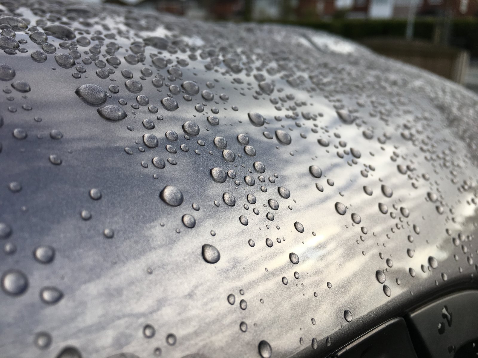

This had a bit of lacquer overspray from the wing being done, I thought I was going to have to sand that but the polish removed it nicely.
After essence and reload/cure I doubt I'll go back to wax. For ease of use, looks and durability you can't beat them.

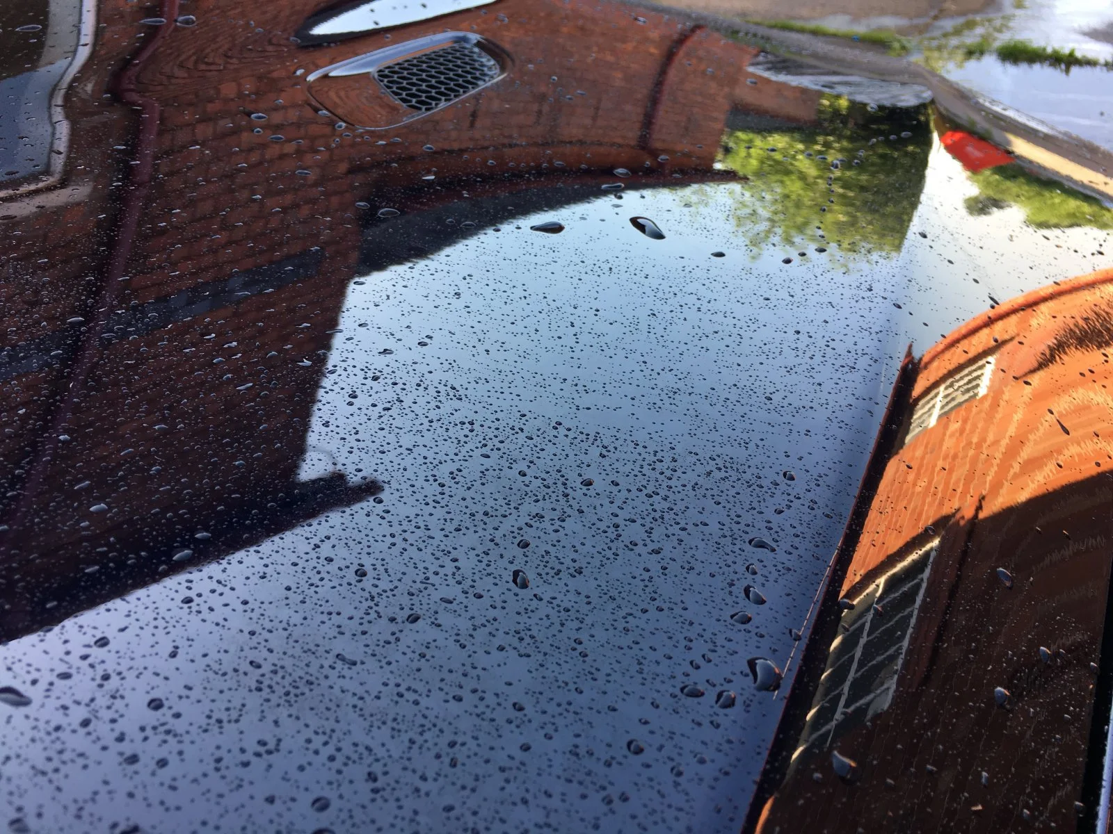

They bead like this too.
It dries solid too. I picked up the microfibre I applied it with on the above car and there was loads of stringy bits of lacquer looking things, it was the coating drying in the fibres. So even if you don't cut the deep scratches out, it should fill a bit of them
