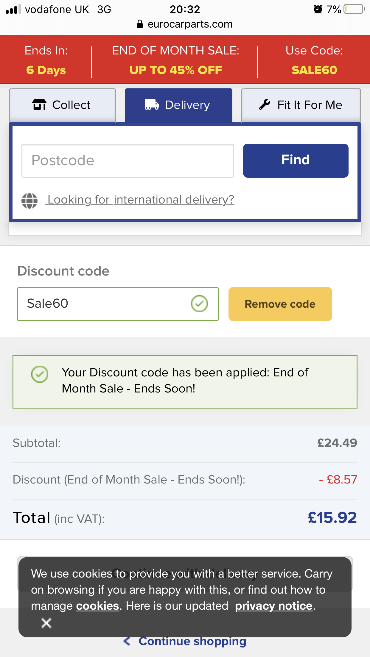

Hi all,
Whilst bored this morning I stumbled across this on ECP. It’s coming up as the correct radiator for my 182FF. However I wanted to reach out and ask if anyone had ordered one and it was in fact correct? With the current ECP discount code it’s coming in at £15.92 which is mentally cheap!
I do need a new radiator but won’t likely get to fit for a couple of months now, so didn’t want to order and find later on it’s the wrong bloody one!
anyone know?

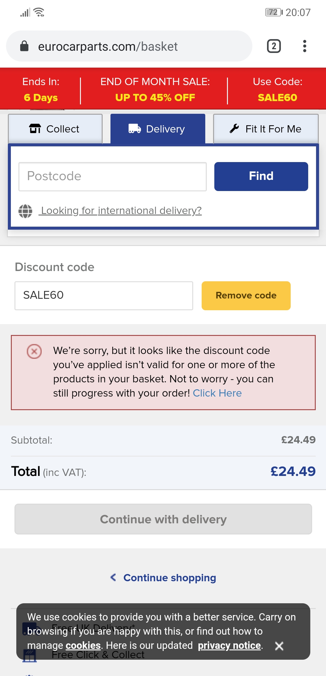

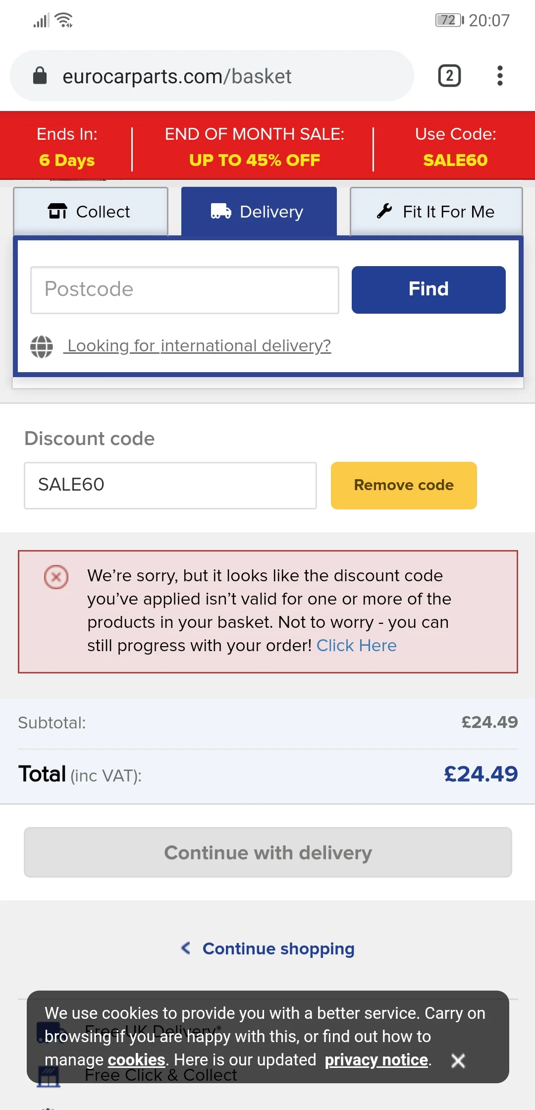

Code doesn't work for me though

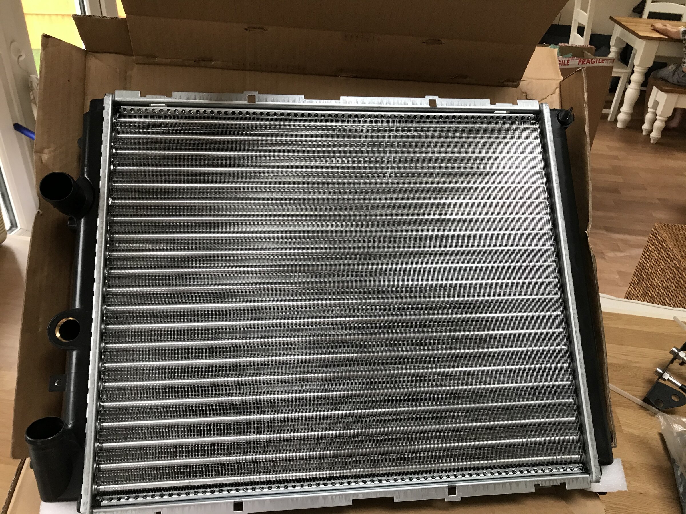

It’s arrived, looks about right in terms of fitting placements from what I can see...however is deeper than my OEM radiator which is about 36mm with this being 48mm. Not actually sure if this is an actual issue, looks like it all should fit. Condenser attachment points look to be there....anyone have any ideas

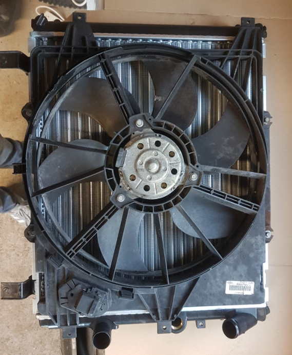

Can confirm this EIS rad fits absolutely fine in a 182 FF.
Rad fan bolts straight in (You'll need to use the captive nuts from your old rad but rescind them of their captive status!) Mounting rubbers fit in as they should with no modification.

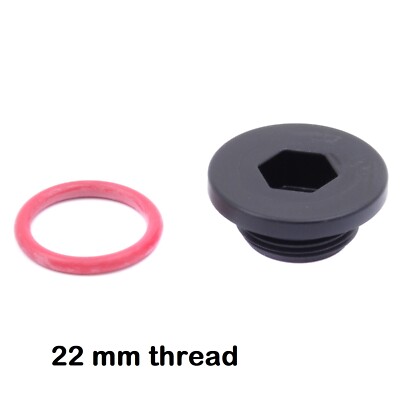

Blanking plug is required:
Fits absolutely fine despite being thicker than the standard unit:
