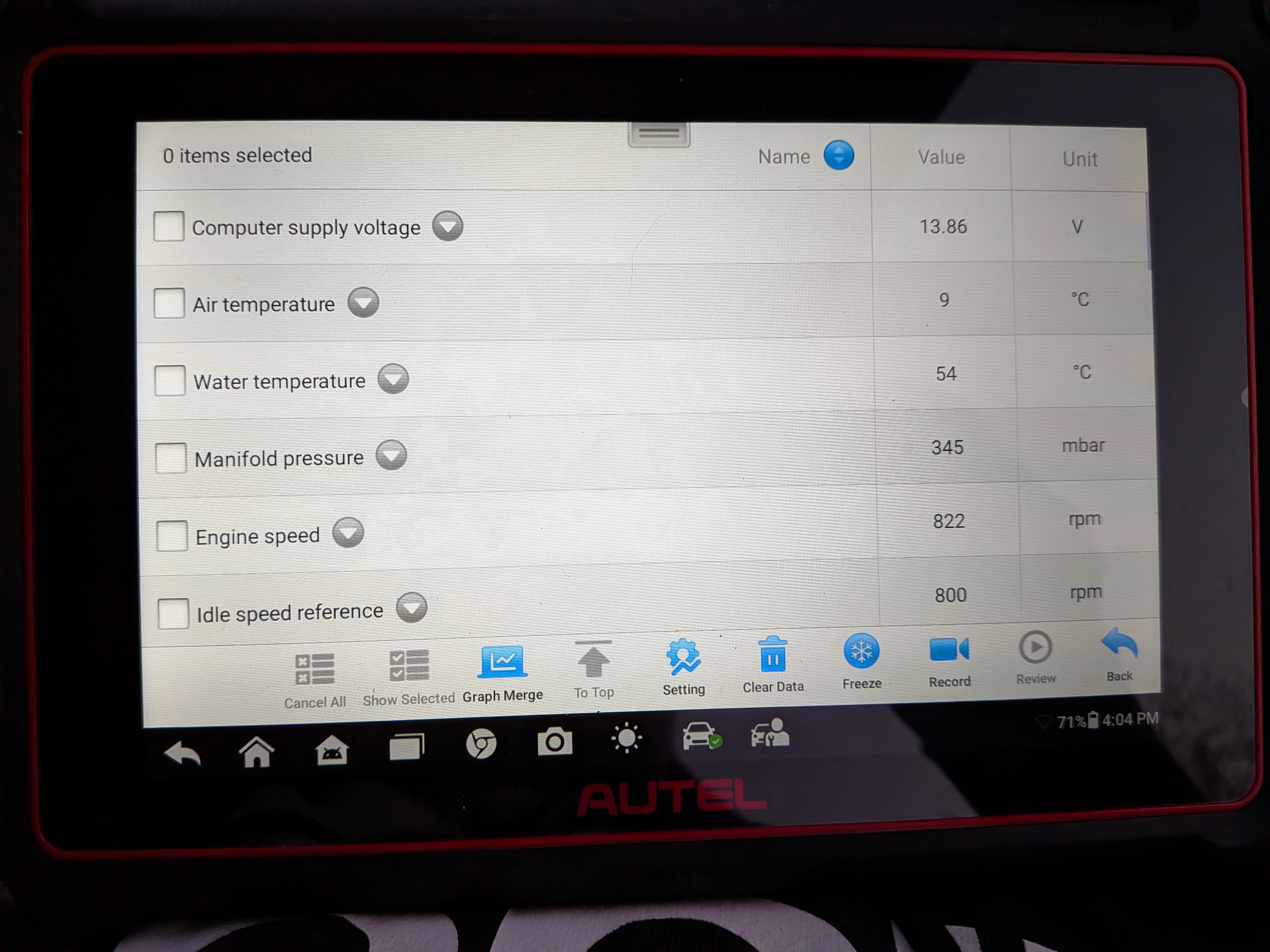

Coolant temp appears to be reading correct, starting at ambient temp and working its way up as the engine warms up.

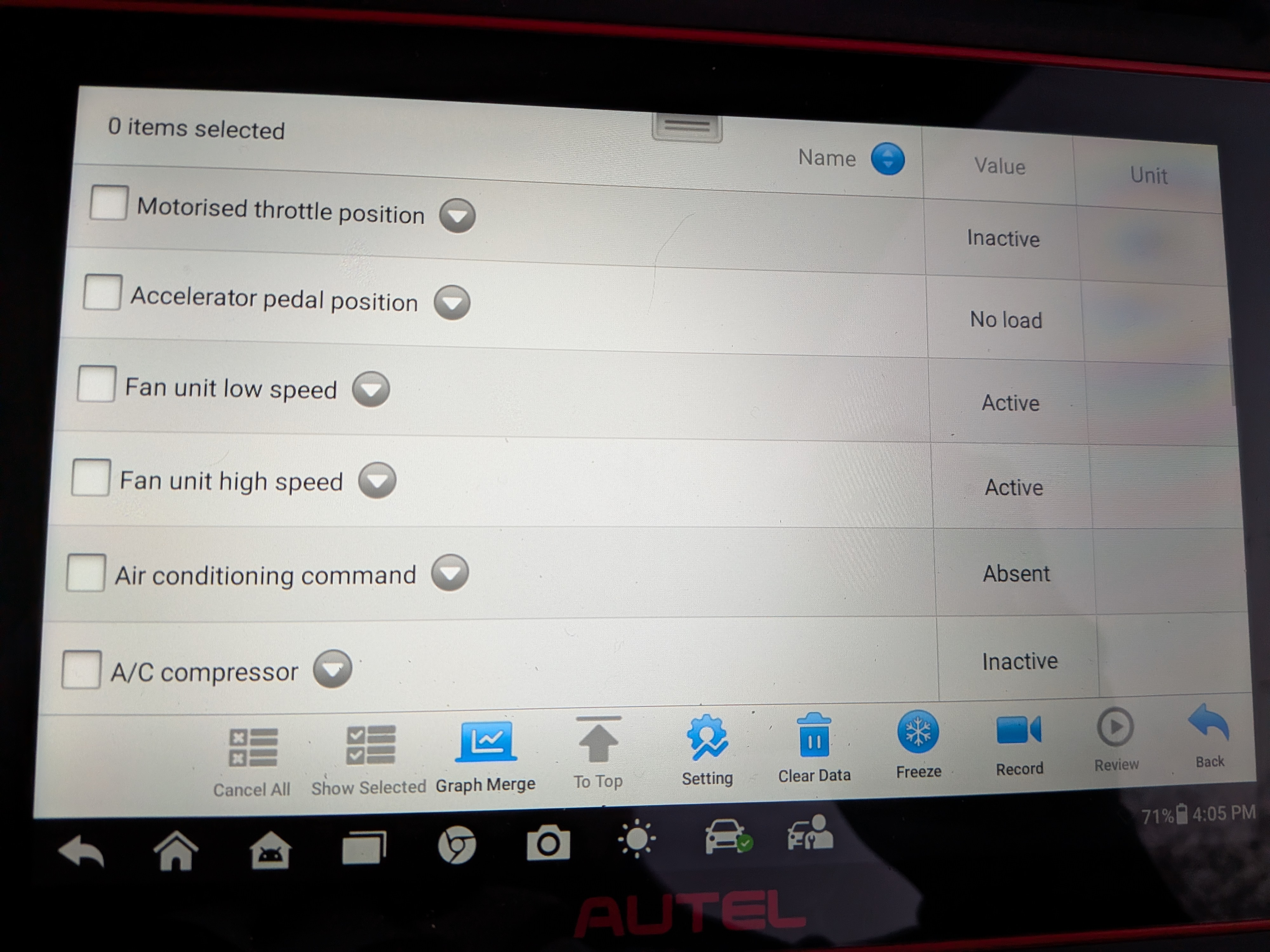

ECU is commanding the 2nd stage fan to be on
And lastly, no fault codes logged!
Yep possibly bad wiring to the plug. On my dci i noticed the wiring was bare to the pressure switch for 20mm or so and corroded to fcuk. Still worked suprisingly, depinned connector and repaired it before issues.
Ac pressure sensor connected? Im sure that also puts fan on full belt.
I bet that's it, the cars had a new radiator at some point and the cheapskate has just removed the condenser and chopped the pipes (I've got replacements of course 😂 ) so there's no gas in the system but I did notice the AC pressure sensor was reading something stupid like 20 bar!
