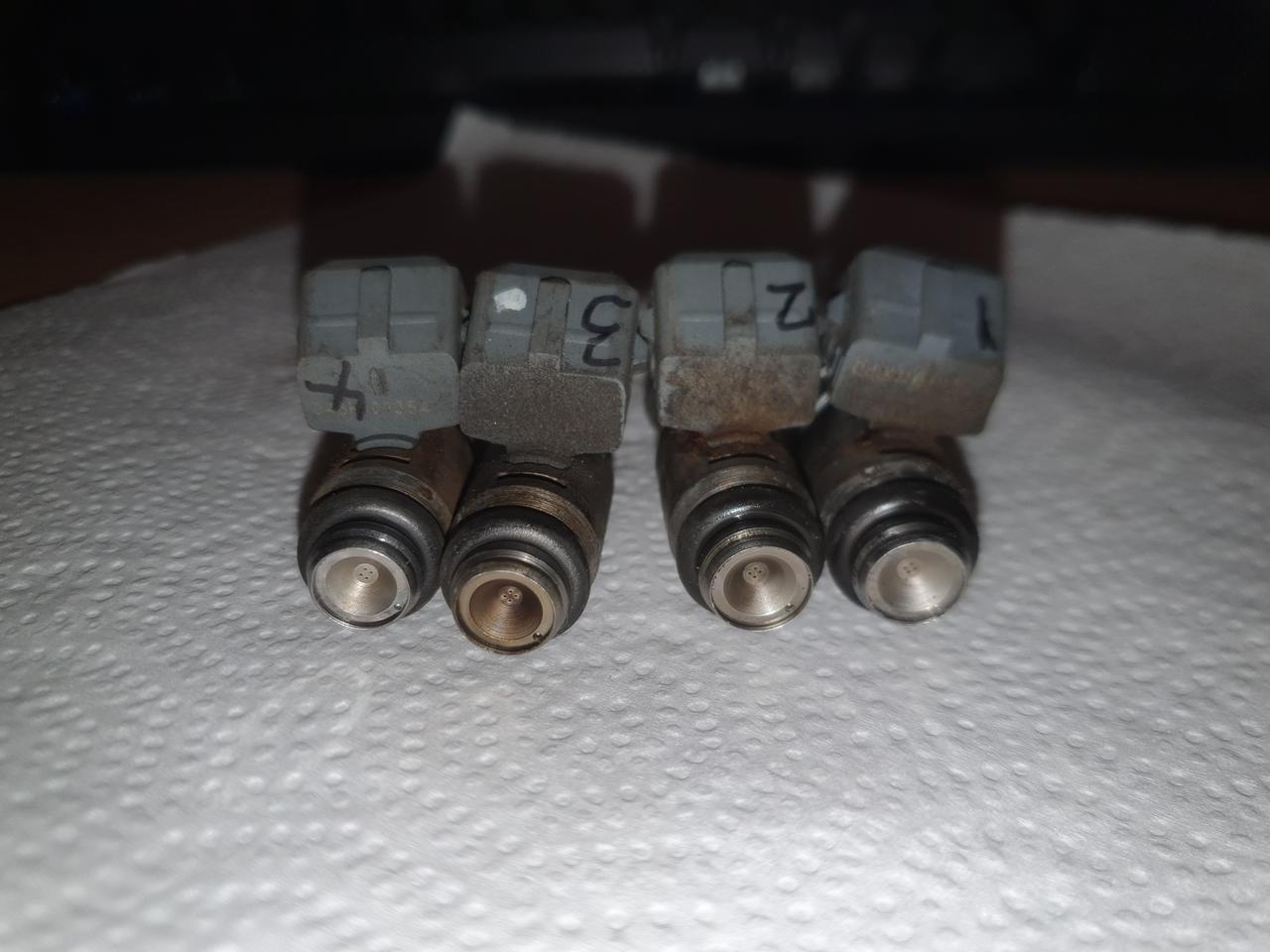

Injectors resistances are 14.0, 14.0, 13.7, 13.6
In May 2019 they were 14.5, 14.7, 14.8, 14.2
So slightly different. Is the resistance not supposed to increase when they are shagged?
So they were shagged at 13.6?
Depends on the temperature as that will affect results.
Resistance: 14.5 Ω at 20 °C (when new)

If the engine is lumpy as f**k then check your injectors first
If you have a decent mate then swap your rail and injectors with theirs, if you know theirs works then you diagnose it's either that/not that and go from there

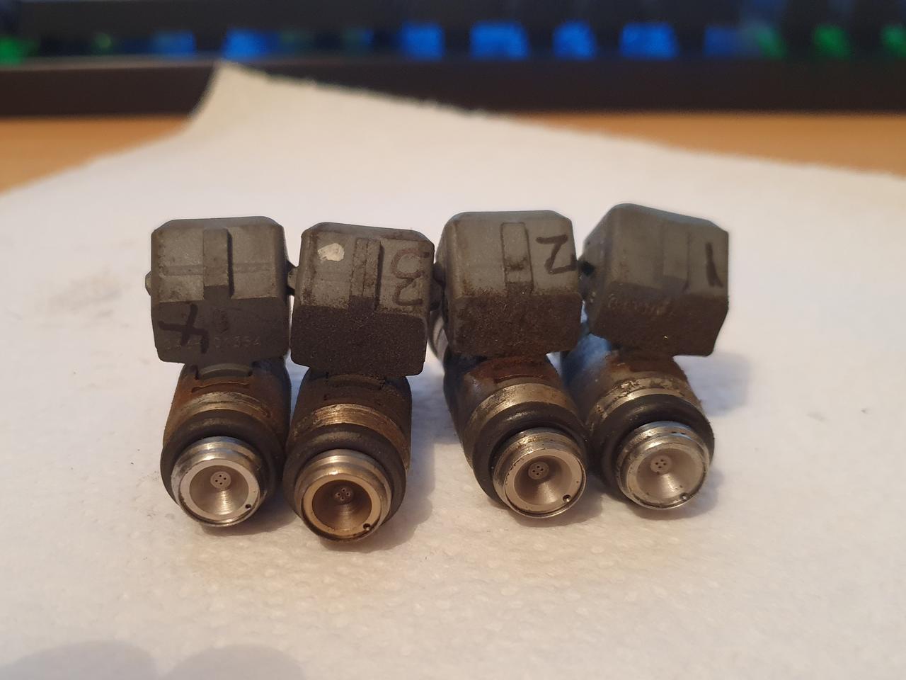

I don't understand this. Number 3 is reading as 3.0 now that it is in the house. It was about the same as the others outside :confused:
I think the colour confirms it hasn't been working correctly, doesn't it?
Might just replace the set to be safe
