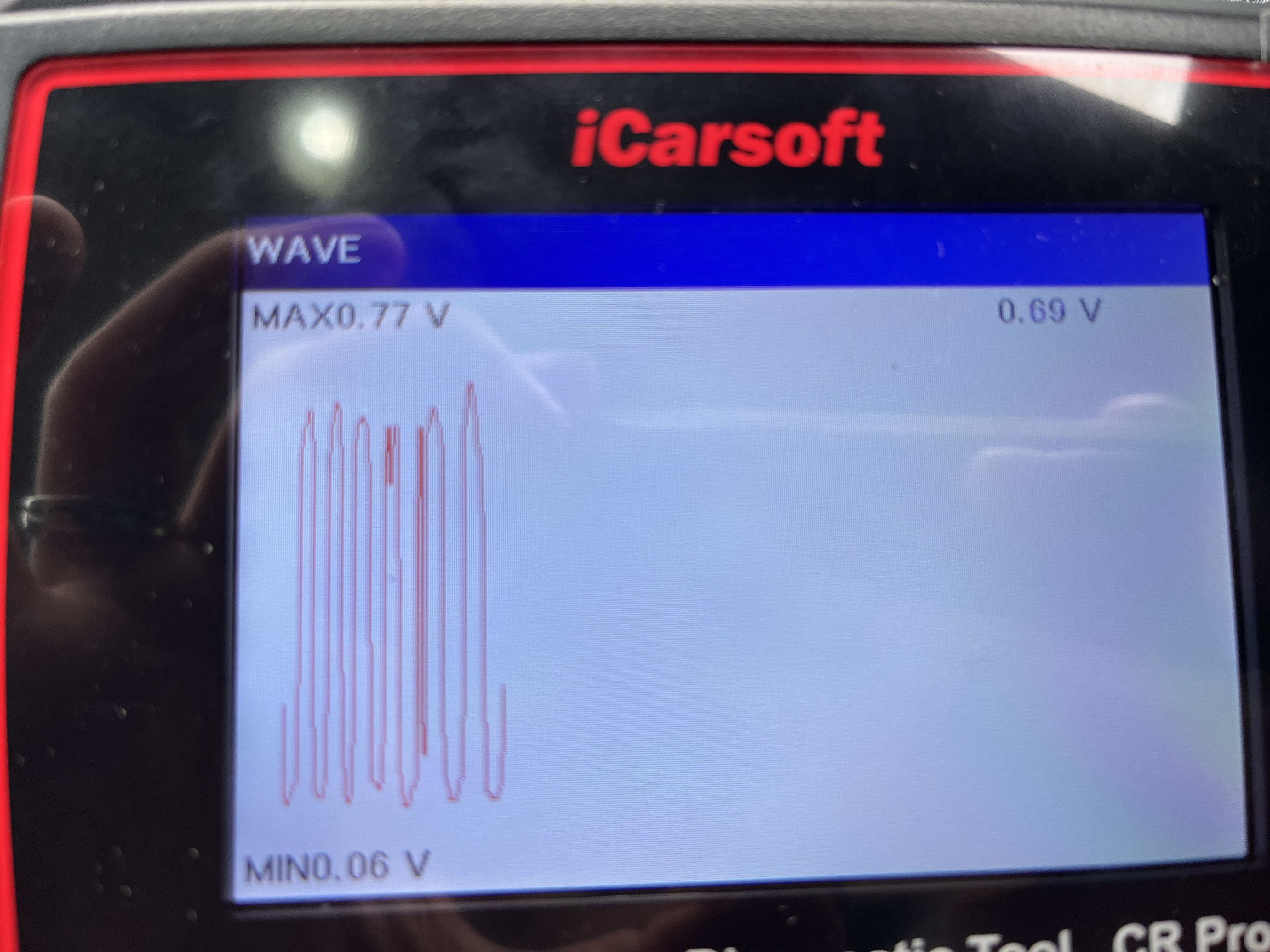

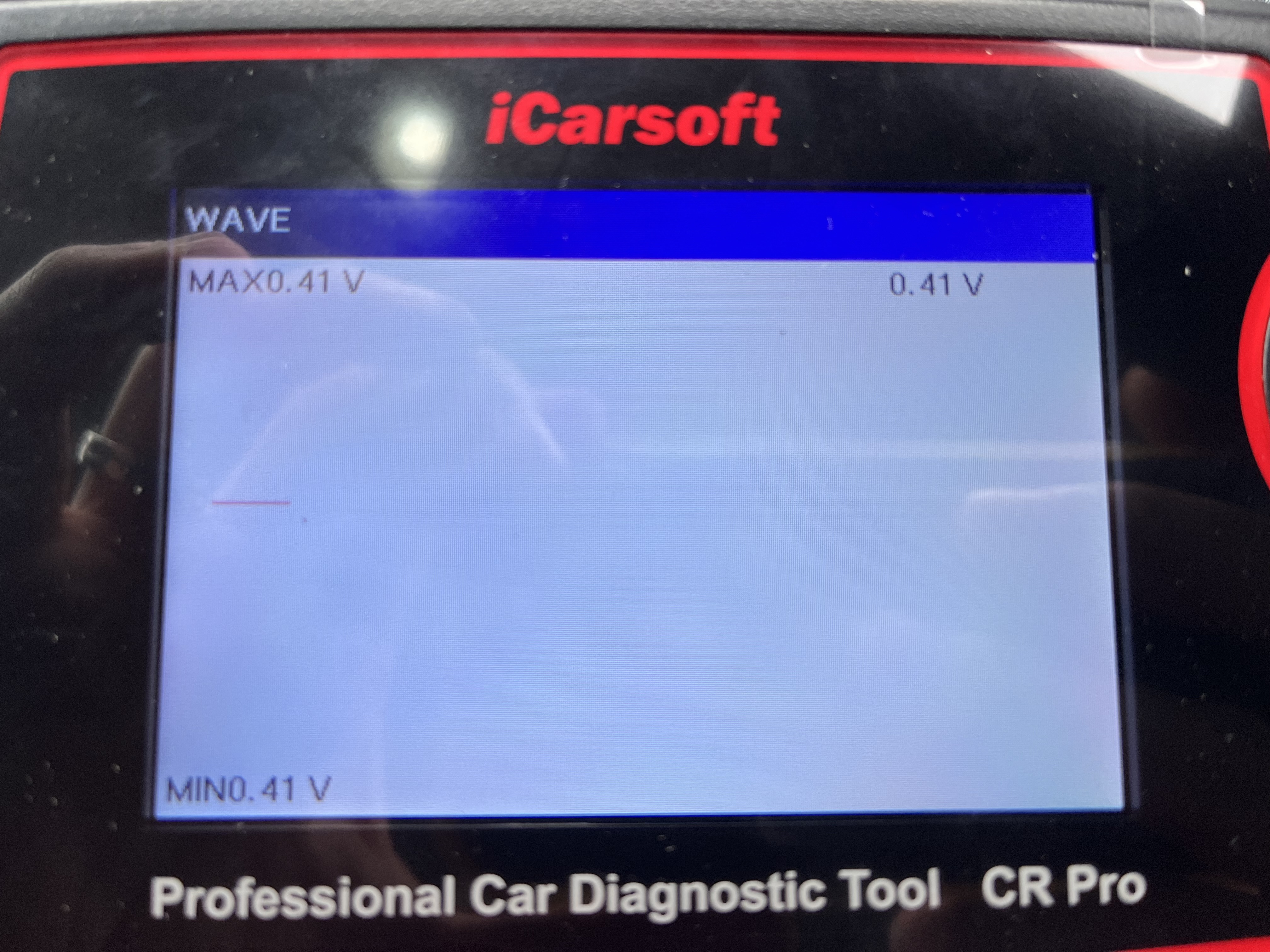

Just been out and checked mine,
This is what I get
So I’m getting static 0.41v downstream and fluctuating on upstream between 0.06v and 0.77v
  Renaultsport Clio 172
I think your upstream sensor is dead. Although it'd be good to see some more data, eh graph data is a bit easier to see what is going on.
Thats really helpful you checking thanks very much mate
I’ve got 0.41v static downstream
And fluctuating 0.740v to 0.09v upstream - which is almost the same as yours isn’t it?

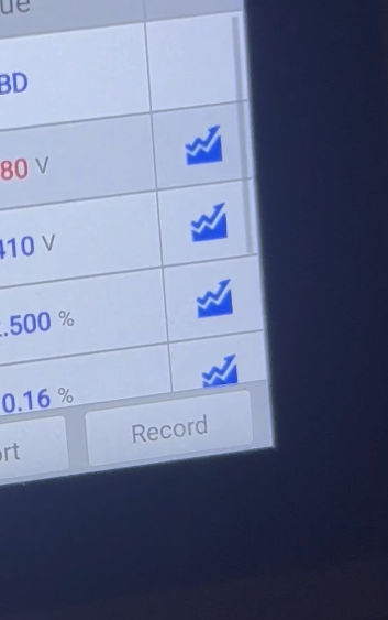

It looks like a Launch scanner.

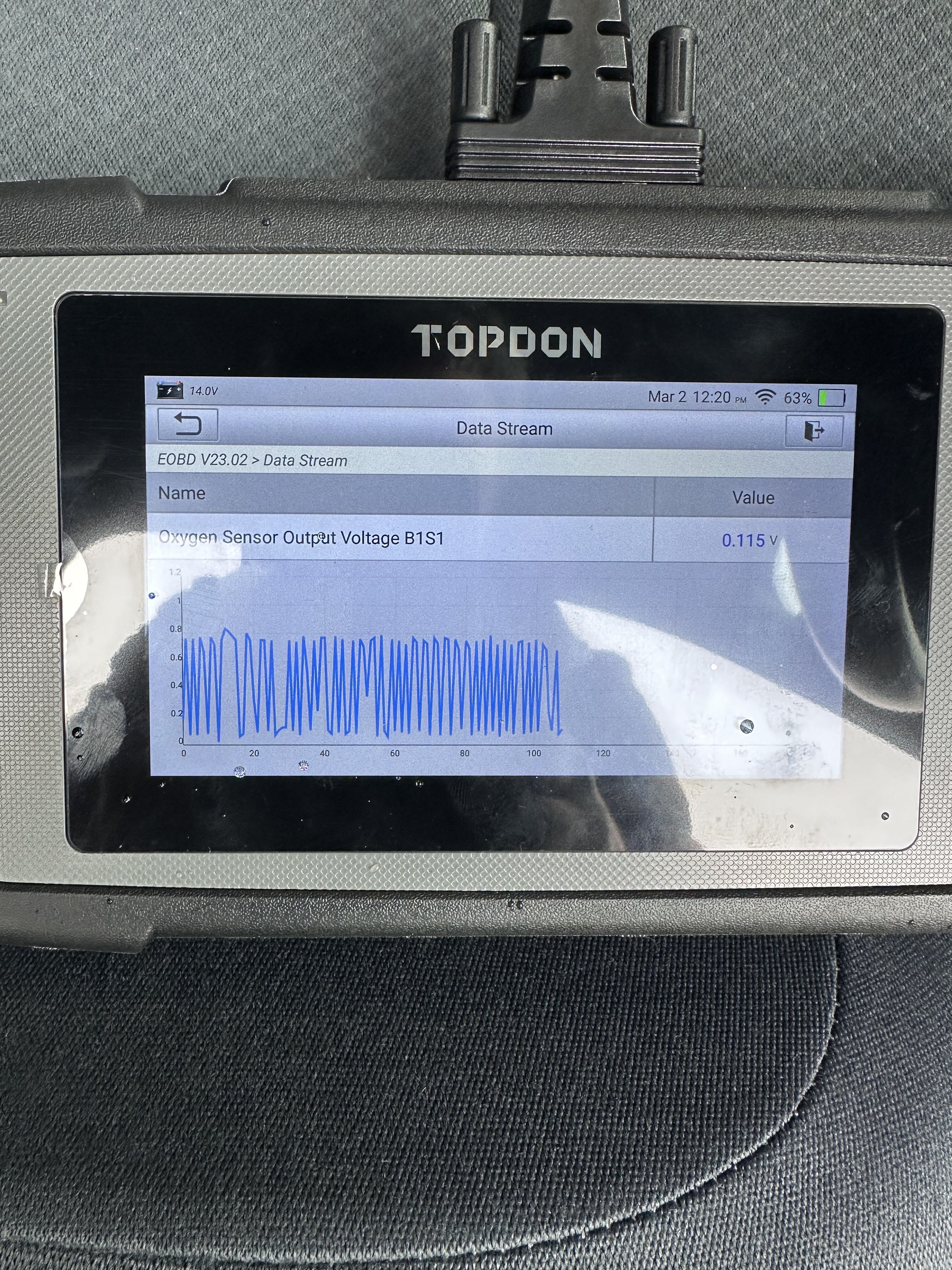

The blue wavy graph looking symbol on the right, if you press that it will show in graph form.
Mine looked like it was switching but on the graph it was super erratic. Worth noting that cheap sensors either don’t work at all or fail quickly, even Bosch ones sometimes only last a few months, it’s a common complaint.
Might not be that but it’s the most common thing for over fuelling so needs to be 100% eliminated.
