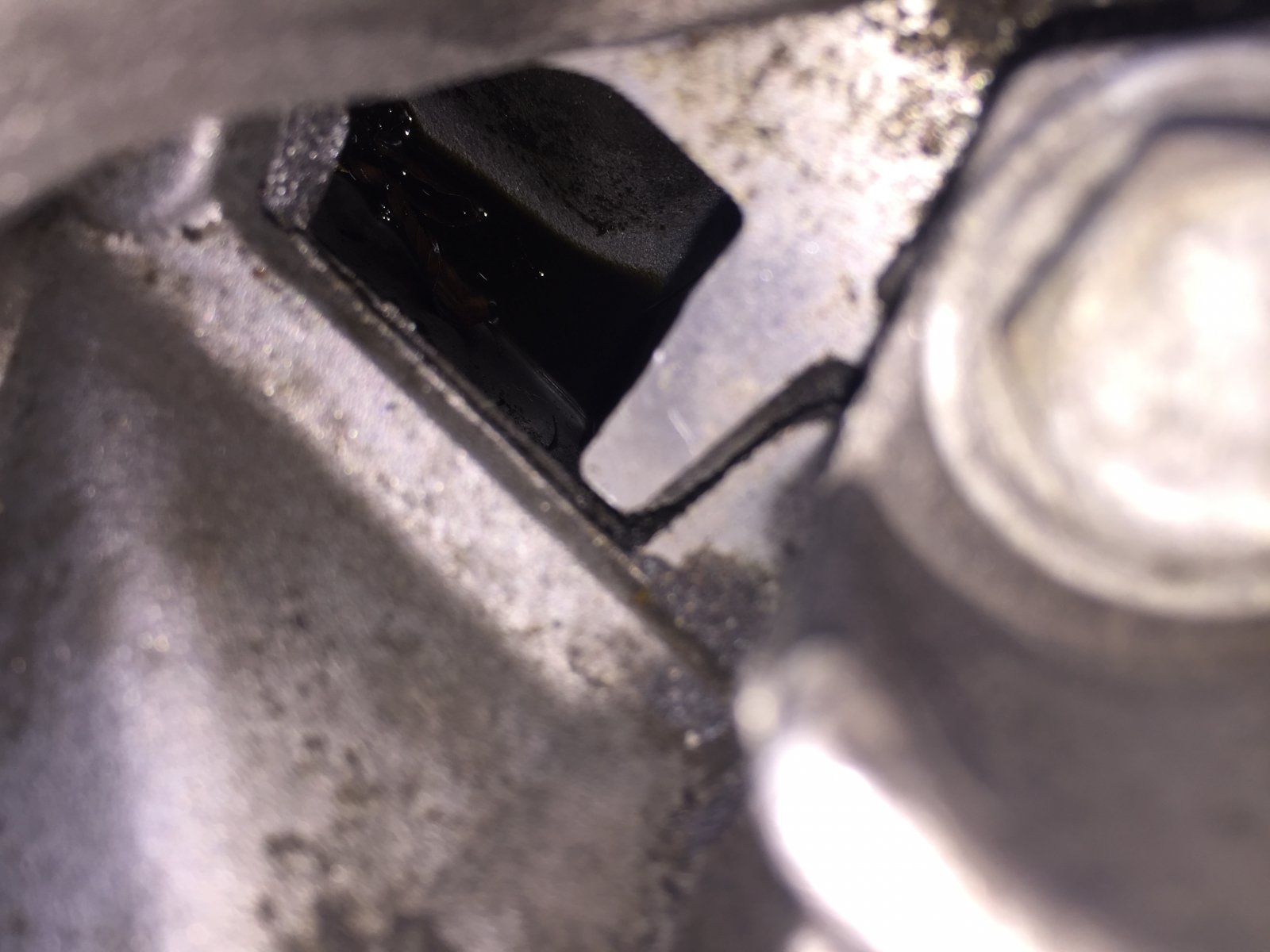

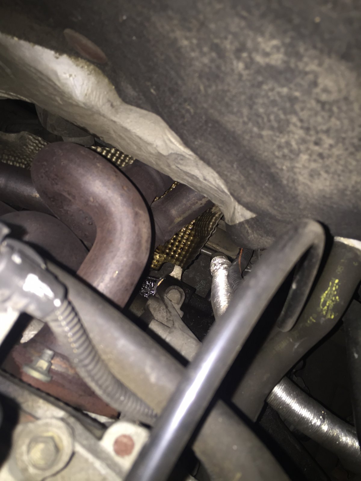

The aux belt still looks to be in place, and the cambelt does (from what I can see). I've also noticed a load of oil in the sump tray and also behind the engine in the heatshield area for the exhaust manifold. I've tried to take a photo but obviously it's really dark and not very detailed.

Just getting one click and the lights going a bit dim whilst you do it would point to the starter motor - Its possible one of the cables has dropped off it. Its behind the engine under the exhaust manifold - look below the middle 2 exhaust ports and see if you can see or feel any loose cables - there is one that is fixed to the starter with a nut which is probably fine , there is one which is just a spade connector which might have come loose. Also the starter motor may be seized.
Dont know why the engine cut out though but may not have anything to do with the oil leaks.

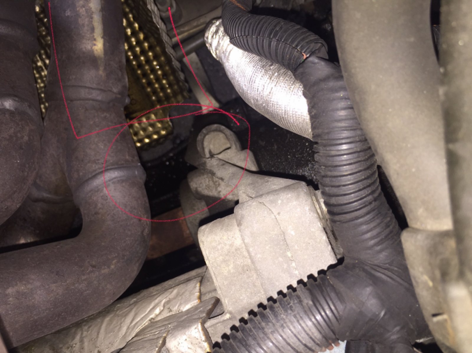

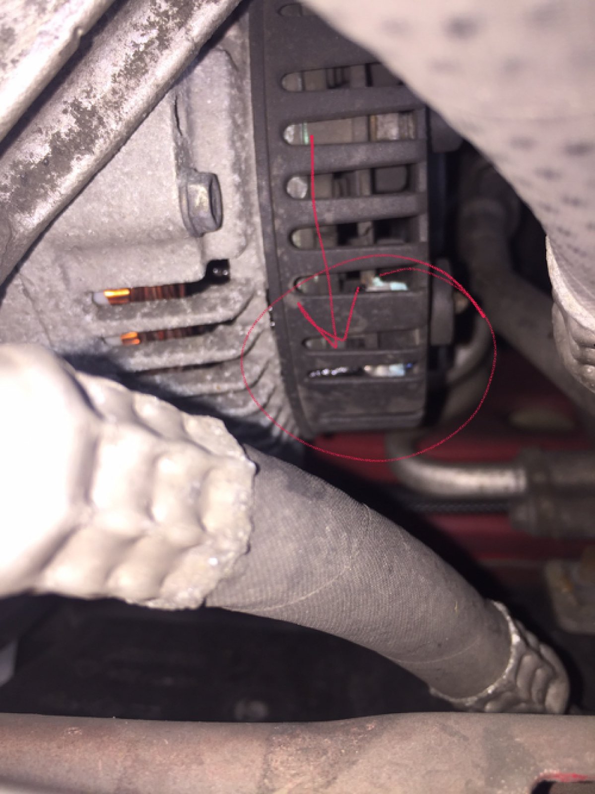

Also, the alternator seems to have a little bit of oil in one small area and I'm not sure if whatever is behind the plastic cover is broken or not. I've attatched a photo to try and show where abouts I mean.
I've had a good look down the back of the engine but I can't even see where the starter motor is! Or should I be looking from underneath the car?

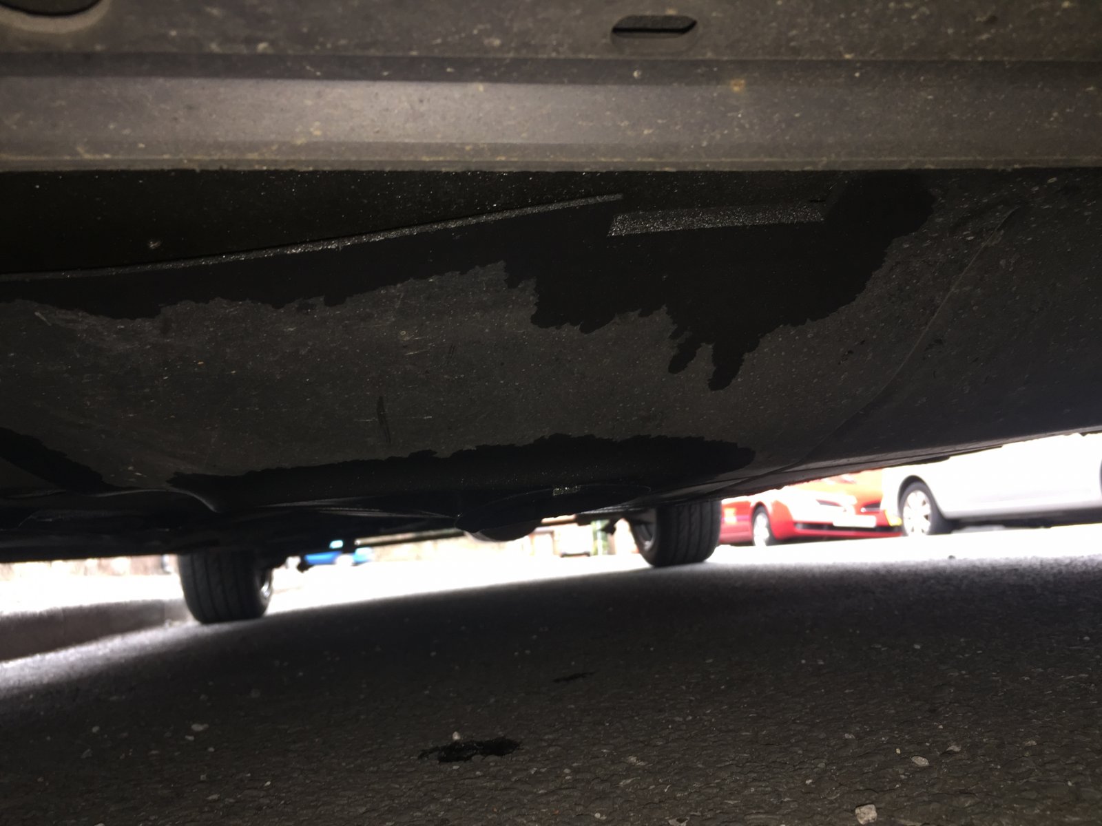

Now it's daylight I have noticed some oil in places it shouldn't be. There is a small drip on the road now I've pushed the car forwards slightly but the undertray definitely doesn't look healthy. The oil level on the computer and the dipstick are both fine though...

Need the engine running to check voltages from the alternator. Could try a jump lead from the negative terminal on the battery to the lifting eye on the engine, that will disprove or prove an earth strap issue.

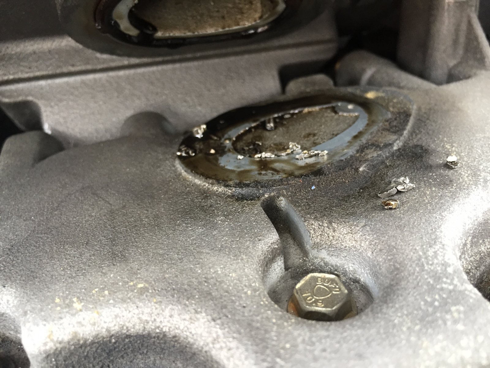

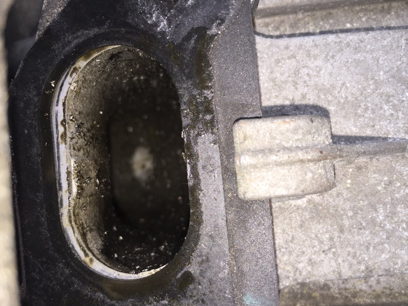

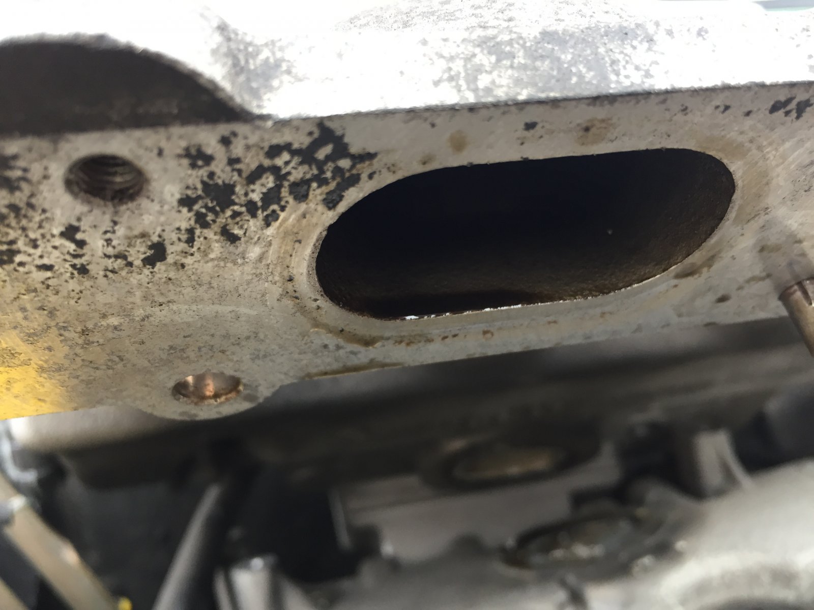

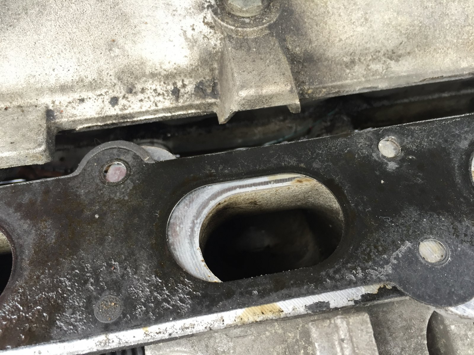

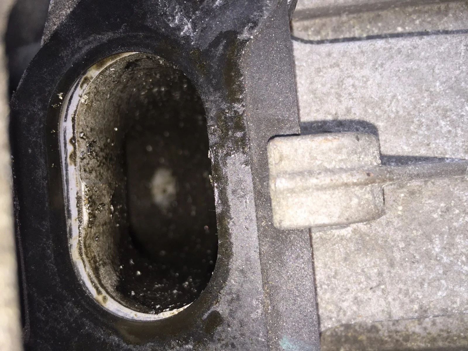

I took the inlets off and noticed there's oil in them. I also noticed a load of smashed up metal bits under the Renaultsport bit, what could that be?
