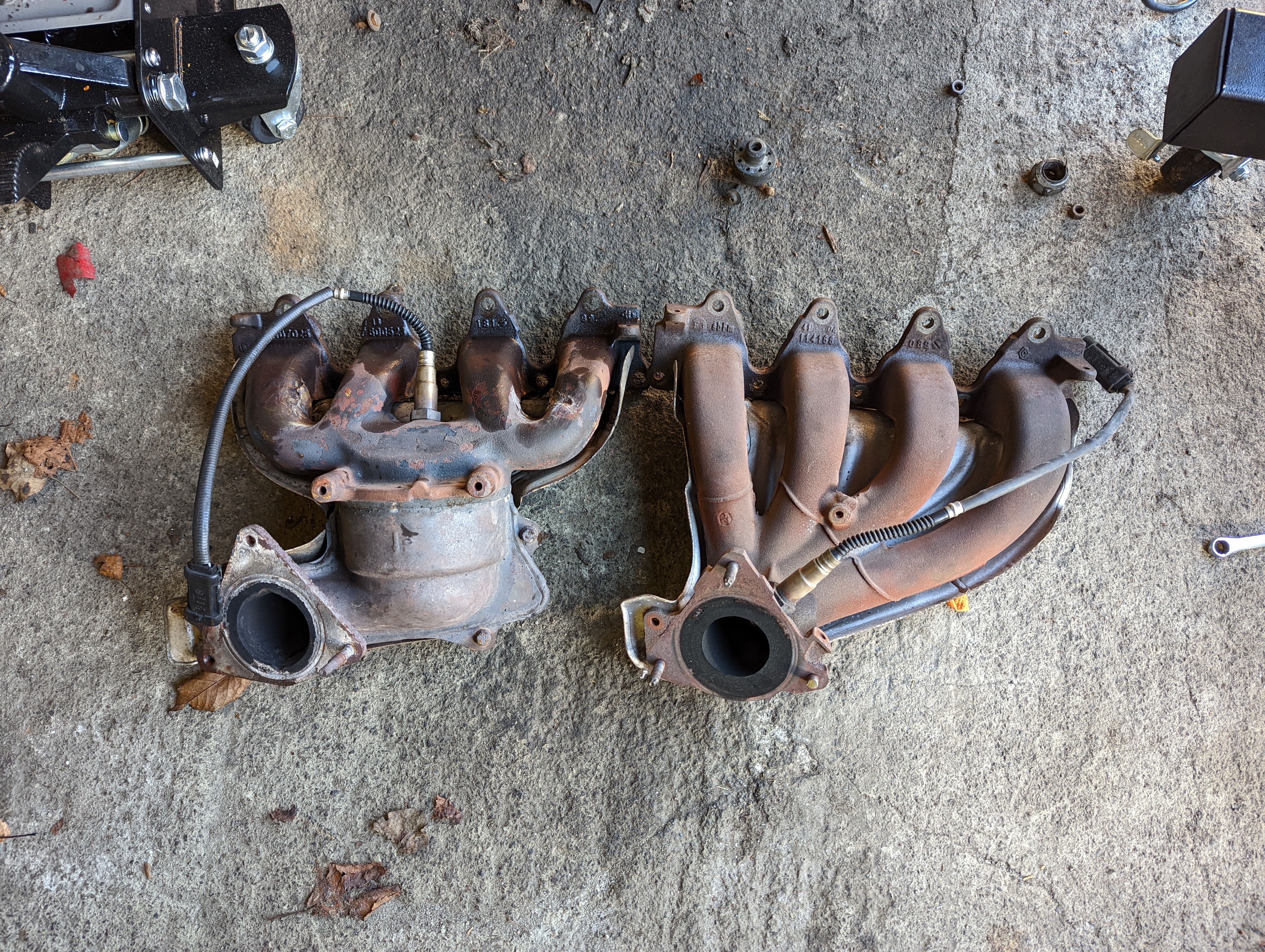

im not sure if its the same over there but in the uk the clio 2 with the K4M had a cat on the manifold, but meganes with the same engine didnt, i swapped over to the megane manifold and it seems to have given it a small power boost!
Wow, looks like a much less restrictie manifold, even before the cat!
