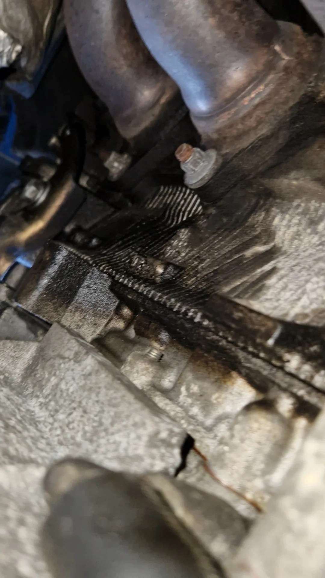

Hmm any ideas what else it could be then? There's some oil on the back of the cam cover but it doesn't look particularly fresh, or anywhere near the quantities that I've been losing. I've gone through about 3 litres in the last 1500 miles 😬

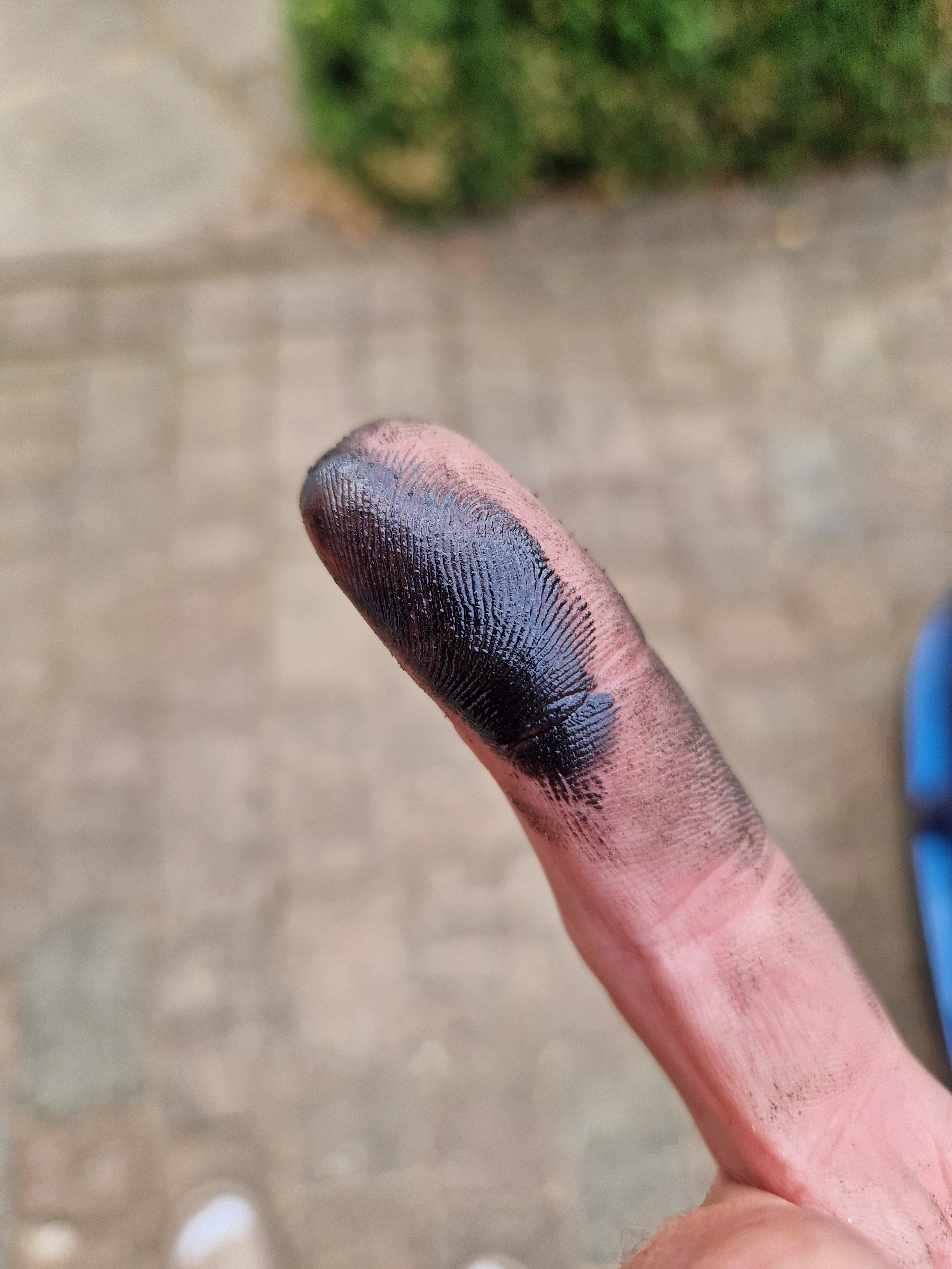

Just stuck my finger behind the butterfly in the throttle body. This seems excessively dirty, or is it normal?

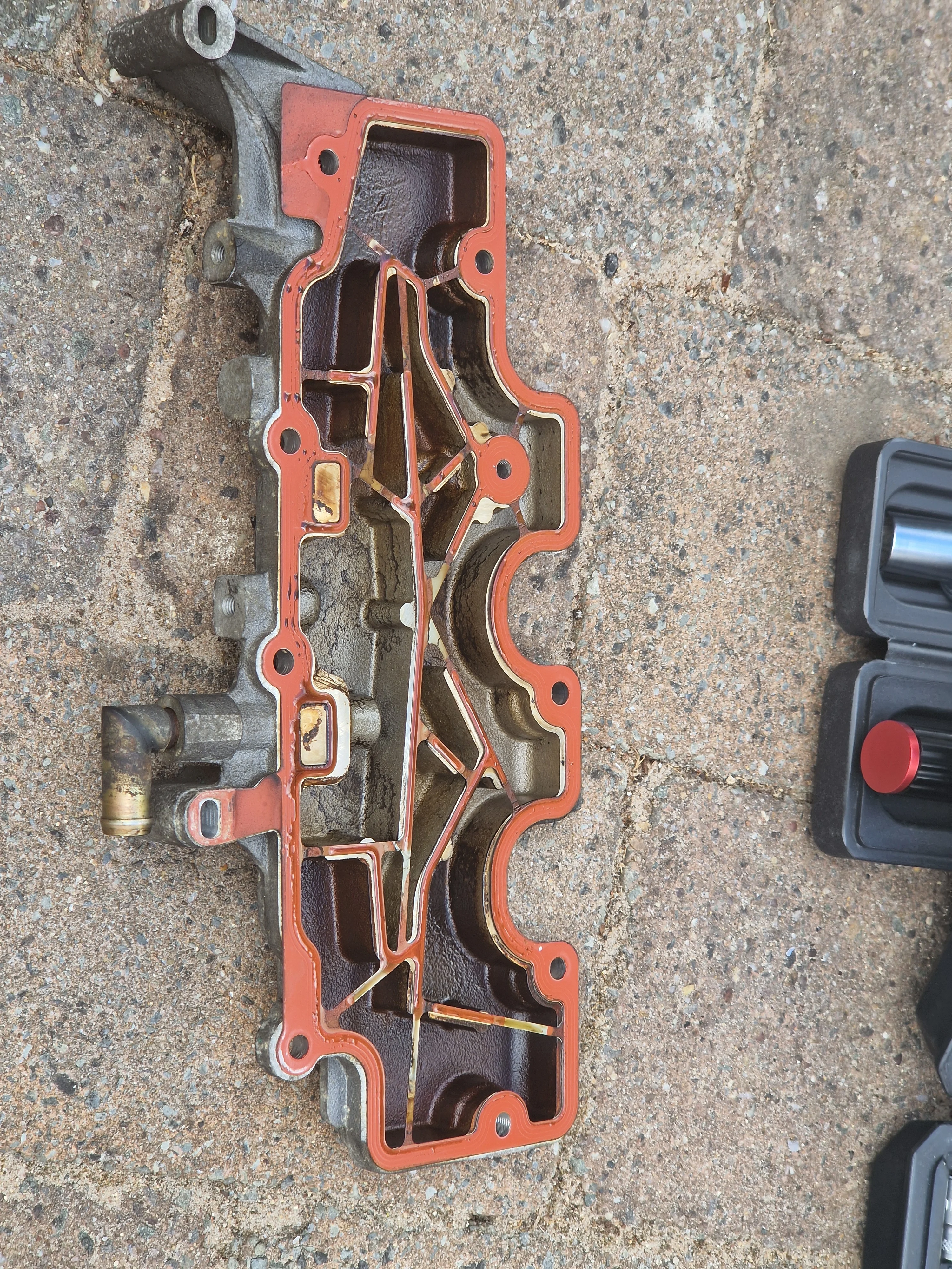

Sealing the rocker bolts with silicone and resealing the breather plate stopped a lot of oil leaking down the back of my engine/manifold. It would only happen when at higher revs for longer periods as your describing BUT that barely registered on the dipstick... nowhere close to 3L in 1500 miles 🤷‍♂️
Get a leak down test done, none of the engine rebuild in a bottle things work.

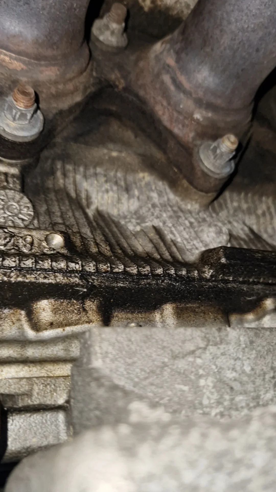

If you've lost 3L in that many miles through a leak your under tray and engine would be covered, that cam cover leak definitely doesn't look bad enough to see a significant drop in level.

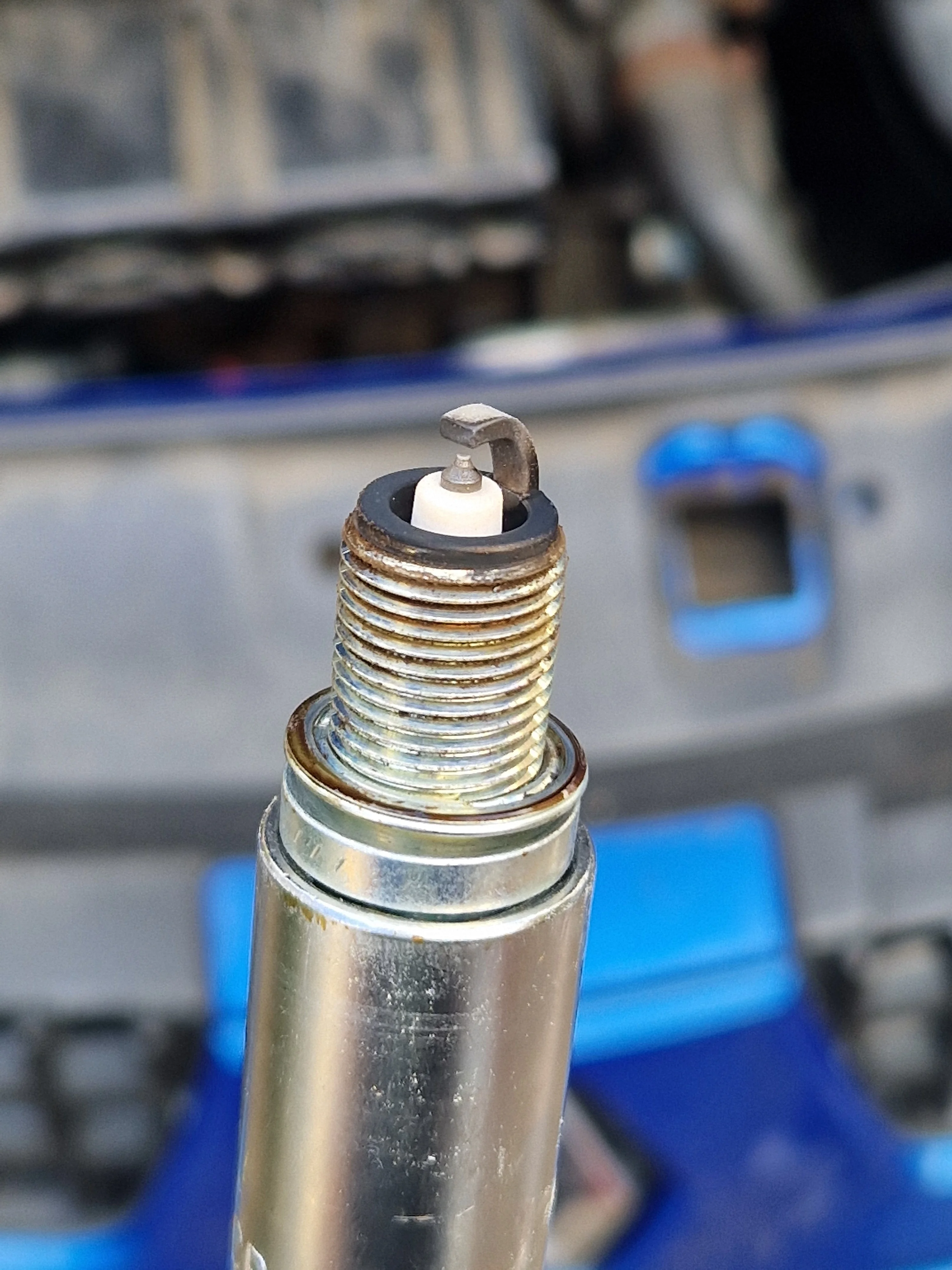

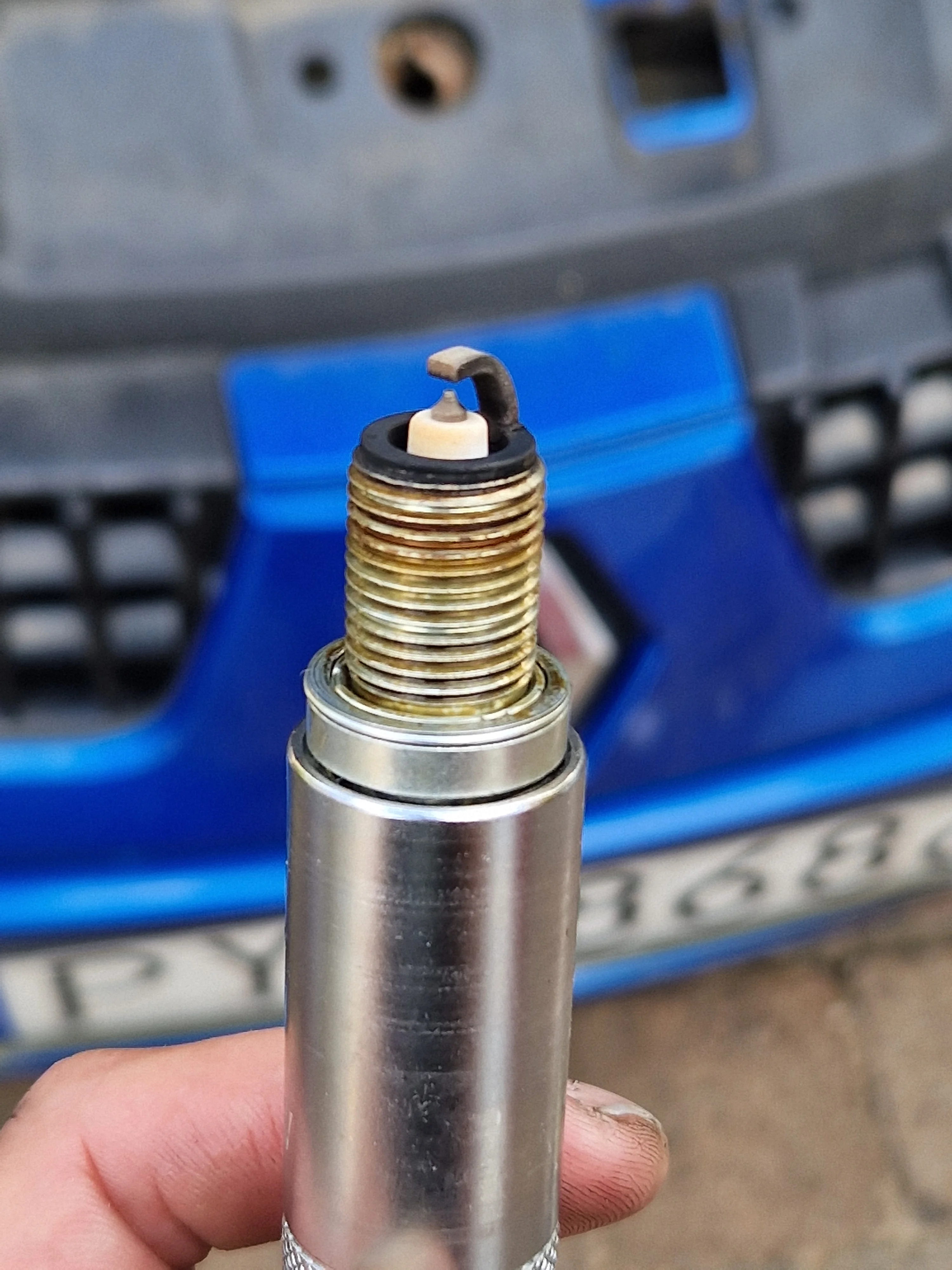

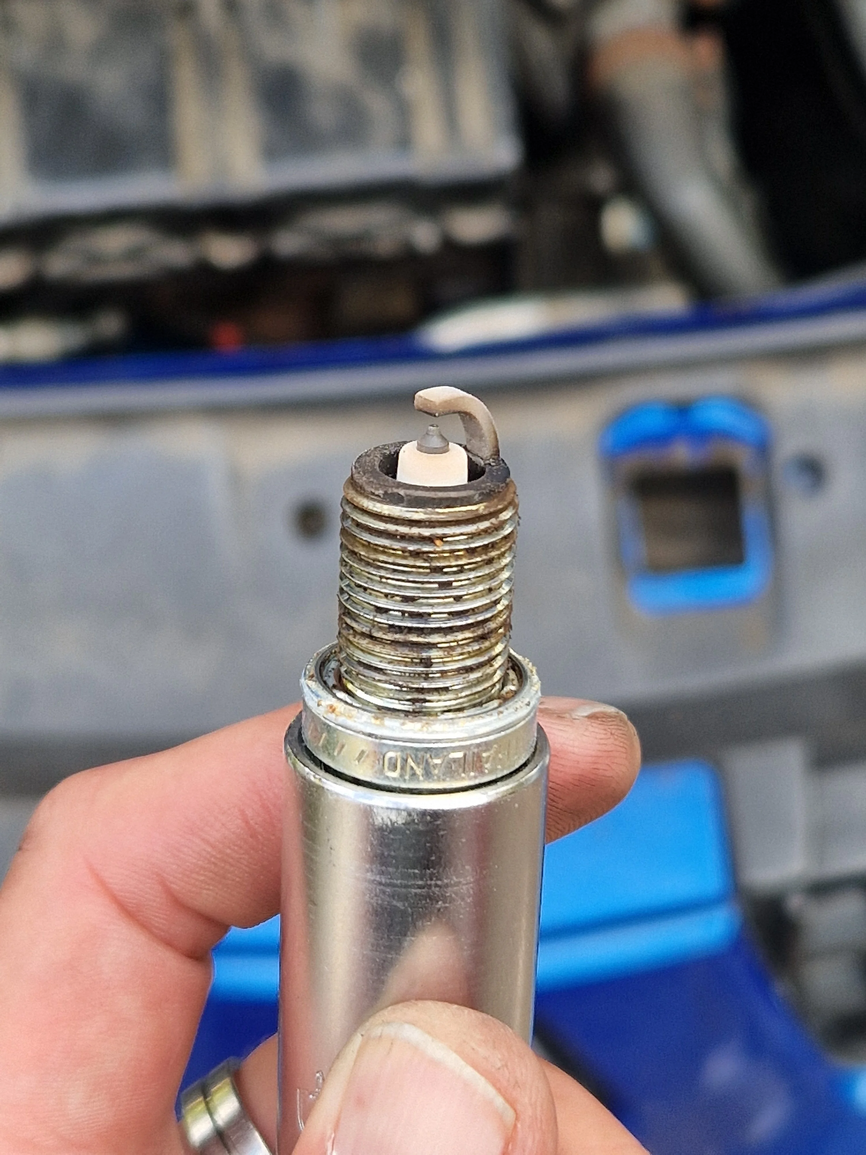

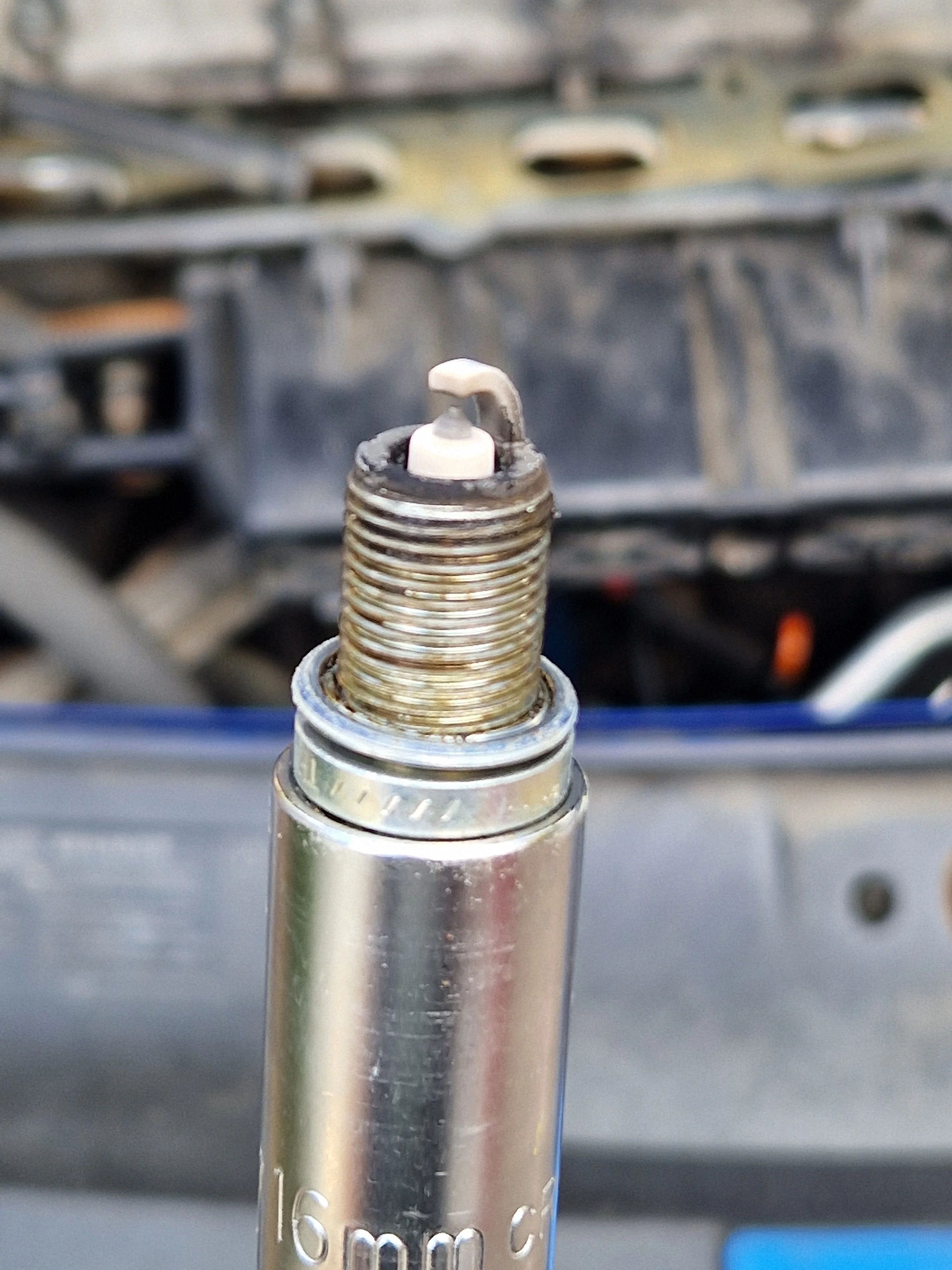

It is hard to see if your own car is a bit smokey from the drivers seat, maybe have someone else follow you driving for a little bit to see if it's chuffing a bit, or rig a GoPro on the back bumper if you've got one, the plugs don't look bad but I'd be more inclined to say it's burning it rather than leaking if the motor is fairly dry
Had a breather plate gasket lying around so I changed it just in case. I don't think it will make any difference but it can't hurt 🤷🏻
Old one seems fine to my eyes, but I have no idea what I'm supposed to be looking for 🤣

3l of oil in 1500 miles? Are you sure? It’d be smoking its tits off or everything would be drenched on the underside. The plugs don’t look horrific to me.
