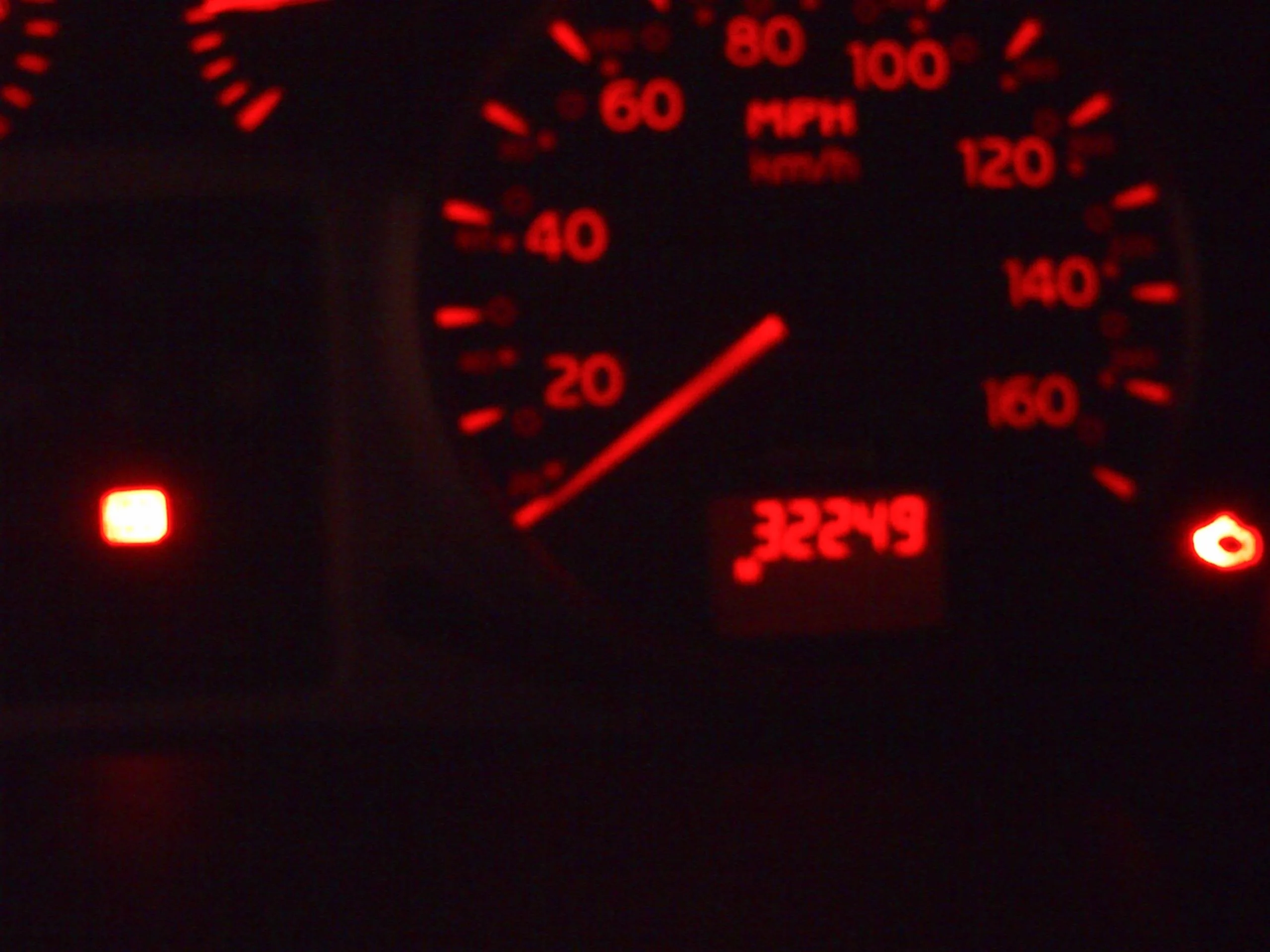

On way home from work and orange light (in middle of dash, see pic) came on then the engine managment light ( to the right below where the seatbelt warning light is, see pic) Limited performance, wont go above 3000rpm.
Any idea's what it could be?
Cheers

The 3k Rev Limit is in Limp Home Mode.
ENG MGMT covers a whole host of items, plug in required for code, if you d not have access but are in AA etc and are prepared to wait, phone them tell thm it is very lumpy and wont drive, they will then put Dioygys on FOC as part of membership, tell you the fault and then if it is not active re set,
  3 Series xdrive
Local garage just done diagnostics and found 4 faults, he said it was relating to the throttle pedal, cleared all the faults and all is fine for now, said it could come on again anytime though and quoted £300+ for new throttle pedal/senser etc.....
