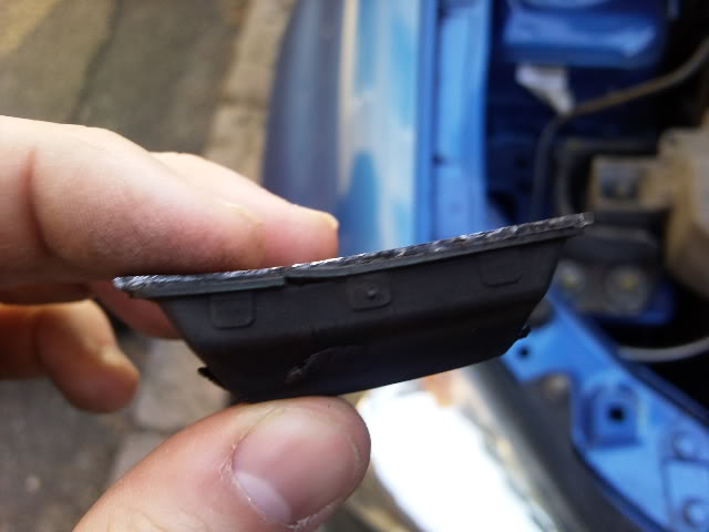

Driving home this afternoon, very load rattling and knocking suddenly started.

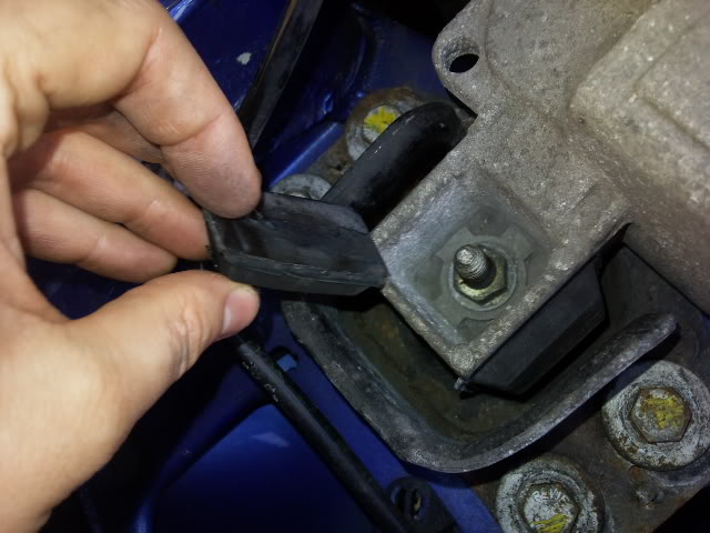

Managed to pull over and gave car a good check. It sounded like i had snapped something on the suspension, but nothing so popped the bonnet and found the noise was coming from the engine mount.
I just guessed it had come loose so slowly drove home, bout 1 mile. Got home and found this;
It was rattling around engine mount area, think i was very luck it didn't make its way to the aux belt and do some serious damage :eek:

it's just a buffer and is on a bracket, but you don't seem able to buy this bracket seperately (it comes with a new mount). should be fine to drive i'd have thought

Its the bracket that has snapped, can't work out how. The way it sits on the mount and the way the force acts on it doesn't seem to add up to that part snapping!!
