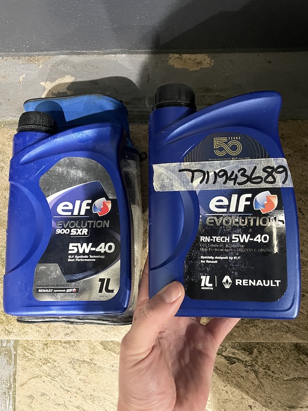

Was looking for some 1L top up bottles and spoke to my Renault parts guy.
He said he had two bottles that had been on the shelve for months and I could get them at a good price.
I collected tonight and from what I see they are different and i'm a little unsure and hoping someone can shed some light on it for me.
All the oil I used was ELF and it was the following -
ELF Evolution 900 SXR 5W 40 RN710.
The two 1L bottles I received tonight are -
ELF Evolution RN TECH 5W 40 RN700 / RN710.
Now are these different oils and are they for different engines or can I use the RN TECH as its a RN710 which is what the Clio sports take & use.
MarcB
  Too Many
Perfect. . . . . I was just going to bin it as was so unsure.
I have 15L (3 x 5L) of the Castrol GTX RN SPEC 5w40 RN710 but don't have any top up packs.
Im guessing along as its a 5W 40 RN710 it should be good to use and mix.
gez 172
  Defender 110
One will have superseded the other that’s all. It’s all the same specs
