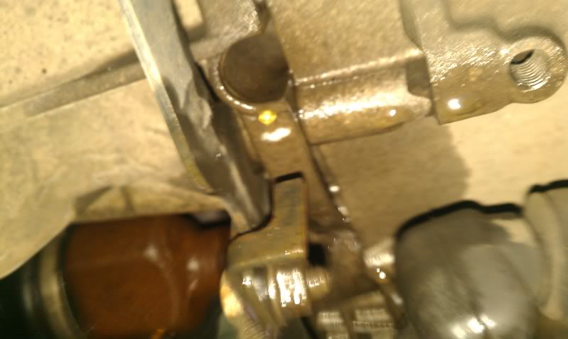

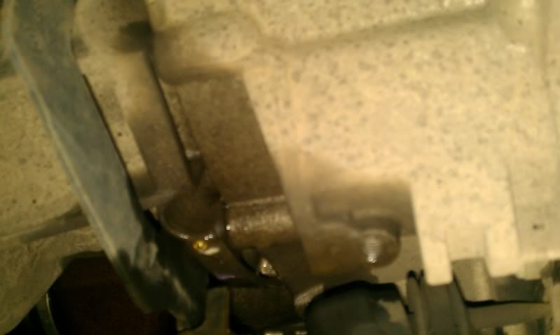

Hi guys, my missus has a 53 plate 1.2 Dynamique, she was otw home last night as it overheated and the stop light came on, AA came out and immediatly said it was the headgasket.
I filled up the water this morning and checked the oil (was lowish) and ran it for about 15 minutes, temp didn't get above halfway but there was a little bit of smoke/steam loitering between the front of the block and the radiator but didn't smell bad.
Every once in a while water would drip underneath but seemed to be oil free.
Is there a chance it could just be a dead water pump or potentially that and the HG failed as a result?

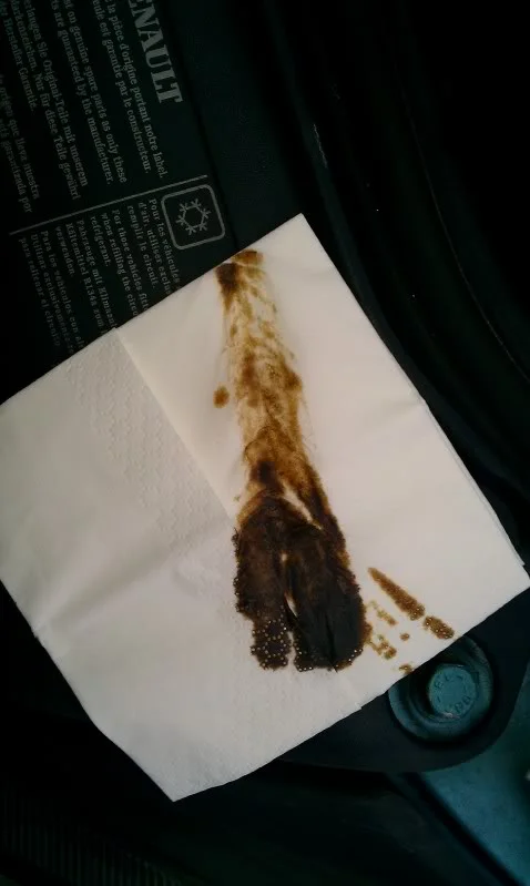

From the dipstick

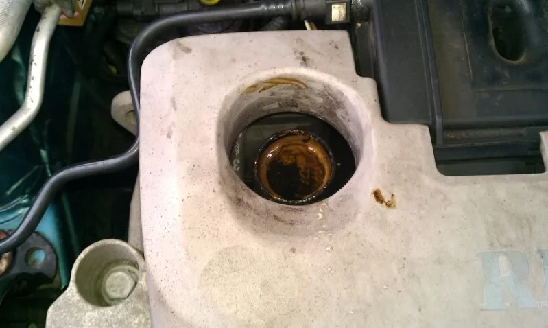

Providing the cars not overheated badly, you probally will just need to fix the water leak. All the 1.2's have that condensation underneath the oill filler cap.

Not that much they don't, looking like possible hgf tbh. Can you see where the water is leaking from?
No i can't, doesn't seem to be from the block itself abut cannot see all of it, the water dripping is just water, have tasted it ;)
Haven't seen that much mayo under the cap in the past plus she doesn;t do any short trips atall, usually atleast 10 miles + at a time.

Tried getting the oil level again and the oil isn't just at the bottom of the dipstick it';s smeared all up it even after a wipe so makes me think it's gettng thinned down by some water.

Waters not leaking from the thermostat housing is it? On the right hand side of the engine, black thing that connects to the block.
Not that i can see, will have a good look tomorrow afternoon when i get in from work and have a look at the thermostat itself
