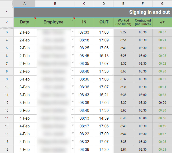

I have a time sheet that shows each member of staff clocking in, clocking out, their contracted working ours (pulls from a separate sheet using VLOOKUP) and the plus/minus time if they work over/leave early.
What I need is, a way to add up each member of staff's extra time. The staff names aren't pre populated, they sign in as they arrive. So, it would need to look for all 'John Smith's and count their extra hours cell.
I know there's an easy function, but I'm stuck.
I think a SumIf formula is what you're needing. You'll want to sum the values in column G where column B contains "John Smith".
