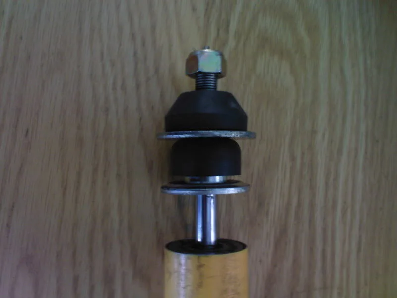

How did you fit your rear shocks?
Did you use the standard renault dustcover and bumpstops that came off the original shocks and what rubber/washers did you use in the top mounts?
This is what I have and i dont know what order the rubbers/washers go in?!? :(

Top rubber needs turning upside down and the bottom washer putting on it as it is.
The other rubber as it is with the flat washer under it. I do remember debating this myself as the instructions supplied are pants.
The other rubber and flat washer I cannot see on the car. I do remember debating this myself as the instructions supplied are pants.
Have you got instructions? If you have could you photograph them or something and post them up?
Also can you take a photo of the top strut inside the boot so i can see what you mean about the rubber and washers? Where does the bottom washer go?

The picture you have posted, is that the way u have been trying to fit the washers and rubber etc?
Or did u just put them on the shocks at random to take the pic?
Nah thats just random when i put them together for the pic.
Chris has helped me out so i know how they go now. Just need to get the tools lol. Should be borrowing some this weekend.

Yup to both, the only visual difference is the piston rod is thicker on the Konis :S:S
Yeh thats the same for me. So you need the rubber bits like i have instead of renault stuff.

Mine are the FK Highsports so being a slightly thinner piston rod, does this mean I can use the original Renault parts?
  ITB'd MK1
I've fitted used ones that have come without the rubbers by drilling out the renault bushes by I think 2mm (please measure first, I dont remember) There's also an insert on the originals that you have to leave out
