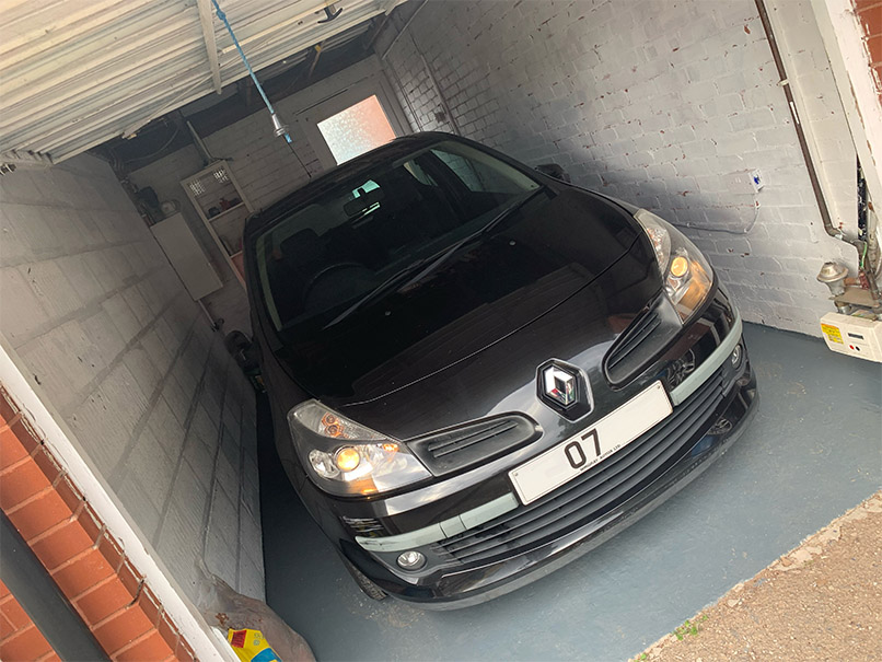

Been a good few years since I've been active but like most, I have come back to Renault and have recently purchased a Renault Clio 2007 1.4 with 90k on the clock - Body is in good condition.

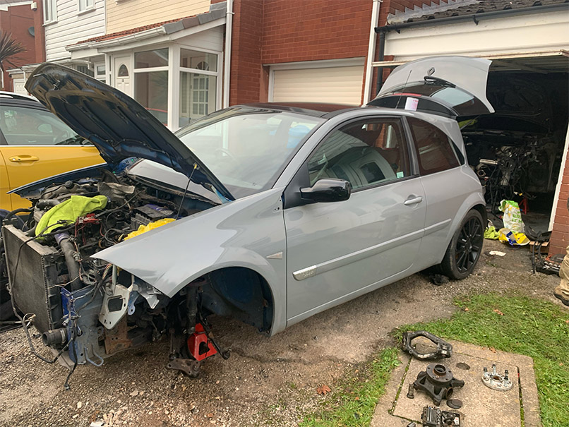

More importantly, I have also purchased a 2005 Renault Megane 225 which is going to be used as a donor car for a hybrid Meglio.
The Engine including gearbox has been removed from the Clio, (Currently looking for a buyer if not will go as scrap).
Started to dismantle the Megane and have removed the driveshafts, suspension, hub & brakes.

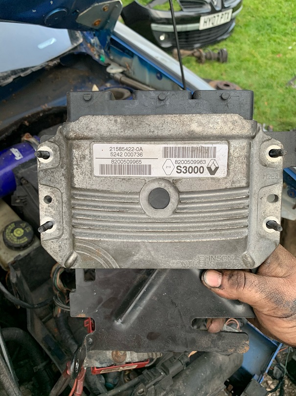

ECU below is no good I believe as its from the 225 nor R26?
